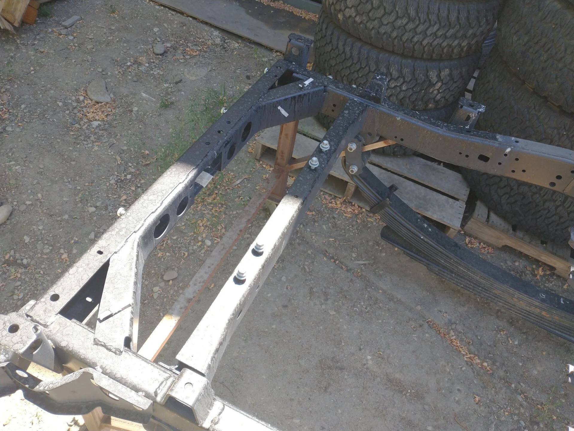

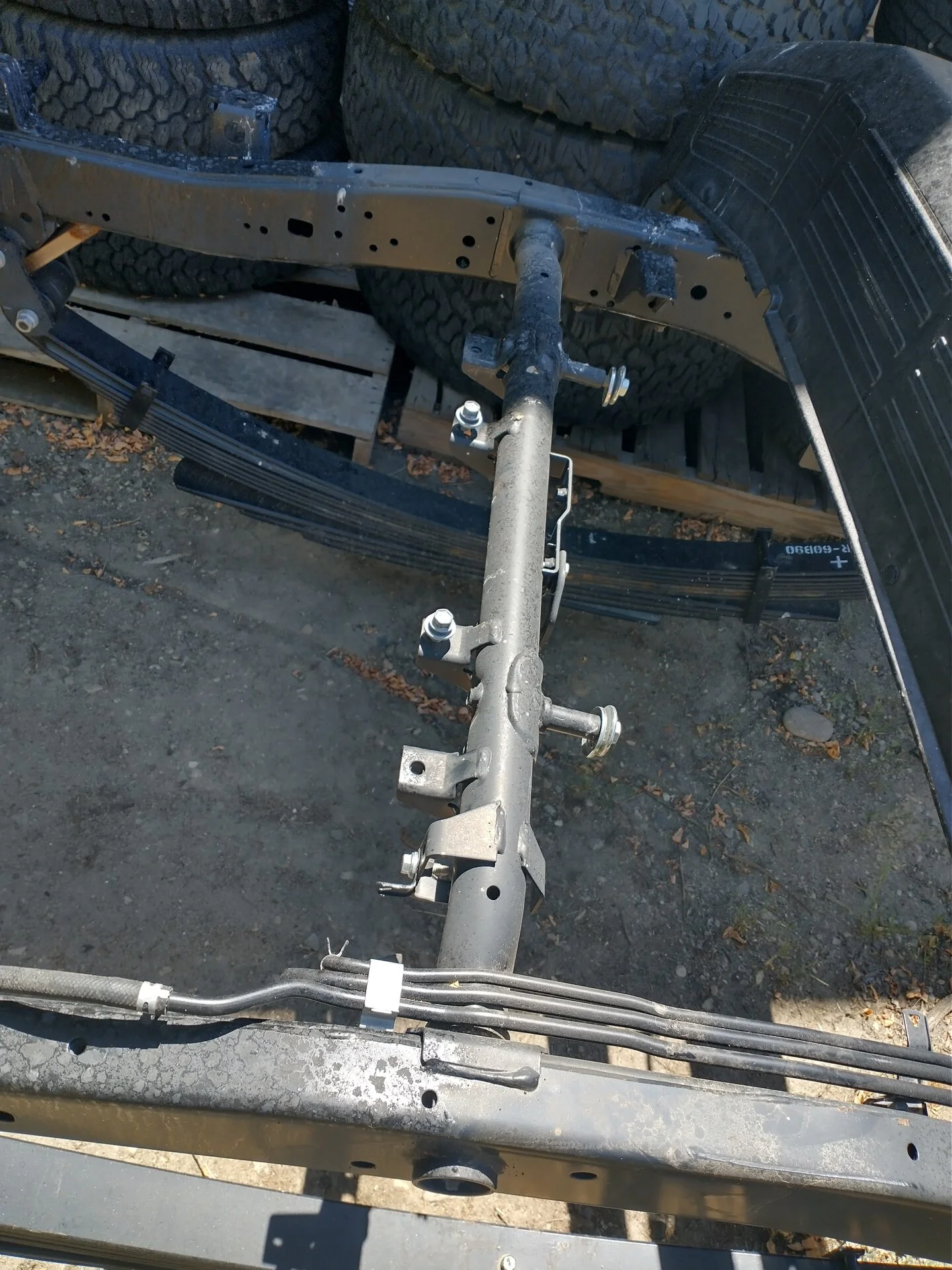

If you go stock, like Rick suggested, you may also need the rear crossmember and mounts. My troopy had the rear tire mounted underneath originally and does not have the mounts for an aux tank.
Snapped these photos a few years ago at a local cruiser shop. I believe this is a later model 79 frame. The rectangular cross piece is the rear support and the backside of the round one has the front support tabs opposite the shock mounts.
Snapped these photos a few years ago at a local cruiser shop. I believe this is a later model 79 frame. The rectangular cross piece it the rear support and the backside of the round one has the front support tabs opposite the shock mounts.
Mine had the underside tire as well. Regardless of which way i go I'll be fabbing up some mounting point. Thanks for the pictures.

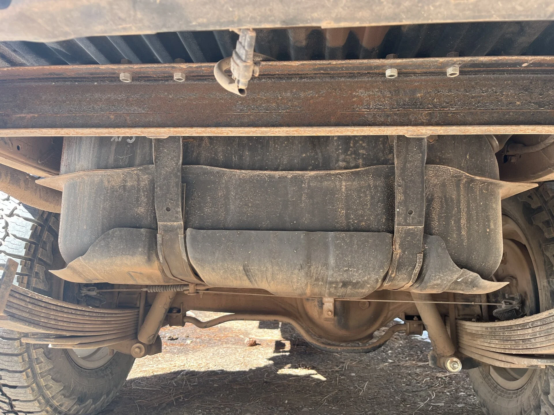

I had a spare tire style frame. Welded in a C channel for rear and could use the mounts on the shock tube to use factory arms.
This was pick up frame but can be done.
I ordered the arms and was given a rear tank and skid plate. Needed the fuel pick up and filler neck (i had a bed w neck provision). Still cost a few dollars to get all together. IF cruiserparts has a good take off tank the sub $400 is a good deal for tank, skid plate, mount arms etc.
To be honest I think I'd like something with a lower profile I think... I don't NEED all of that extra volume (?). I'll have to stew on that for a while. Thanks for the picture.
