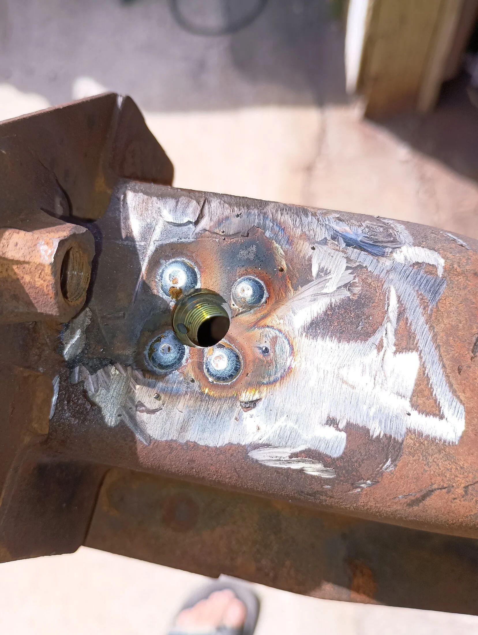

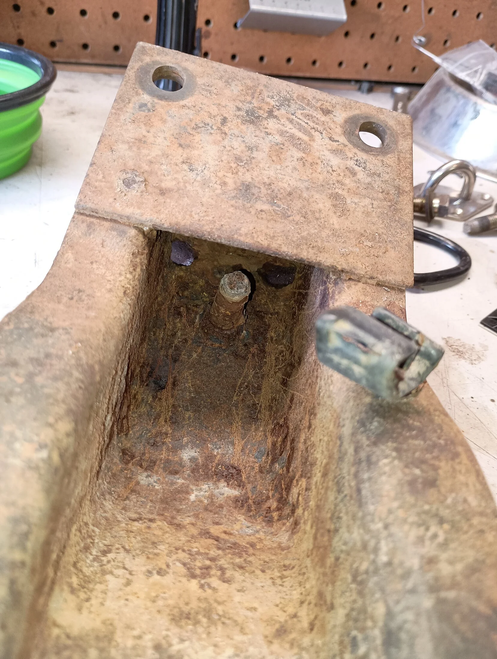

I also got the cross members that support the tank. They needed cleaned up a bit as there had been some modifications done prior to me acquiring them. One bolt was rusted in place and I had to cut it out then weld in a new weld nut.
Rear cross member from the donor frame.
Took me a minute to figure out that those 'L' brackets were part of the modifications that were done to the tank support by the South American P.O.
I cut them off. Also had to cut out the factory spare tire carrier from my truck.
