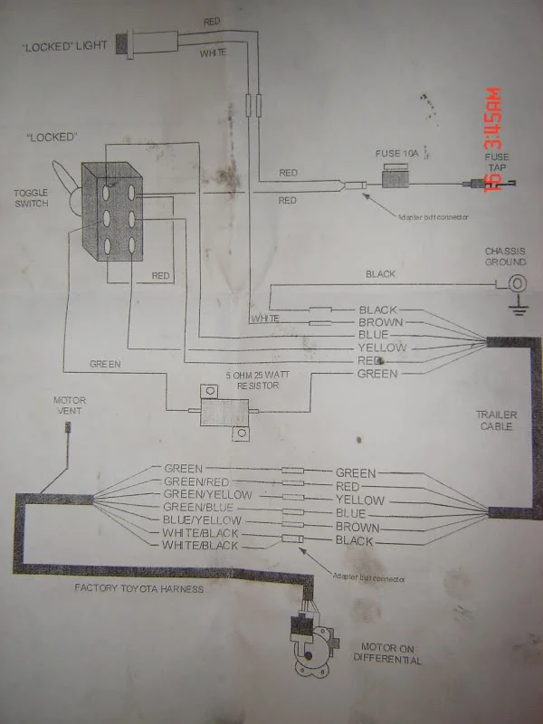

The wiring is fairly straight forward, and i used OEM harnesses from an 80 series and just modified them to work with the OEM switch.

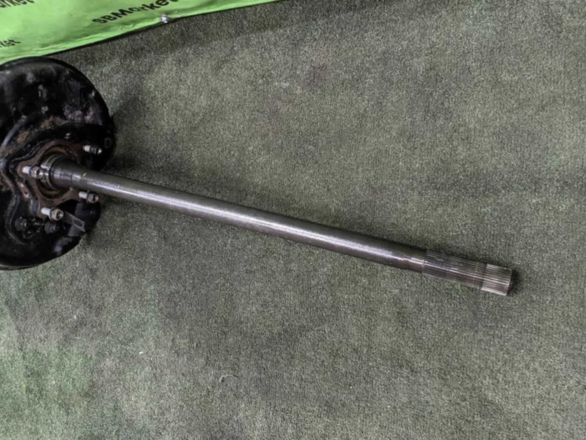

Poly Performance sold the axle shafts with the longer splines.

80 series and 100 series elockers function exactly the same (from a wiring perspective), although not interchangeable.

Here is an OLD diagram i dug up online FWIW:
Ah yes, I didn’t think about the longer splined axle shaft.

The elocker collar slides along the axle shaft and a non locked vehicle had shorter splines
Wasn’t a big deal for the 80s and 100s because they were offered with a locker so the splines shaft was an OEM part that could be bought new, or sourced used.

The 200 did receive the locker option. Toyota did us a solid with the 200. All rear axle shafts have the long spline and will readily accept the lockers sliding dog clutch.
200 housing is wider so the 200 shafts are longer. Third members interchange.

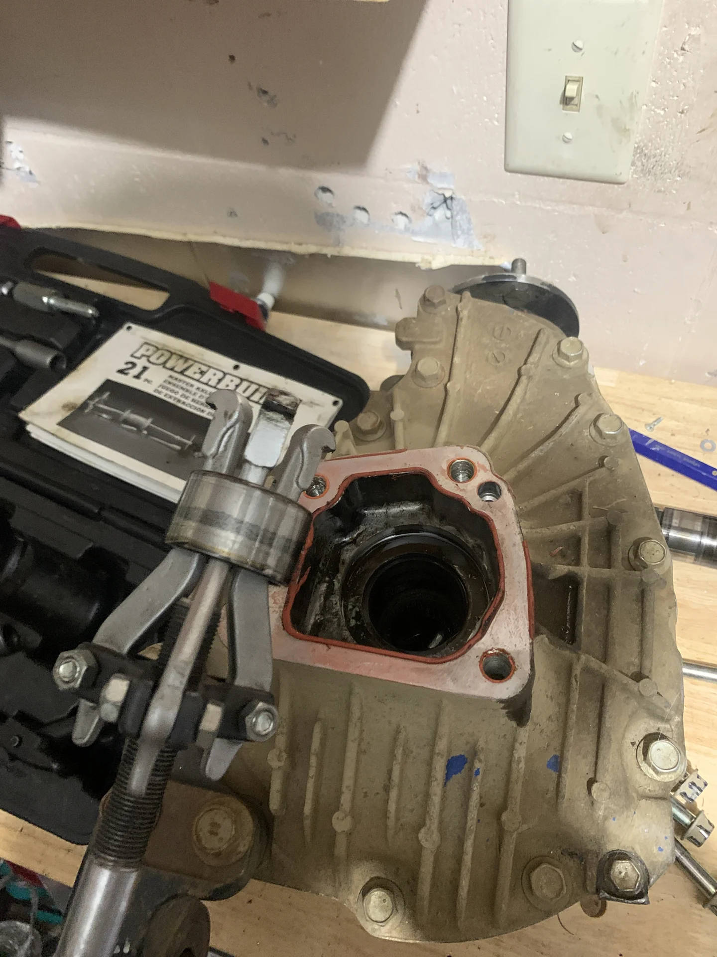

Would anyone happen to know what this seal part number is…or what it’s called? It’s a sort of rubberized irregularly shaped o ring (with the red arrow pointing at it).
Also, does anyone know what the axle extension to front differential gasket is called? Or a part number?
That is RTV. The “o-ring” part you describe is just the bead squeezed to the inside as the parts are mated.
If you can’t find the official Toyota stuff permatex ultra gray is great in that application.
Sometimes the right tool makes or breaks a job.View attachment 2349693
I can confirm: this tool did the job. 3 whacks and the bearing was out. It took longer to assemble the tool than it did to remove the part.
This tool is also free to “rent” from local auto parts store-I rented one from advanced discount auto parts.

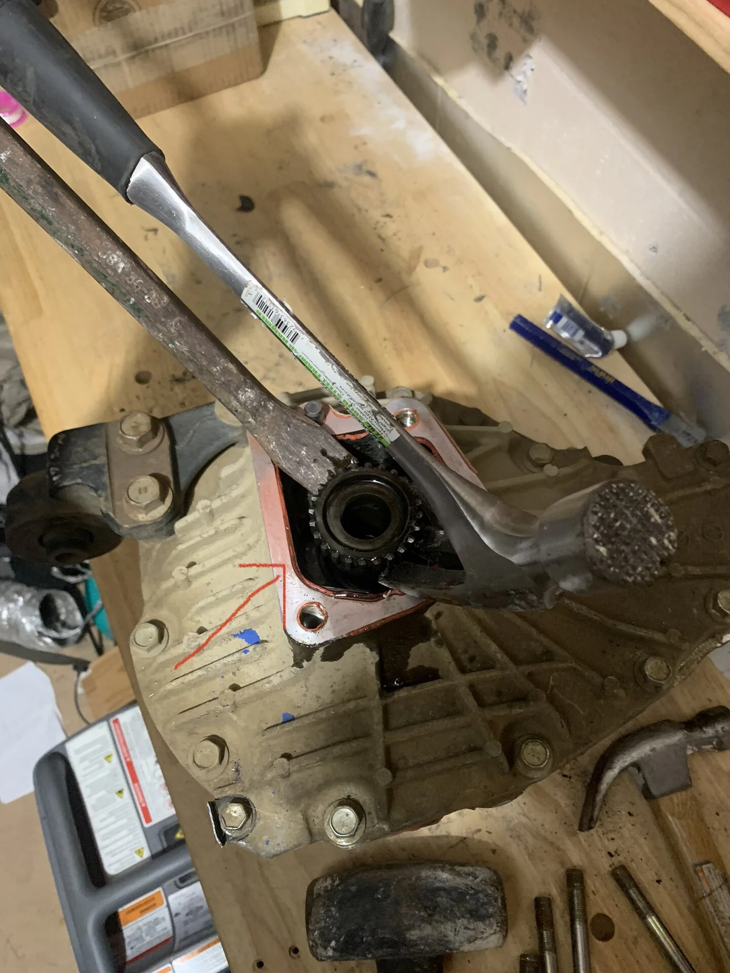

Note: also the sprocket thing came out super easy with a hammer prying on one side and a crowbar on the other…it was more about having two implements w the right angle to pry at the same time than it was about force…the hardest thing about this was getting the 4 17mm bolts out of the extension…that required a map torch (red loctite), an impact, and a long extension(odd angle).
