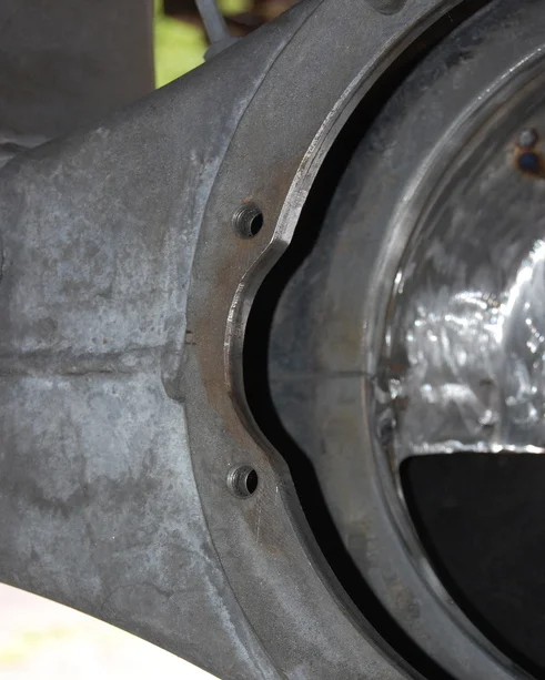

You’re aware you’ll have to weld & cut on the axle housing and drill/tap/swap out some of the third member studs right? Your non-KDSS sway bar will clear at least.
I've seen longer studs and "notching" the housing references on here. Both within my capabilities. Haven't seen any welding mentioned, But I have friend who's capable.
Notch and stud changes are the only requirements.

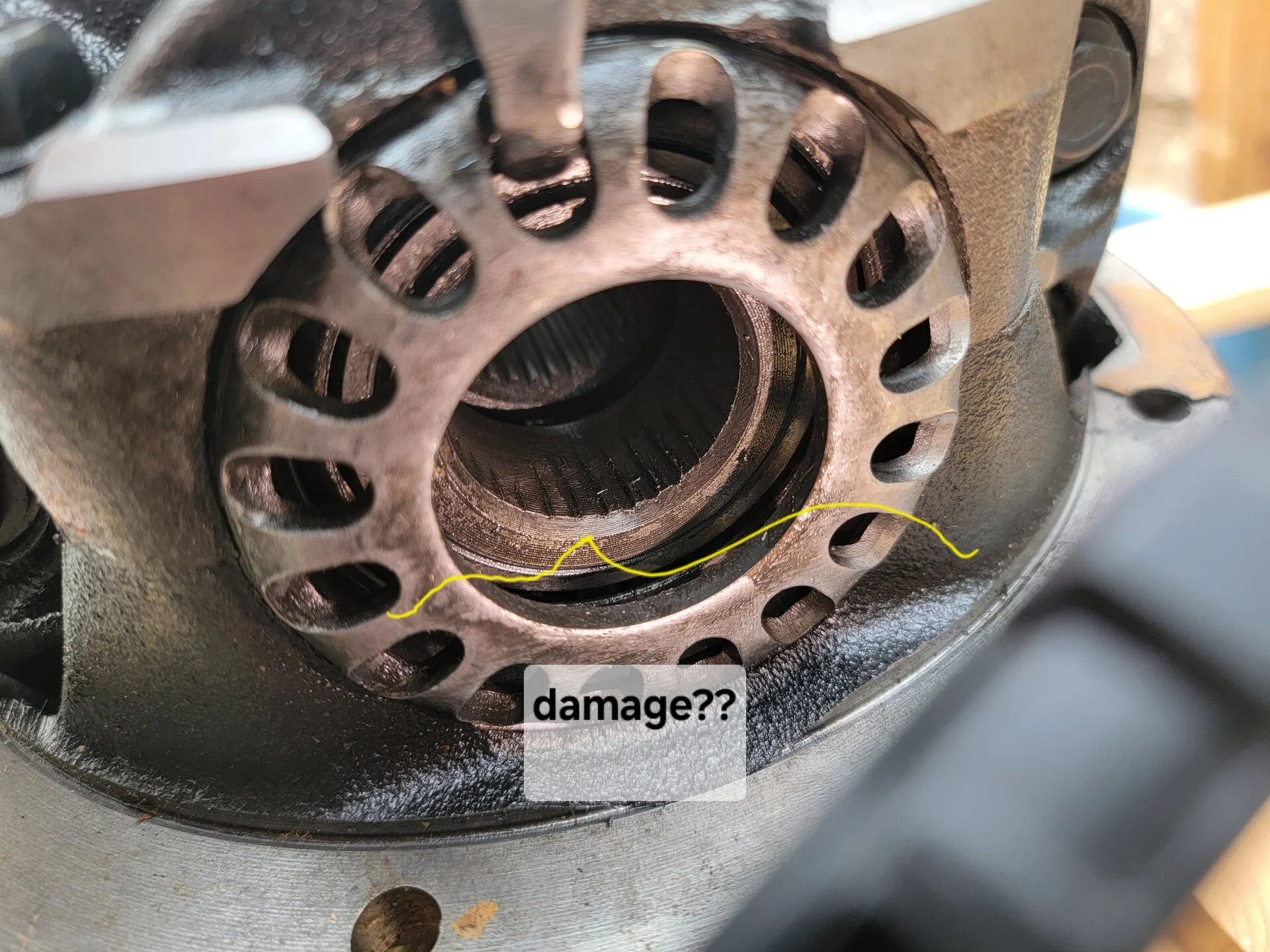

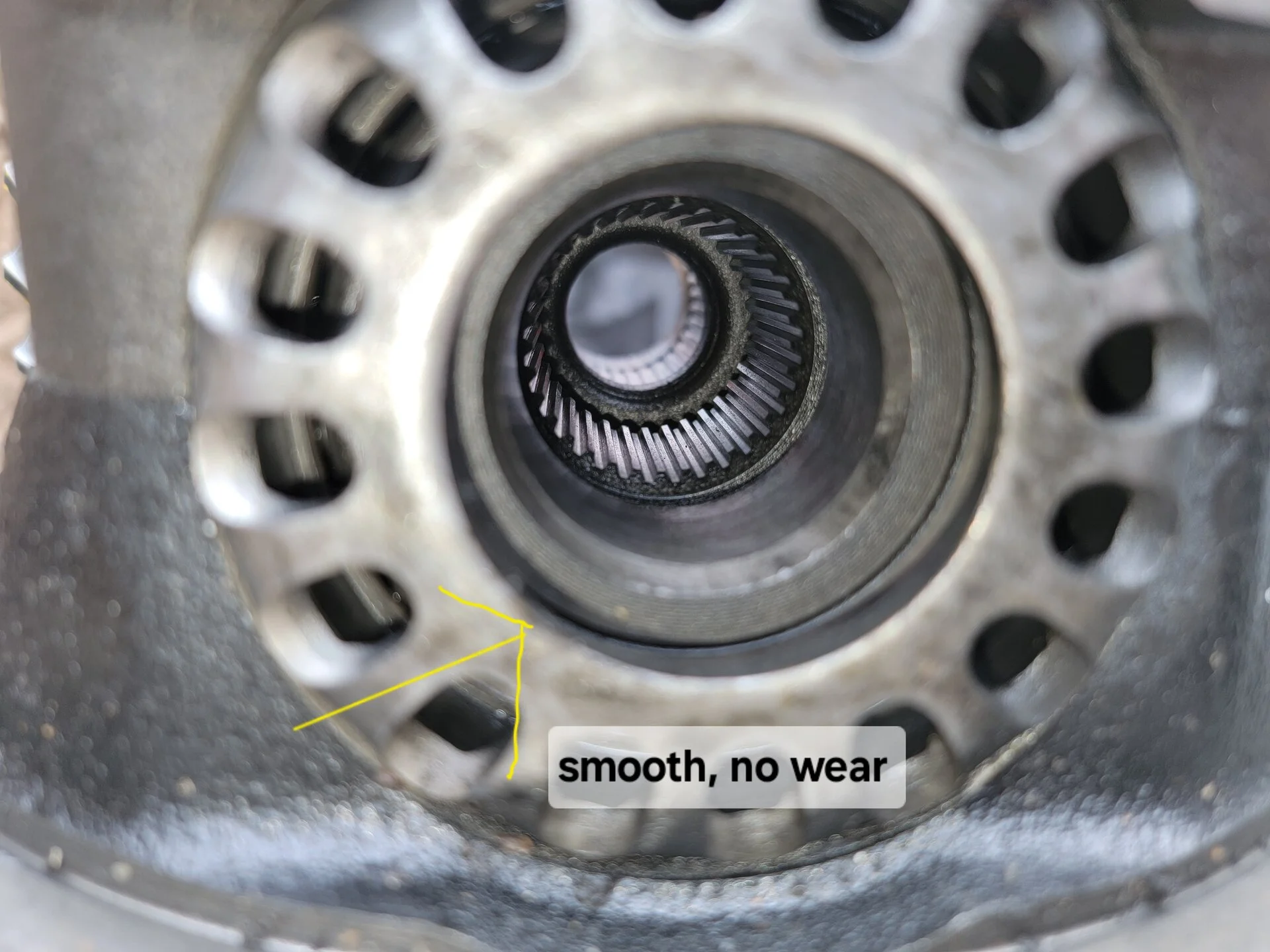

After inspecting the 3rd member all looked good with exception to one of the Diff Case Side Bearings.
The splines inside all look good , no visible wear. Just some heavy scarring on one side of the bearing.
Does this look like unsual wear and something that should be addressed before install? Or could this simply be damage that incurred during the removal by the "ebay pick n pull" seller. Hard to imagine they could scar and damage the bearing when removing the axle shafts.
