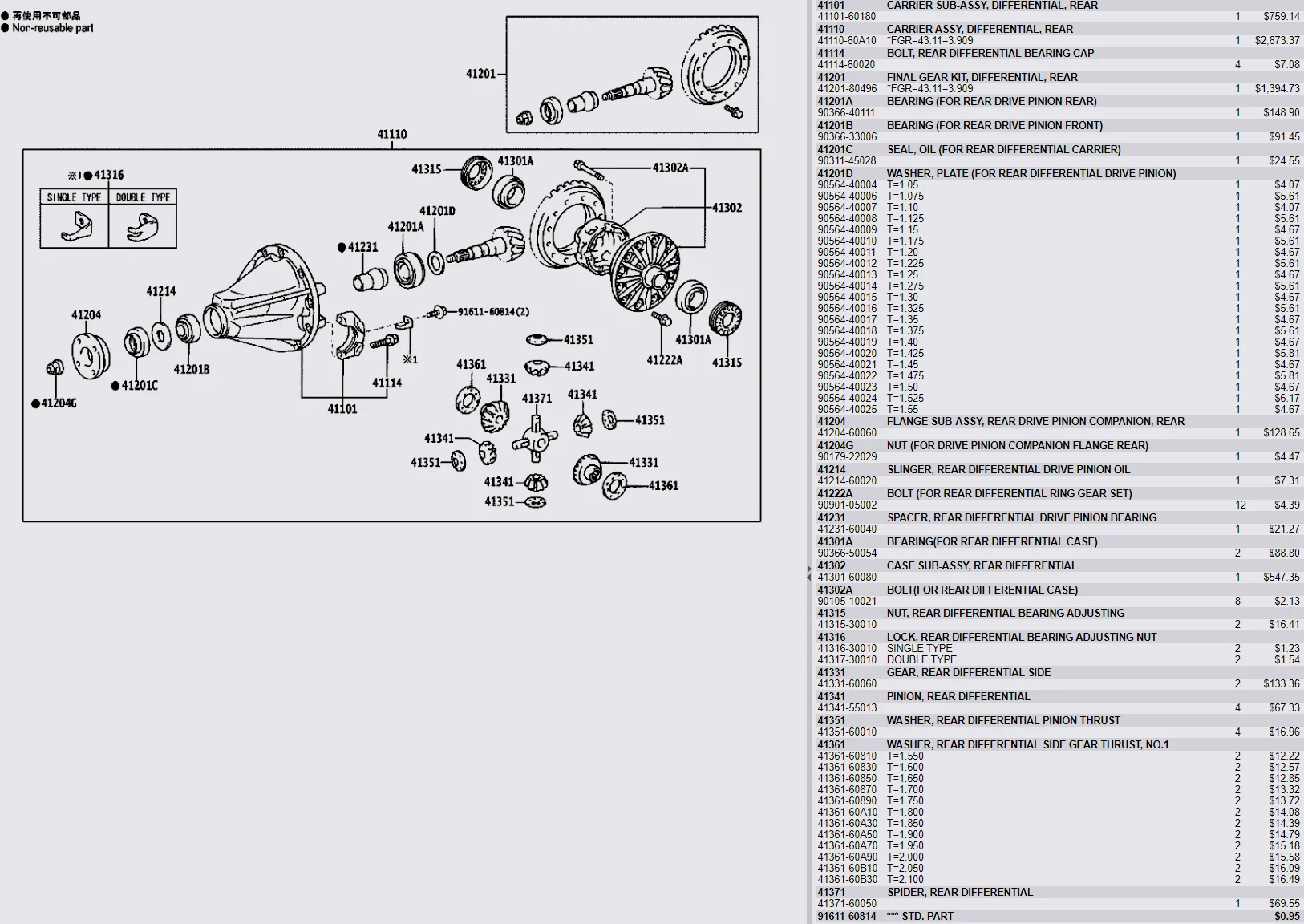

A new 4.3 rear diff chunk from a 100 (41110-60880) is $2400 MSRP.. $450 or so doesn't seem too bad.
Isn't the 4.30 gear set from Toyota $700 (41201-80493 from PartSouq shipped $679.57). If you were also adding an e-locker to the rear during the swap, would it make sense to get the 4.3 gear set from Toyota and a good used Tundra front? Or am I missing some part of the equation. I guess what I'm asking is if you are doing the e-locker, does the rear end need to be reset anyways, so you aren't saving any effort by using a 100series take off lump as far as ease of install?

Way more than $200 after you factor in the cost of bearings and setup. Hell even shipping it to someone that you can actually trust to set it up will add up.
This is where my lack of understanding of all the parts that need to be replaced comes in. Off to watch the videos on OTRAMM for rebuilding 9.5" rear ends with and without E-Lockers..
Zuk’s pictures and descriptions are old school but should be considered reference material for proper setup.
In short, best practice is to use all new bearings and crush spacer. Plus the installer will need enough various shims to dial in the pattern. I’ll post some pricing in a few hours.
It's all there in the first post. The original pumpkin and parts are all applicable in the build-up with a new ring a pinion. Whether you have a complete donor pumpkin or or just new ring and pinion, doesn't really matter as replacing bearings and hardware are kind of an independent decision. If you're going to re-use hardware, it'll likely be the known condition ones coming off the cruiser anyways. Yes, there are the other minor things of shims and crush spacer.
