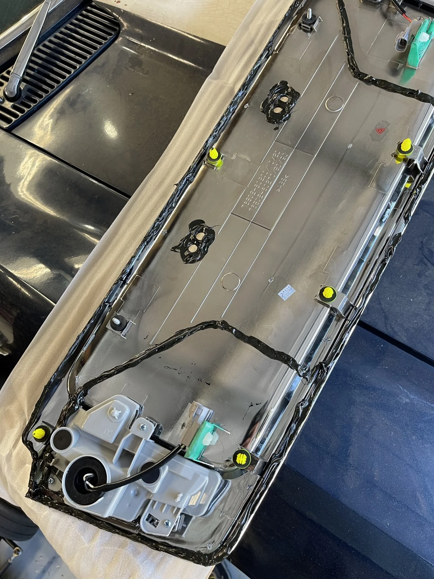

Ben can supply blank off plates like @1world1love has, but I was curious about this $150 knock-off (from a 2021 LX) I found on eBay. It took nearly a month to arrive from China, and so far the quality seems decent.
The stock storage trim pops off after you remove 4x 10mm bolts.
2 10mm nuts, the 2 license plate screws, and 7 yellow clips hold the entire license plate assemble to the tailgate.
The new part doesn’t have any weather stripping or rubber seals, so I used some Permatex non-hardening form-a-gasket to seal up all the places the stock one has rubber.
I let the gasket goo dry for about 20 mins and then slapped it on. I didn’t test fit, but fortunately all clips lined up.
the last pics were taken with my full weight sitting on the tailgate, so we’re back in business!
Hopefully the LEDs don’t explode and all will be well....
