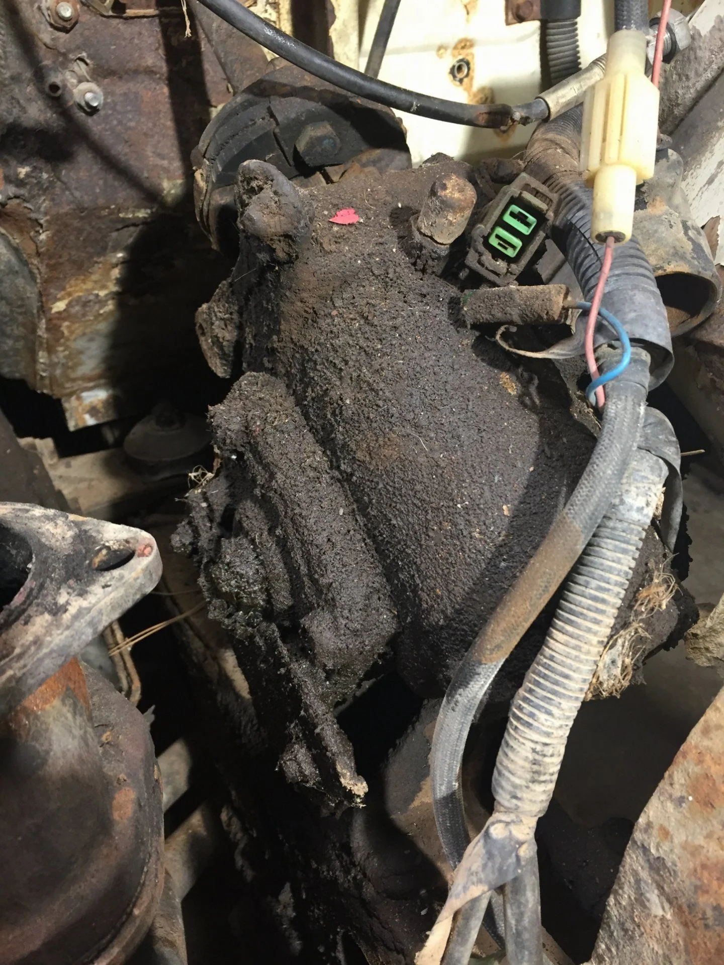

all Jan 79+ blocks were drilled and tapped for the power steering bracket. do you have a power steering gear box?
do you have any pics?
GM CS-145 alternator. Bolts right up to this style 40 bracket.
@3_puppies , I'll post one tomorrow. I don't know how to tell the difference.
@GHalll : that's exactly what I was looking for. I just removed my alternator tonight, and I'm pretty sure that's the bracket.
