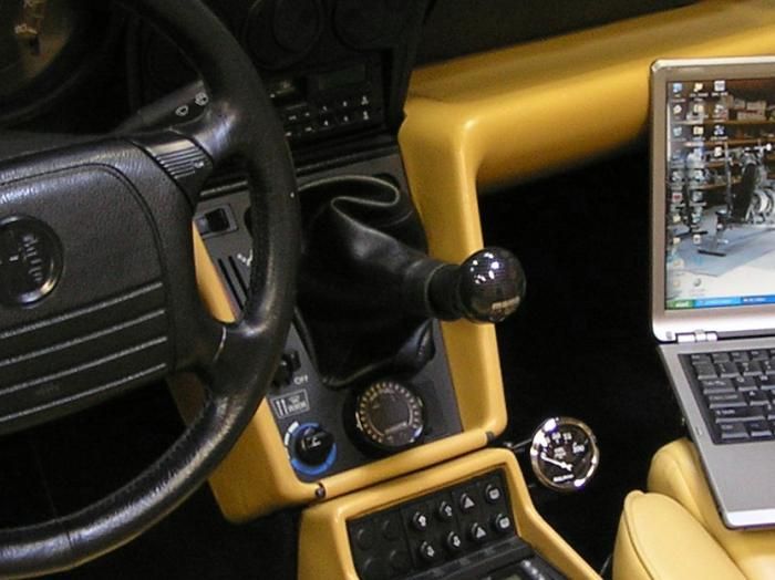

Since the dash will be re-constructed I think I'll try and run the shifter up into the dash area instead of into the standard floor location. Similar to the old Corvair location.
