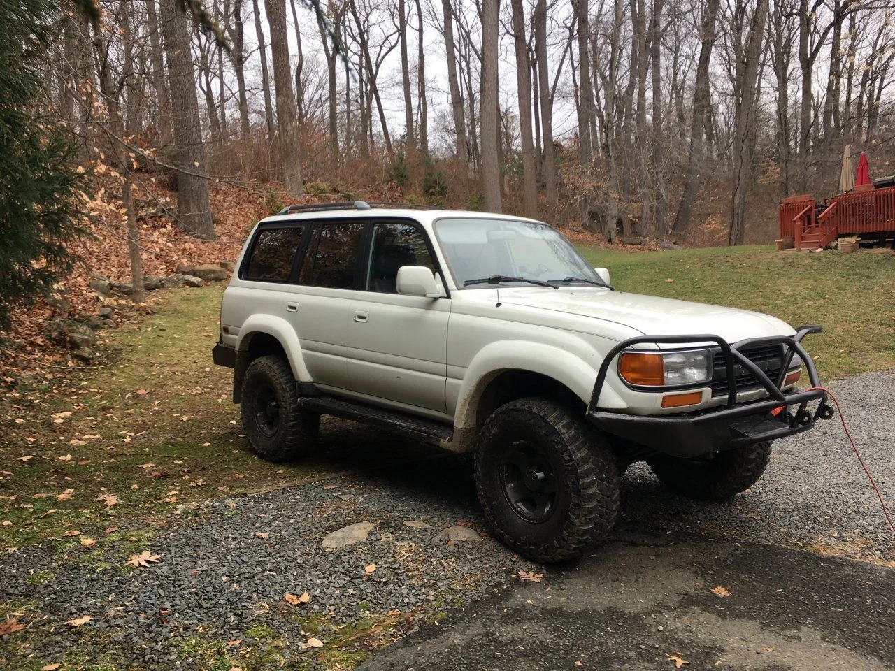

1. Year and model of the original truck. 1996 US Market FZJ80 with Kazuma S/C
2. Brief details of the Drivetrain that was swapped in. Toyota 1HD-FT from OZ, mated to H151F, and the original T-Case which was upgraded to Hi and Lo gears. GTurbo, Safari Intercooler
3. What went really well with the swap? The wiring was less complex than I originally thought. Ended up doing almost all of it myself, and used wires already in place within the FZJ loom. Also found that many of the factory parts can be found and sourced from several places throughout the world. The re-reg as a diesel was also pretty painless.
4. What was unexpectedly difficult with the swap? The AC lines and plumbing from the turbo, intercooler, and intake.
5. Mods...aside from drivetrain, if any? OME Heavies, ARB AirLockers with 4.88's, 315 BFG AT KO, Safari Snorkel, dual batteries, VDO Pyro and boost, dual fuel tanks.
6. Driving impressions after the swap...including drivability in daily driving (if applicable), highway travel, and, of course, off pavement. Heaps of torque. End up in 5th pretty quick, which means going back to 4.10's from 4.88's.
7. Realistic fuel consumption after the swap...lol. No idea yet, as still on my first tank. Crossing fingers for something around 20 mixed.
8. Five star rating for overall difficulty of the swap: *=relatively easy, *****=don't even attempt it unless you have some real good friends who are really handy. **** as it is not for the faint of mechanics or electrical, nor low on the monetary front. Help came from Valley Hybrids (Dom and Georg) who handled much of the heavy lifting, and from Sheldon/G&S for a bunch of used factory parts, TORFab for the intercooler, Japan 4x4, Partsouq, Amayama, and Beno for the OEM Radiator which should have never been in the US!

I thought the RPM would be lower at that speed. Is it in 5th gear?
4.88's make the rpm higher than I would like. Speedo still needs a little correction, as actually GPS says that it should read 65. Will be going back to 4.10's.
To bad you don't have the factory locking diff's. I have a set of 4.10's that I would love to upgrade to 4.88's ;)

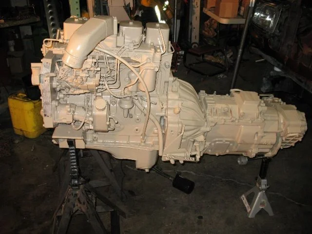

Good friend Ken did most of the work. engine was installed level, the tranny sits at about 5 degree slant due to the breadvan adapter plate.

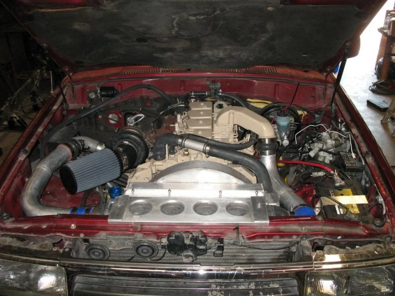

1. 1994 80 series
2. 1994 80 with 4BT/NV4500/Orion. .
3. What went really well with the swap? - the end result.
4. What was unexpectedly difficult with the swap? - everything. not an easy swap.
5. Mods...aside from drivetrain, if any? - Intercooled, 3200RPM spring, H1C turbo with 54MM inducer. Boosts to about 22psi, 900F pre-turbo. ~95:1 crawl ration.
6. Driving impressions after the swap- Really loud at idle. And shaky. Would drive you crazy on the trail all day. once over 20mph, it's fine. And after new injectors, much smoother.
7. Realistic fuel consumption after the swap. - don't know. already sold it.

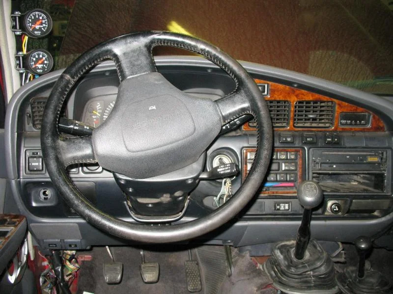

8. overall difficulty of the swap: ***** HUGE pita to install. To make it fit _right_, needed custom exhaust manifold cut from a 6BT, oil pan and pickup tube modified, floorboards clearanced for transfercase, and the NV4500 stick comes up under the dash (picture a SM420 in a landcruiser).
But it drives way way way nicer then a 4BT w/auto. 100x nicer.
YouTube - 4BT Running in 1994 Land Cruiser 80 Series
All gauges work, including the tach. Luckily we had a Proffitts converted 80 to figure out the wiring from... otherwise... phew, good luck. FJ60 hubs on the front, fit perfect (pre-95 birfs are smaller).
