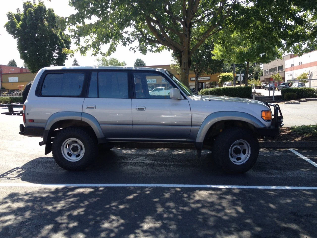

1991 FZJ80
1994 Isuzu NPR 4 cylinder Turbodiesel
Toyota stock transmission and transfer case (Both rebuilt and custom built torque converter)
Front long arms adjusted to correct steering and clear drive shaft
Custom AC unit installed
Air dog fuel filter
Gas mileage is 16 city and 19 highway
1991 FZJ80
Air dog fuel filter

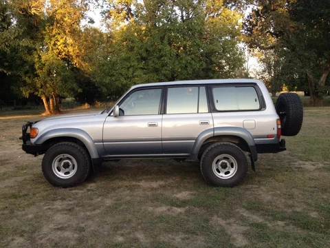

This has been my daily driver since May.
1. 1997 FZJ80
2. Japanese 1HD-T, AU H150 5 speed, transfer case converted to part time with Marks kit.
3. ?
4. Getting a brown manual shifter console - its discontinued... Getting a clutch disk.
5. Locking axles swapped in, lift added, 4xlabs rear (kit), dual filler with OEM sub tank, part time t-case conversion, locking hubs on the front, new drive shafts, OEM steelies
6. Drives great. I have done the same swap with an auto trans and the 5 speed is much more fun to drive.
7. 18-21 mpg but seems consistently closer to 18.
