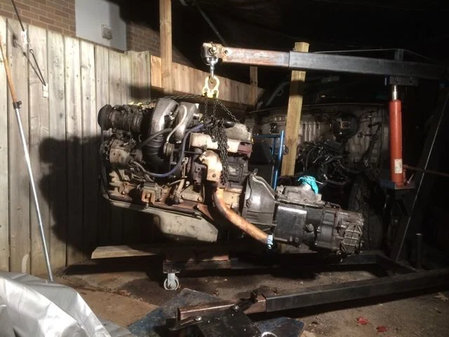

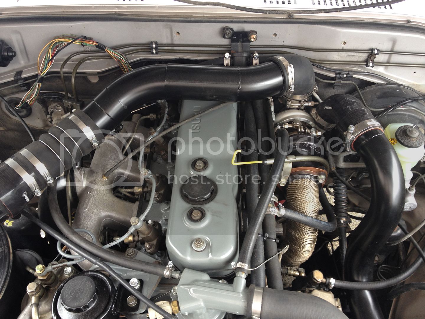

1. 1997 Lexus LX450
2. 1987 Isuzu 4BD1T out of an NPR, A440f out of a 91-92 FJ80, custom adapter lower stall converter.
3. Overall it went very smoothly, lots of research and people before me made it easy.
4. The adapter took much longer than planned and delayed the swap by about 4 months.
5. Slee 4" lift, could have used 2.5" OME with a bit of work.
6. Have only driven it shortly around my area nothing over 40kms/hr so far but feels good.
7. TBD
8. If you have a welder and some mechanical ability. **1/2
9. Pic
10..https://forum.ih8mud.com/threads/isuzu-4bd1t-lexus-lx450-land-cruiser-build.702121/
...via IH8MUD app
Great job on the 80 series Isuzu 4BD1T conversion! From the pictures it looks like a good fit--not nearly as tight as it was for my 6.2/6.5 conversion. Like you, I stayed with a A440F transmission, which made the conversion much easier.
Sorry to hear that the Duramax conversion into an 80 series isn't working out as well.

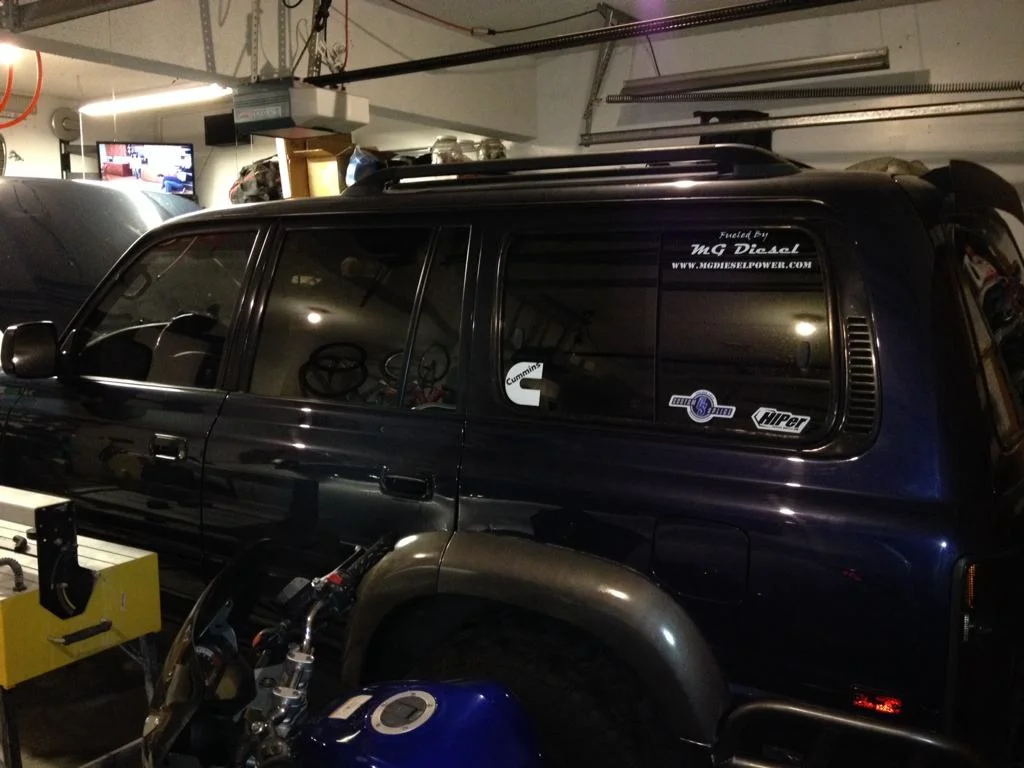

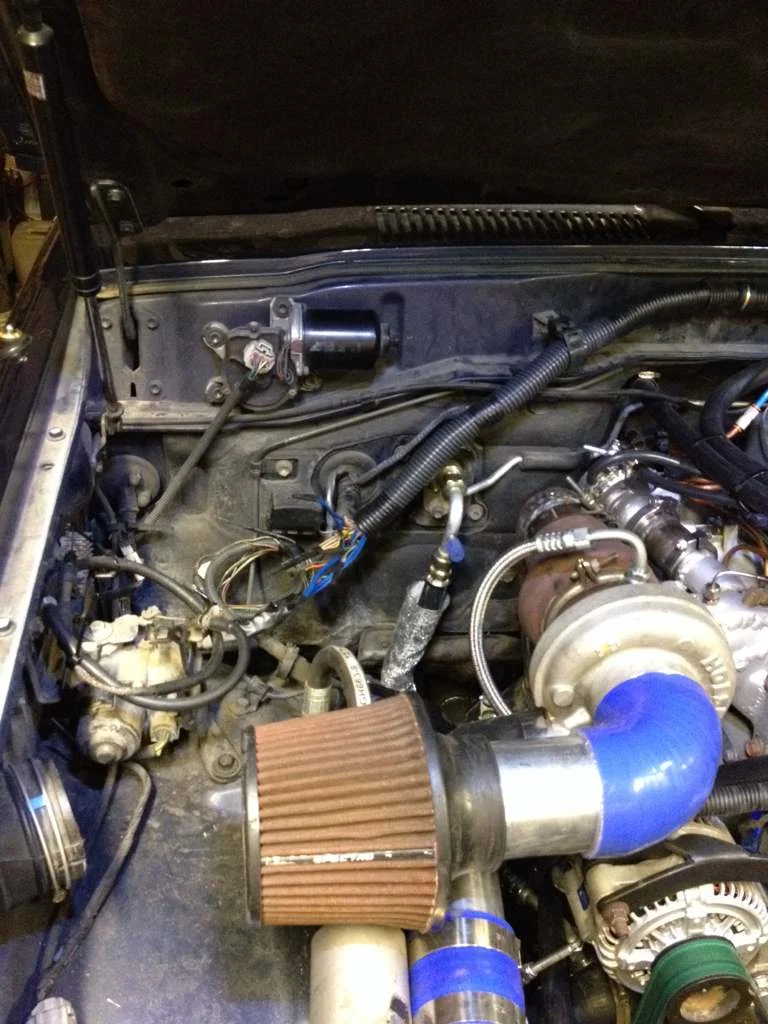

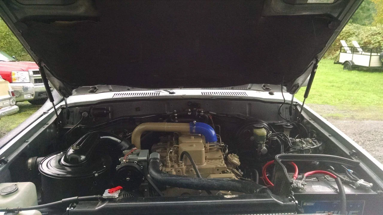

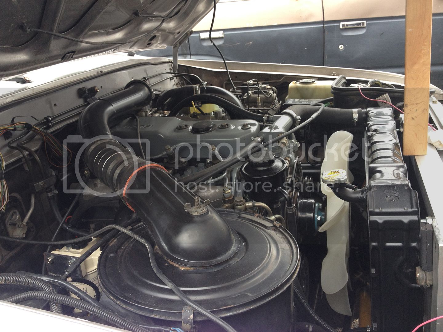

-1996 fzj80 230k
-1987 4bt VE pump I had it in a jeep cj7 for a few years and wanted more room. Hx30 custom exhaust manifold 3" exhaust, intercooler and injectors need fuel pin but have 3200gov spring
used dustins (dieseladapters.com) adapter plate cummins b-series to toyota
-Stock when I started factory lockers A343F with TransGo shift kit 10" coilovers with swap and 1 3/8" body lift at the same time goal is 2.5 suspension lift
-I Still have not touched rear end need a few inches
-I like where the turbo ended up seperared hoses and fluids from the high heat for the most part but on the flip side the driver (left) is crowded and tight
-My buddy is getting 23 out of his 94 dodge 3/4 ton 4x4 4bt. But I will be happy with 20. TBD
Need to get some better pics of the engine.

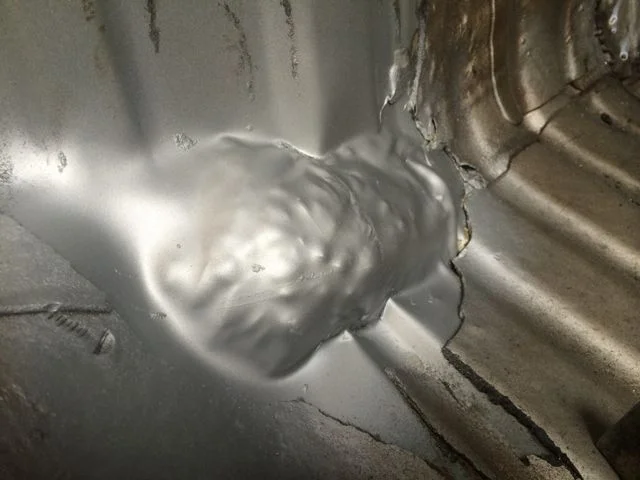

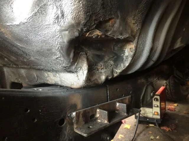

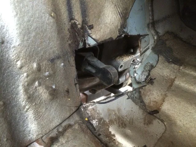

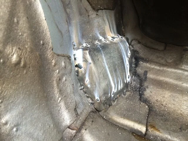

I have been building up an 80 series diesel swap ( slowly). Anyways I have to say this site was a key part in making it happen. I would like to post a picture of the H55f sticking out from under the tranny hump.
I know it was not an ideal swap but it had to fit. And it did with some cutting and a bit of BFH work. It also required some fabrication of cross member mounts. It isn't a purdy swap but it's not for show.
I used the same H55f mount idea as a fellow mudder did. Anyways enough talk here are some pictures of the down and dirty. And yes I did clean it up and seam seal the welds and sprayed it with paint and bed liner.
Didn't help much for looks but will stop the rust.

I still have lots of work ahead and will add more pictures in the future.
This build is a way to keep some of my Hj61 alive but have somthing more family friendly. Also I would like to thank Stone for answering my many questions. Big help!!!
