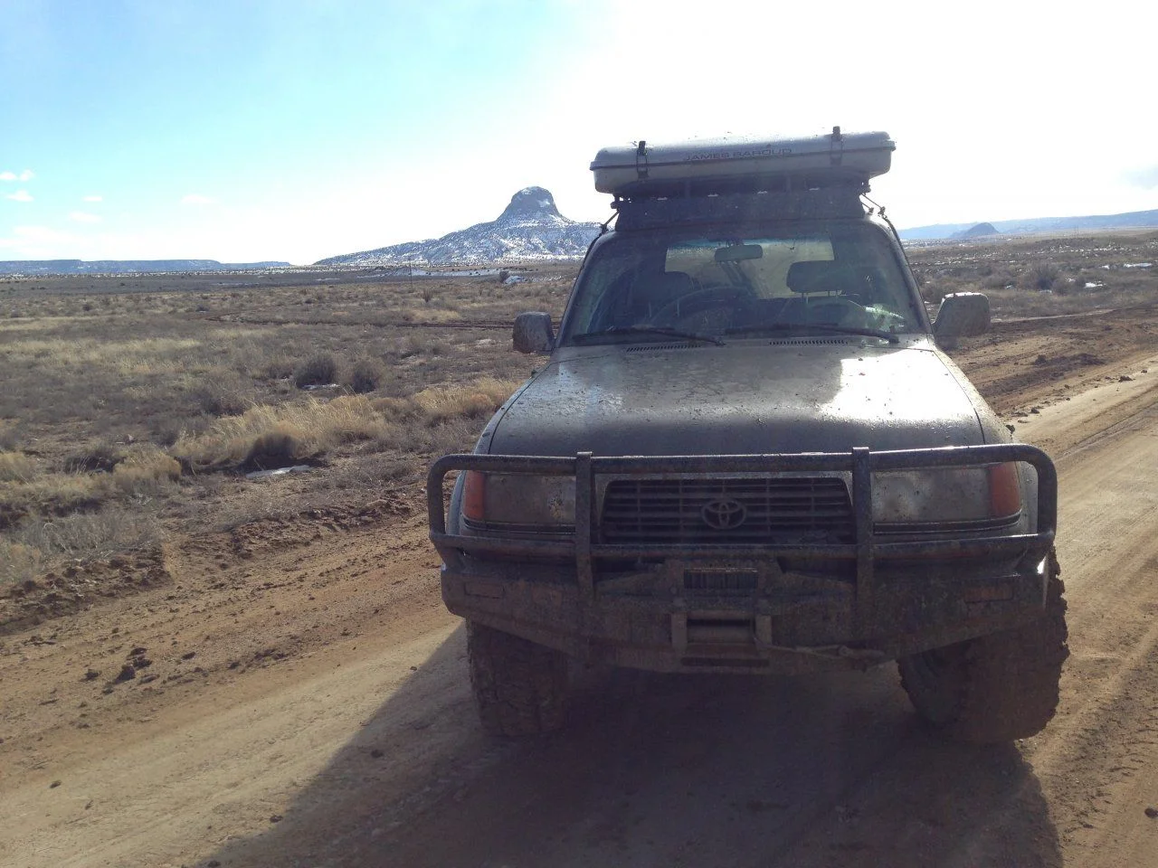

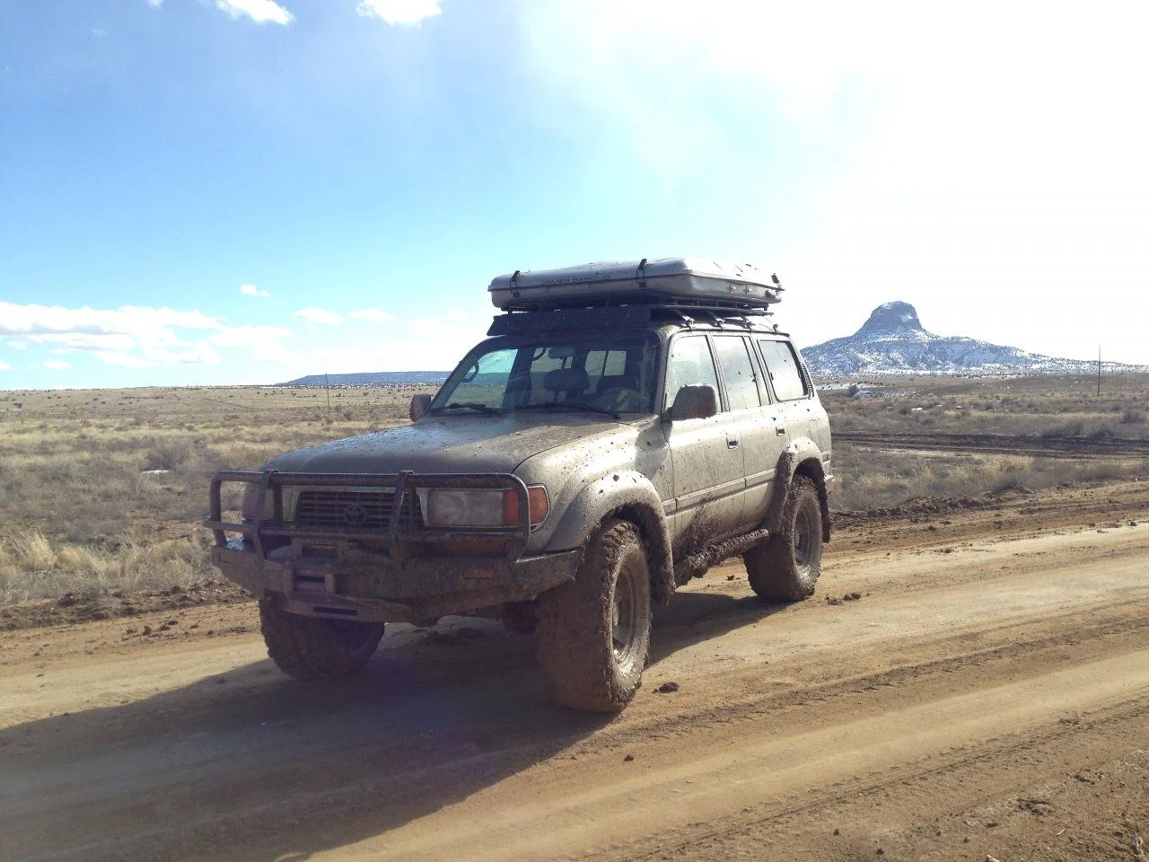

1. 1997 FZJ80 40th Anniversary, nicknamed Bunny
2. Rebuilt Cummins 12v 6BT, NV4500 5-spd, sourced from a 1994 Dodge Ram 4x4
3. What went well? SO MUCH POWER. Great working relationship with builder.
4. What was difficult? 99.5% of the problems I faced were down to non-performance and 3 months' radio silence from the vendor of the adapter kit/wiring harness, Diesel Adapters. Beware. Do your best to find someone other than him to rely on.
5. ARB bumpers front and rear, 35" MTRs, OME 4" Comp Coils, Warn MD1200, OME Nitrochargers, OME steering stabilizer, cross-drilled / slotted brakes, Slee sliders, Gobi Ranger roof rack, James Baroud RTT, custom shift lever and sweet shift knob... lots more planned.
6. Driving impressions are: you need low gear ratios to take advantage of the characteristics of the motor. I'm going from 4.88s back to 4.10s. Haven't had to push it much offroad, but there's already so much clearance, suspension travel and traction that I'm in love.
7. Fuel consumption... 14mpg on my first full tank of diesel. I expect it to go up as the motor breaks in and I re-gear to 4.10. Expecting high teens or just barely 20.
8. *** - I'm the type of person who hires professionals to do what they do best, and I'm mechanically not so strong. Three stars of difficulty purely for vendor hassles and my own learning curve.

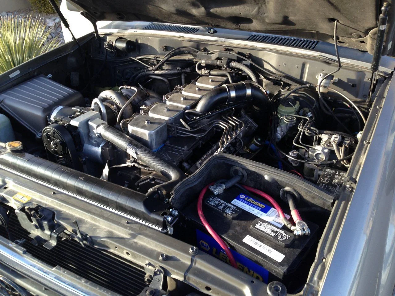

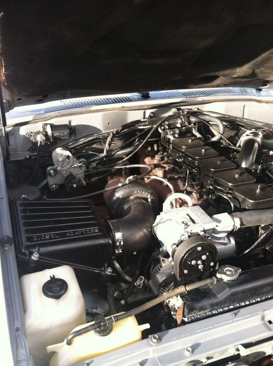

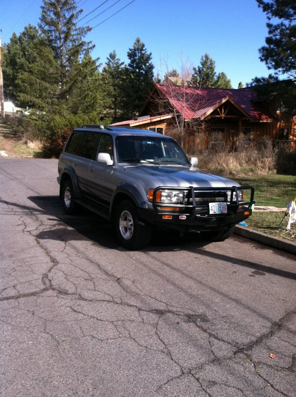

1994 FJ80 with Aisin 442 compushift
1994 12 valve cummins bone stock
I purchased the truck from Diesel Adapters, They put on their whole kit. Everything else is functioning well and needs a little work
Currently I have only filled up three times, looks like highway mpg is in the low 20s 17ish around town.
