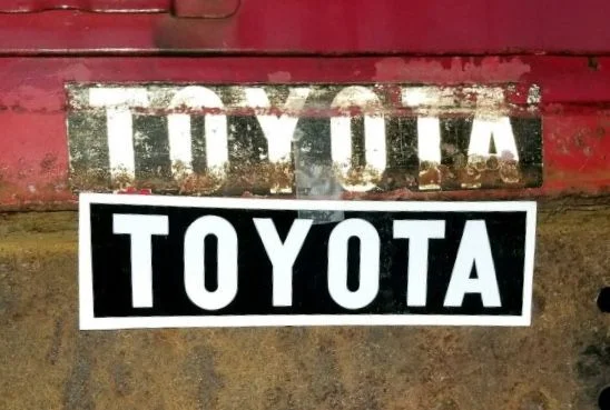

The current repro is too small, has too much black area above and below the white letters, and does not have reflective letters as the originals did. and worst is that it has a white border around the whole sticker that the originals did not have. The white border could be trimmed, but that would make the already small size even more so. This picture (provided by @HelloKitty65 ) shows the differences.
Update - I now have one of the current repros in hand, and I need to make a correction. It does NOT have a white border, it is black all the way to the edges as it should be. It is—however—quite a bit smaller overall than the original, with too much black padding proportionally. It is over 1/2" too short in length, and 5/16" too short in height. It would look a touch small on a freshly painted tub, but would not cover the original sticker area on a tub where you were replacing an original without paint.
I am looking to have a small batch made. Probably 10 or so, perhaps more if there is demand. Using dimensions and such from my own painted over sticker and also from other surviving originals, the new stickers will be 7 9/16” x 1 11/16”. Like the original, no white border, black all the way to the edges. The letters will fill most of the vertical space, being 1 9/16” tall with 1/16” padding above and below. Horizontal padding will be 5/16” on both sides.

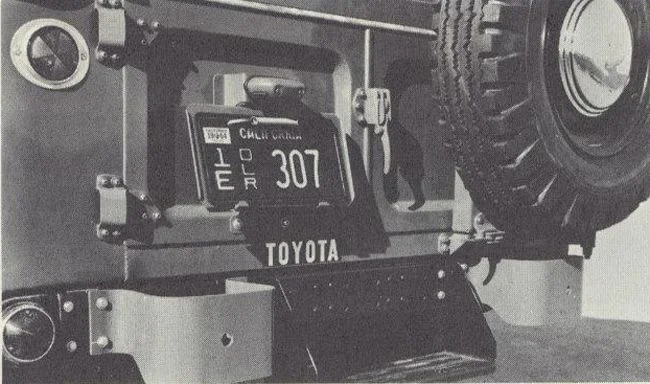

I thought these stickers were only on earlier rigs, before 64? Maybe that’s just the 45’s.
Form what I’ve read, on 40s the sticker started with the ‘64 model year (late ‘63 builds) and continued until the actual Toyota corner emblem was introduced. I’m uncertain when the emblem replaced the sticker, probably in ‘66, I think.
My theory is federal law required maker ID and that's why they added them. Wonder if other countries got them.
The first listing I see is in my Jan. 1965 parts book, 75450-60010 FJ40/43 75450-60020 FJ42L HTH, John
I always figured it was added at the request of the dealers. To the uninformed drivers following an FJ40 in ‘62-63, it looked much the same as a j**p.
