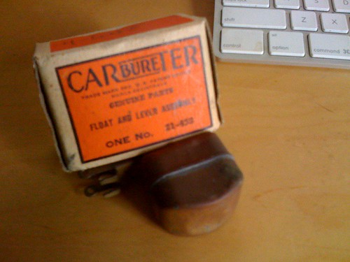

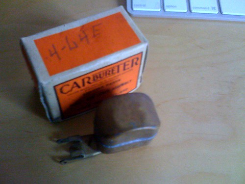

So here is the break down today, I found a carter brass/bronze float that looks identical to the one in the manual, pop it in with the float adjust per manual.
idles liek a dream!!!!!
BUT, when you drive it, the float get stuck "open " meaning the fuel bowl fills up and prevents it form idling correctly... If you hit the top of the carb with a mallet, the float unsticks and bammo, idles like a champ.
So basically my float is getting stuck in the up position preventing it from going back down the the carb window line after you get on the throttle.
WTF cause this?
:D
I will post some photos of the carter float i found, looks the same as the manual :D
What dusty old joint did you find that in? That old place up the road on Milwaukie towards Powell?
