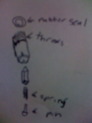

Is there a spring under the needle?
Id there a diagram I can look at?
yeap spring under the needle
I do not have the books with me, but it seems correct
circular shaft screws into the upper housing, a metal square with a point goes in up, the a spring on the under neath and a small screw pin goes into the spring.
crappy cell shot of a drawing
That would be correct......so it idles fine......drive it a block or rev it then it sputters like its out of gas but the bowl is full?
