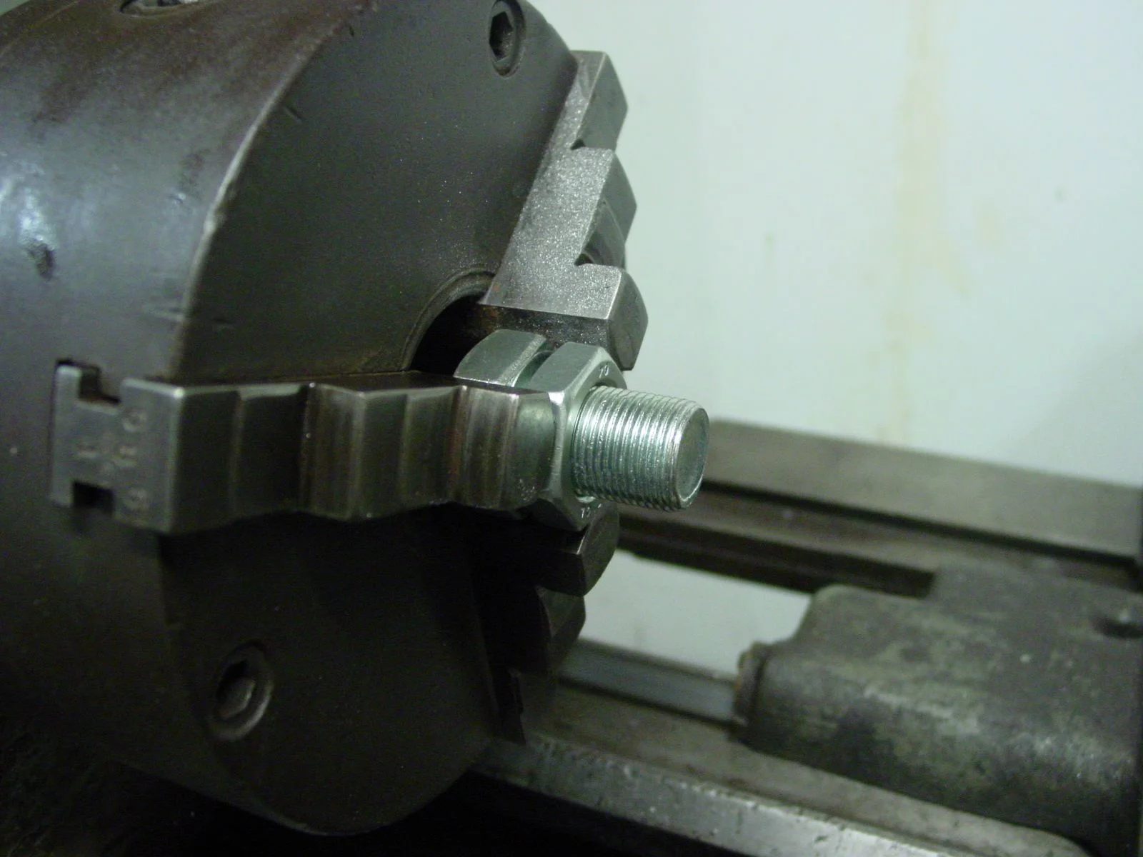

OK, Ordered another tool to hold work in the lathe. How many tools does one person need? Don't ask silly questions. ;)
Tool arrives tomorrow, will figure out efficient machining of the 1979 EGR plug in the next couple days.

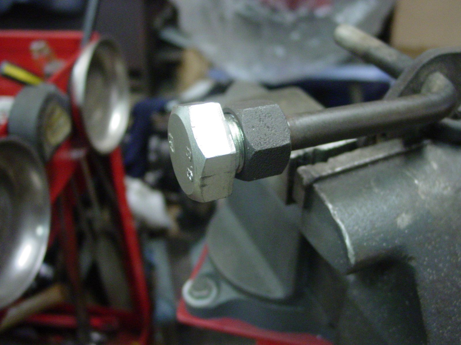

Got a new holding tool, then broke the parting off tool. Not to self: Cutting off a fine thread, hygrade bolt is not as easy as Sch 40 pipe.
The 79-80 plug out is made from a large (M20 fine thread) steel bolt, because it is an available bolt thread. But the steel bolt is not as easy to machine as the free-machining brass. So one less step but slower production time, works out to the same price of $30.
Before breaking anything:
After cutting bolt with whiz wheel, facing off bolt, center drilling, boring, chamfering inside & outside...
Here ya go, @S.CarolinaFZJ80 and @mtrdud.
edit: this would benefit from a quick coat of flat black primer, IMHO.
