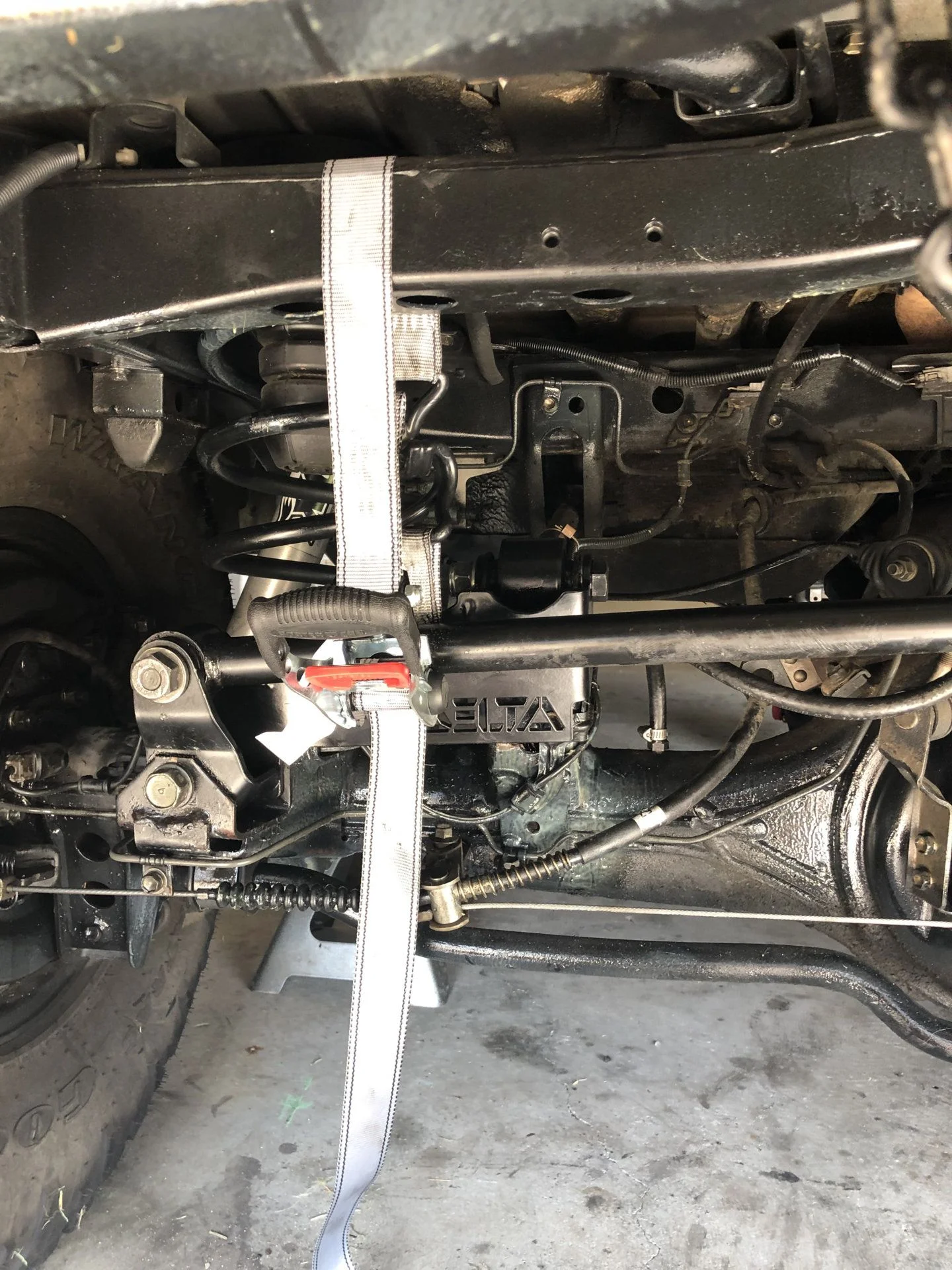

The rear frame is on jack stands on both sides; both wheels are on the ground per the instructions. Should I lift the vehicle up more and see if that helps? I could use a drift to try and center the Panhard but clearance is slim on the spring side.
Is this what the instructions require an alignment bar for? I'm not exactly sure what that is.
I had to do some trial and error lifting the back up and down and using a pry bar and a mallet to get it all perfectly lined up. Had to use the mallet to tap through the bolts.
Ratchet strap for the win on the last bolt. I was able to insert the bolt as shown about halfway through the Panhard bushing, then ratchet the bar into position to allow it go all the way through with some help from a mallet.

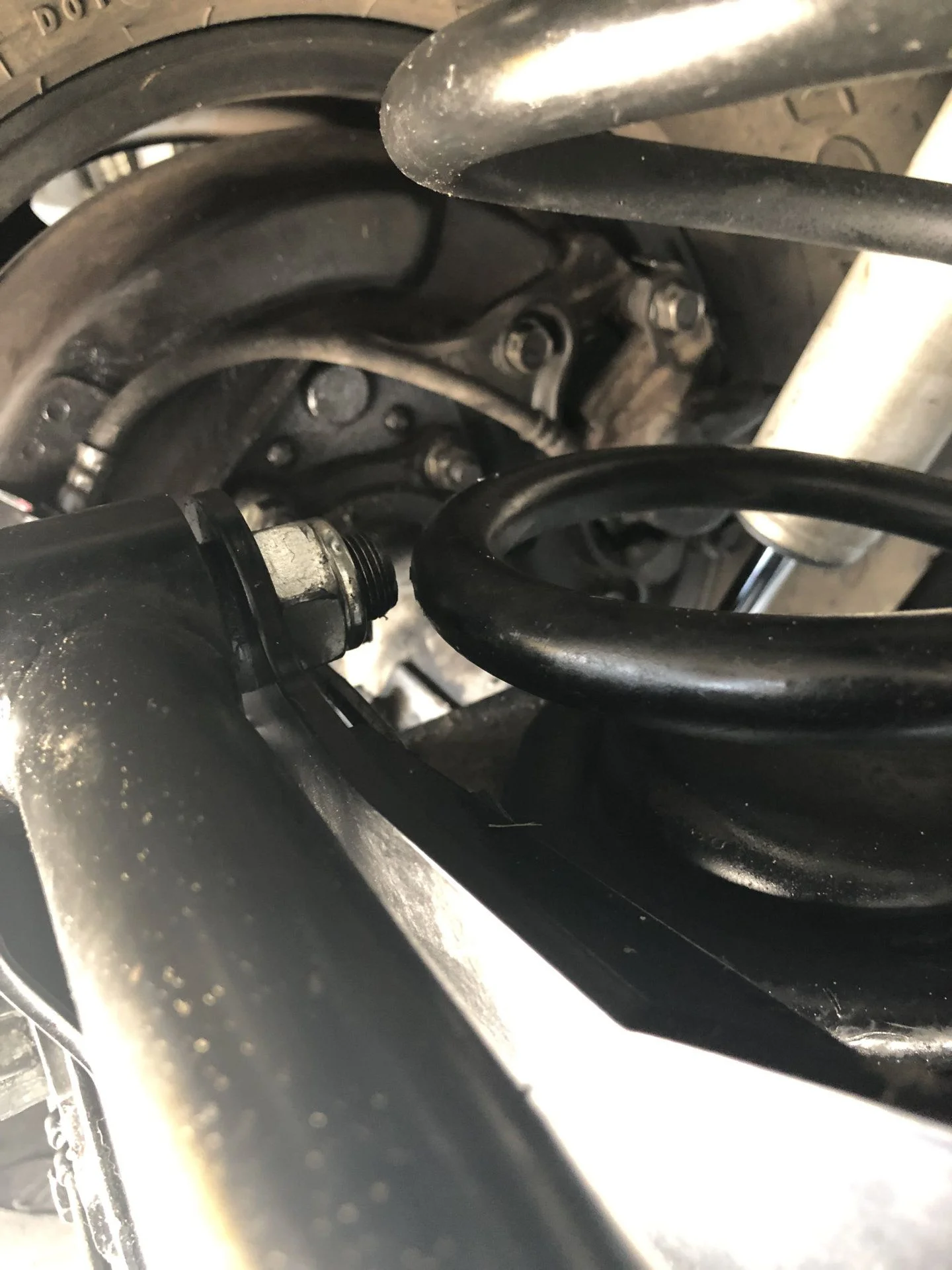

I'm not sure if I reversed the Delta bolts, but clearance on the OME springs is tight. I had to back the bolt out a bit to allow room to thread the nut.

Been out of service, sorry for slow response. Glad you got it dialed. What we usually do for the last bit is drop jack stands and push body around, that’s where the helper comes into play. Can’t really recommend that, but it’s what we do.

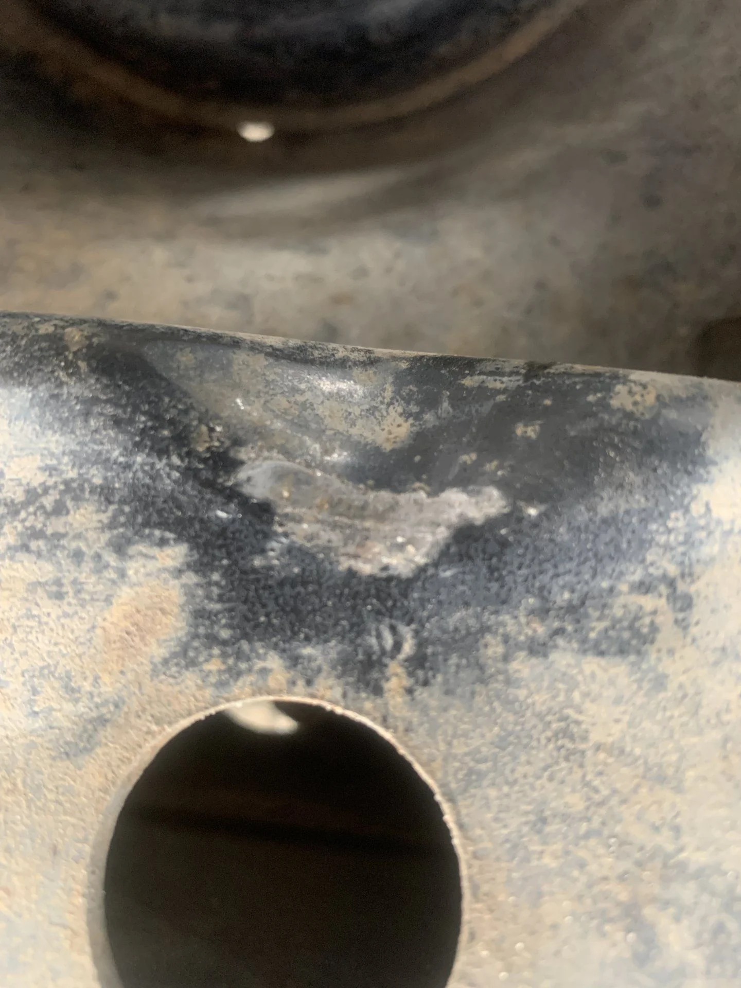

As a point of reference. I have an 80 series with armor and J springs. I have been using the 3" delta bracket and been very pleased with it until this last week when I drove my heavily loaded cruiser down the Mojave Trail and proceeded to attempt to clearance the rear crossmember by repeatedly making a load banging noise. Maybe I should have slowed down a bit more. My 1.5" bumpstop extensions were always perfectly adequate until I added the bracket. Will an extra .5" (2" blocks be adequate?) I would rather bite the bullet and lose a wopping .5 inch of uptravel rather than notch the cross member.
It looks like you could get away with even less potentially? We install 2" rear extensions with all of them and have had zero problems. Have even tested with bumpestop drops of nothing more than 1/4" plate and been rid of all contact. Always a good idea to pull springs and flex things out when installing suspension stuff.

Update* - It appears from that thread that part of the bracket needs to be ground down in order to clear the thicker than average Slee spring.
I finally bought the Delta Panhard bracket and swapped my Slee mediums 4" springs for the Slee Heavies 4" rear springs.
The new design of the Delta bracket gives plenty of room so long as the bolt head is facing the spring. The supplied bolt is longer than stock and would definetly rub the spring if positioned with the Nylock nut towards the spring.
