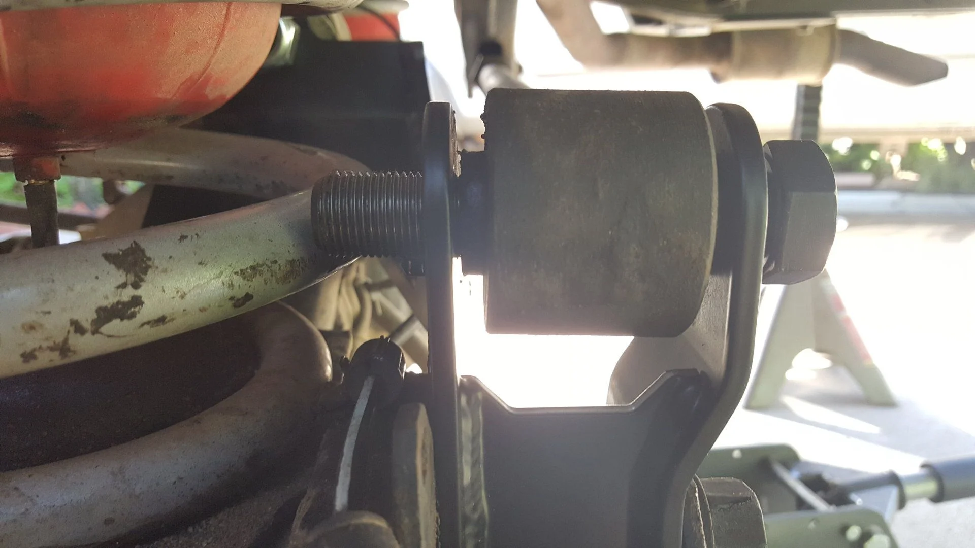

Just ordered this week and installed today. Nice product. Just thought I'd share my slight deviations from expected installation.
1) I'm running Medium Slee springs in the rear. They are similar to the OME 864. I was already planning on trimming the bracket a bit. Test fit it and sure enough was making direct contact. Marked it and ground down maybe 1/8 inch of material.
2) I tried putting the panhard bolt back in (nut on FWD side) and bolt wouldn't even install since the coil was in the way. So I had to remove coil and install it flipped. Plenty of clearance now!
Installed flipped:

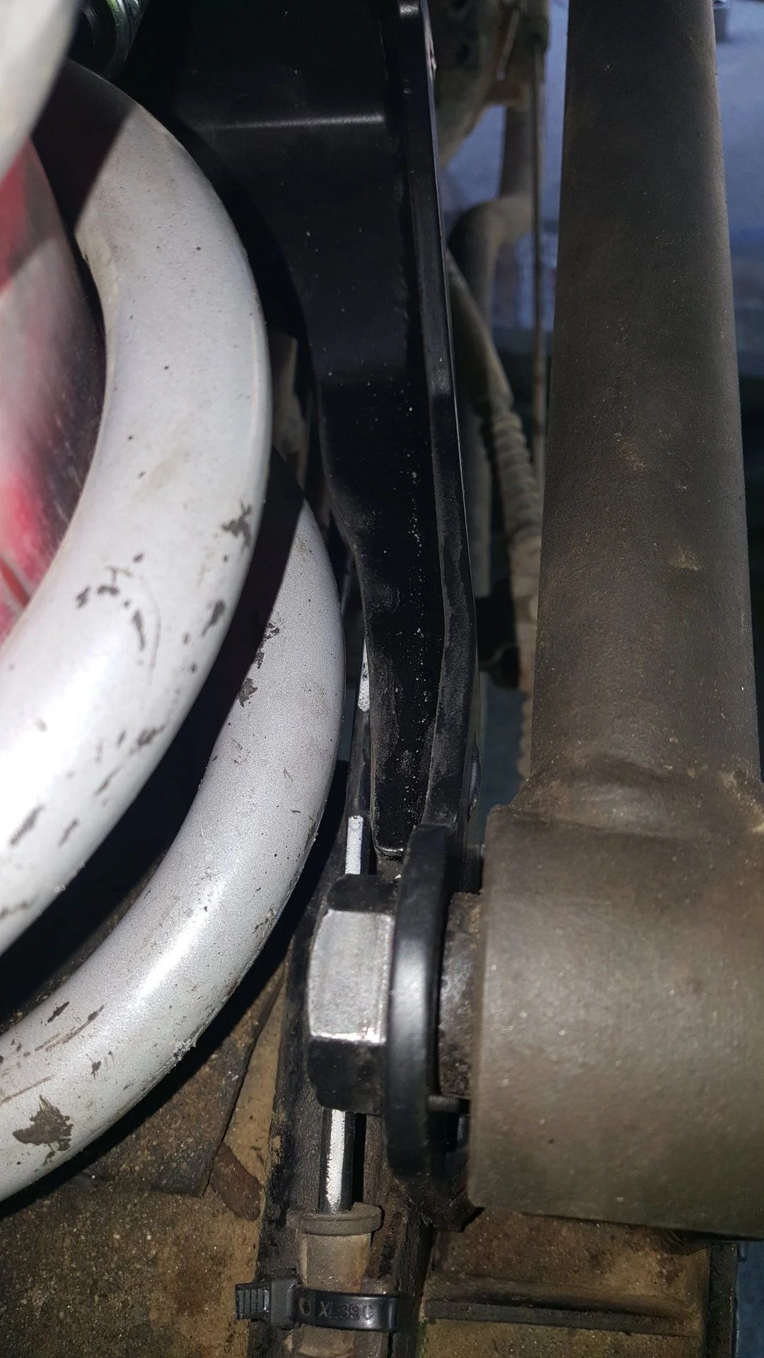

Pretty much the same exact issue I ran into when installing my bracket. Slinky heavy springs for me. I ended up cutting the bolt so that it was almost flush with the nut when installed as well as grinding down the bracket. Wanted to be able to remove the bolt, if needed, without having to remove the spring.
Even so, very happy with my bracket and I definitely felt a change in the rear end stability on the mountain roads near my home.

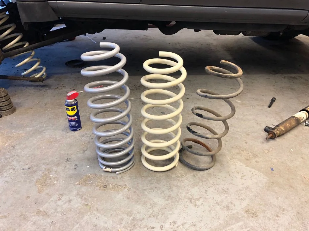

Alrighty folks, data dump time:
EHO sent a set of SlinkyHD rear springs over to our shop for test fitting and figuring out exactly what the issue has been.
UPON CLOSE INSPECTION, not one but TWO complications were found.
First complication will be detailed in this post, second in next.
First:

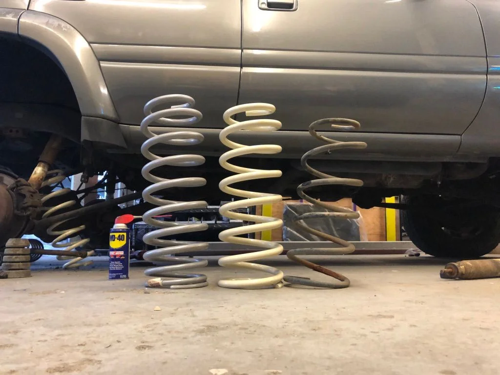

The wire diameters and coil diameters were found to be quite similar (obviously NOT the same, but close enough it shouldn't cause issues). Below, from left to right, SlinkyHD, OME 863J, stock
Looks quite different, yes?
Another view:
Went into this investigation with the obvious answer already in mind: the Slinky coils are MUCH great diameter, how else could this be causing an issue??
Well, wrong again honey...

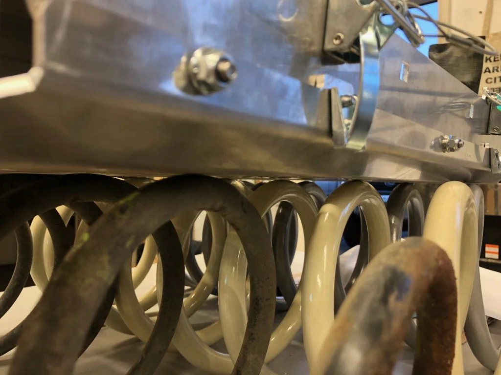

This picture is a bit busy, but found it quite hard to get the point across otherwise. It shows all three springs laying on their side on a flat table, with a very flat piece of sheetmetal bridging across the tops of all of them. Good way to see which spring is fatter.
aaaaaaaaaaaand....The SlinkyHD is narrower by a tiny margin, W. T. F. ?? (stock spring in foreground, then OME, then Slinky in the back)
What could it be?
Well, put one in a rig and measured and compared and tried to understand what was going on.
After a bit of head scratching, realized we were looking at if from the wrong angle:
It's not a width issue, it's a number of coils issue. That's why we don't have any issues when installing the ICON springs, and it's only an issue with the HD type springs. With the "too many coils" type springs, the coil is just farther down and interferes with the bracket.

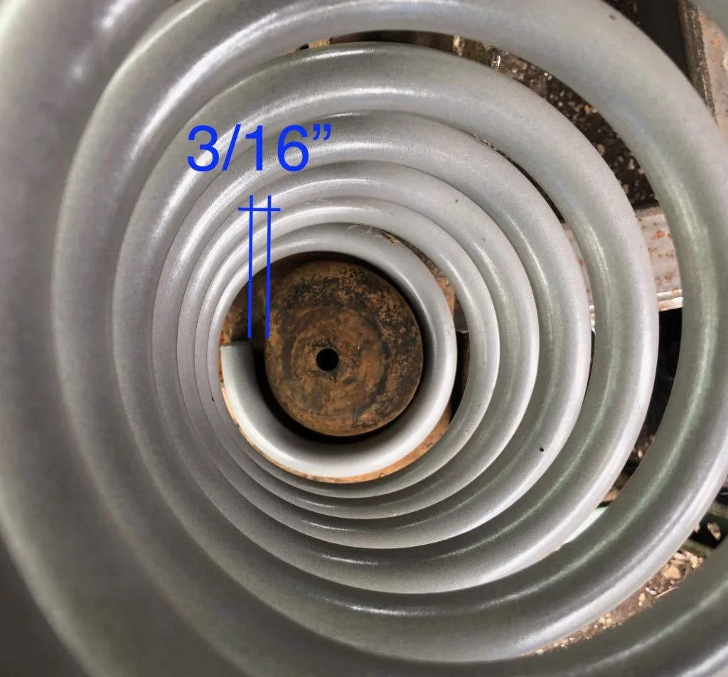

Second complication:
NOTE: THIS HAS SO FAR BEEN FOUND TO NOT BE SPECIFIC TO SLINKY, SO DON'T GO HATIN' OR ANYTHING
Turns out, making springs is a hot, sticky, mess most of the time (at least from my experience at springs shops). As such, the tolerances seem to be in the "good enough" range from what we are starting to see.

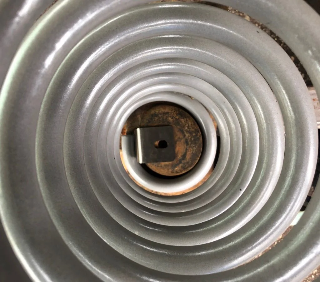

This leads to a situation where there is considerable slop between the spring and the spring perch it sits on:
Since some people are reporting less than a 1/16" of interference, it is quite likely their springs are pushed more torwards the front.

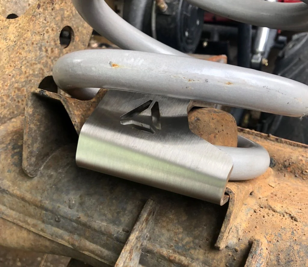

So why not make everybody's stuff sit in the same place? Seems like that might be a start, right? Well, in order to do that, we decided to make a little piece of stainless that goes between the perch and the spring, to take up any slop and force the spring as far forward as possible:
This little piece fits both sides (driver/pass) and bolts through that factory hole in the top of the spring perch.

Paired with the internal spring spacer piece, came up with a nice little spring retainer piece for the folks who are worried about the spring coming off it's lower perch "during max flex, bruh".
These little do-dads will be available as add-ons for the panhard lift bracket, as well as by themselves.

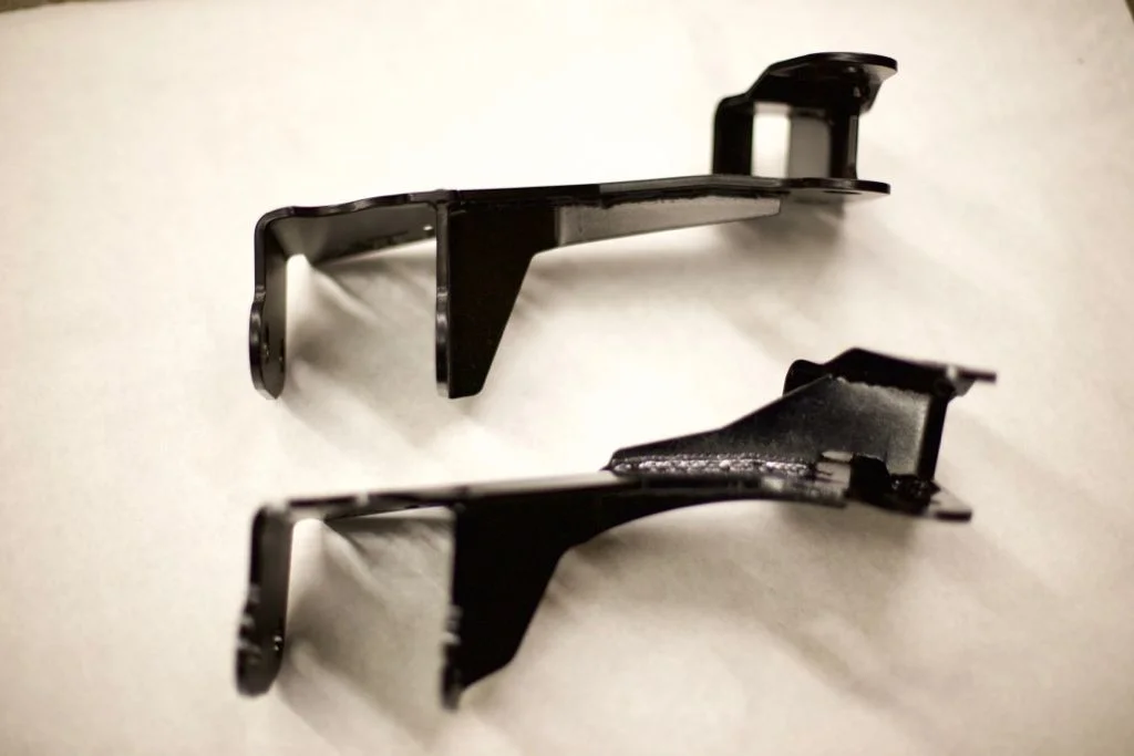

And after all that, JUST TO MAKE SURE, we put together a "HIGH-CLEARANCE" version of the PLB (the PLB-HC). It will be available for purchase soon on the site, but won't be shipping until after Cruiser Moab at the earliest.
There isn't a lot of difference, but there are more pieces, more bends, more welding, more design time, etc, etc, etc. Cost will be 285USD 265USD shipped free anywhere a USPS Medium Flat Rate box can go. Have shipped many other places, just not free.
Normal PLB will remain available for folks who have OME/ICON/etc lifts, or non-HD springs of whatever brand.
You can see there is now a profile on the spring side of the bracket, as well as an additional brace on the front.
Moving forward, these parts (PLB-HC and the spring keeper) should make installation and use a no brainer!

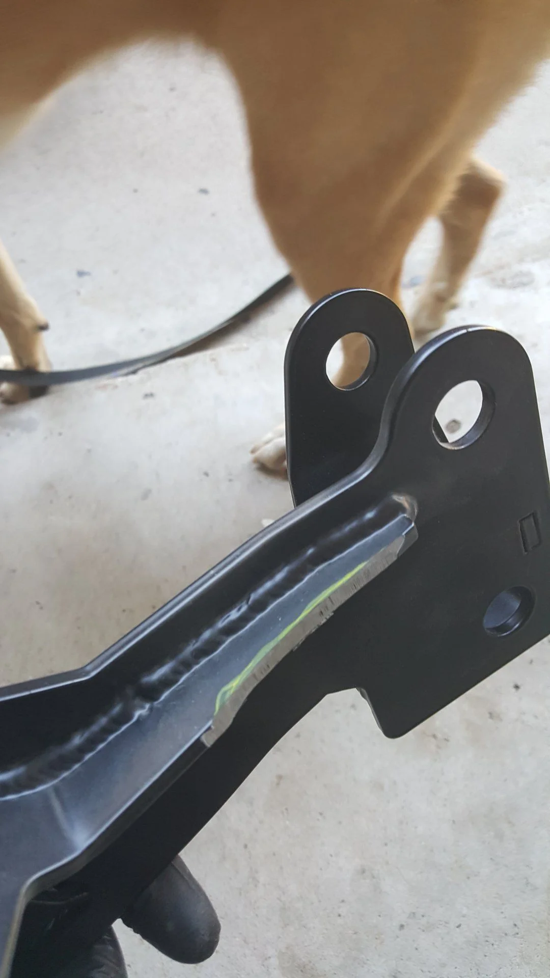

what about ones that are installed? mine is rubbing my spring, can i swap it out?
Probably easier to just spend 1 minute each with a grinding wheel and rattle can. One of these days I will install mine.
I dont the want to affect the structural integrity, they added a gusset to make up for having less metal in that area if you look at the pictures.
