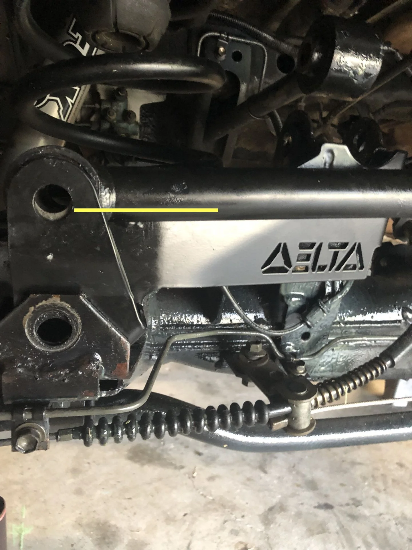

I'm sure that I've overlooked something stupidly simple, but I cannot get this top bolt to fit (yellow line). You can see in the picture why the bolt won't fit, only one half of the bolt will go in. I can move the Panhard to insert the bolt from the rear, but it contacts the stock mount on the front side. I removed the bolt and lined up the front (towards the spring) to take this picture.
I previously had the the stock bolt and Delta bolt in place for the other two mounting locations, no go either. Removed all bolts (as pictured) and the holes simply won't line up. I event loosened the passenger side of the stock Panhard bolt, no help. What am I missing??

Is the LC sitting on its own weight? Try a pry bar or another bolt to get the hole to line up. But most importantly if it is under its own weight lift the rear up but the wheels do not have to be off the ground.
The rear frame is on jack stands on both sides; both wheels are on the ground per the instructions. Should I lift the vehicle up more and see if that helps? I could use a drift to try and center the Panhard but clearance is slim on the spring side.
Is this what the instructions require an alignment bar for? I'm not exactly sure what that is.

Yes pretty much. I used a big punch to move things around. If you are able to move the bracket up a little it looks like it might line up then too. Also, did you move the ABS line that attaches to the bracket where the upper control attaches? I had fitment/alignment issues till I move mine, recently I just removed all my ABS lines for the sensors.
Yes, the ABS line was removed prior to install. @Delta VS you need to add that to the instructions.
