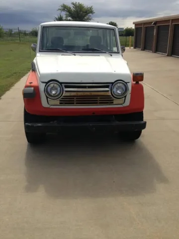

She sure looks sad with the busted eye.....
Closer inspection revealed a bit of either hardened silicone, possibly JB Weld having had a firm grip on, at some point, so I don't feel quite as bad.
The entire affair has me thinking of 70 signals to potentially swap, but before I'm tied to the stake and burned for heresy, will mock up and get the blessings of the Sty. :)
I have never liked the looks of the 70 series lights on the front of a Pig...
the set I bought several years ago are back in the box they were sent to me in. they look more better there. Lemme know if you wanna try em; they're yours if you do...
Hmmm.....
Appreciate the offer, but sounds like its been tried and a fail.
I believe it was the Pig that had a Tiki JK interior with a chopped roof that had the signals/side vents removed, and don't recall being fond of the look.
Have seen the early grille signals being all that have been utilized, but I've said many time the fender placement signals is Pig-ish, so thinking I'd regret removal (plus get all kinds of grief.)
Hopefully the repros have crappy plastic bases that break easier.
Hmmm.....
I have given thought to using 1970ish VW bug front signal on the fenders...or some really cool old cast aluminum big rig markers...something with a sort of tear-drop shape that won't get snagged, but work like a slider...I know:meh: outstanding in my own field
I concur!!
When I was entertaining the idea of building the now dismembered 71 parts Pig into a wheeler, looked at removing the signals and rear marker/vents, an effort to minimize future destruction.
Since any vehicle I own remains streetable, street legal, thought about cutting the grille like the earlier for signals and doing away with the unnecessary, legally speaking, rear markers (going to on the 80. They beg to be destroyed, and don't know how I've managed to not oblige).
Before completely discounting, is removal of the fender signals a punishable offense?

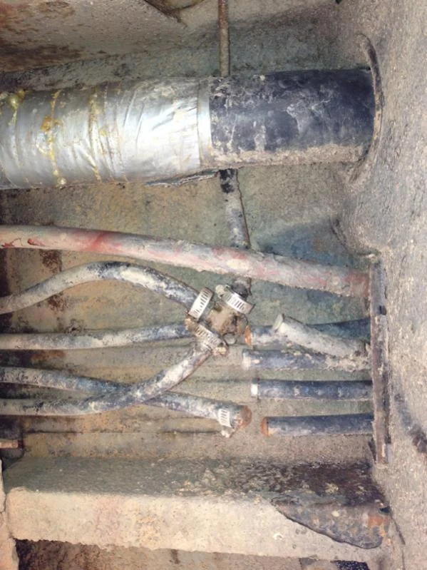

Attempting to pull tank and radiator to treat, in an effort to prepare for mechanical.
Cursory glance, and it appears we've endured some bypassing, before.
My question is, should the bypass remain, or should it be reworked as intended originally?
Only ask, because if it should remain, can't help but think there's means to clean up at the tank, eliminating this mess of crap.
Edited: it's hard to tell in pic, but more creativity with utilization of expansion foam and, of course, duct tape.
The line must've had a hole, be it part of a bypass or from age, and it was corrected with foam and duct tape.

Hell yeah!! I bet there is some chit held on with bailing wire too!! You can save the world with those two things alone! ;)

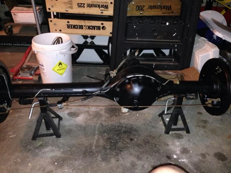

Please explain what implications the split case has on this.
There's no provision for an ebrake on a split case, so you've got some options:
  • Non-US split case outputshaft/drum: Unobtanium
  • BTB disk ebrake conversion: Crappy at best
  • Late 40/60 drum integrated ebrake: What I'm doing
  • Eldorado disk calipers w/ integrated ebrake: Mixed reviews
You can't put the integrated drums on a 55 axle, they have the early 6-bolt flange instead of the later 4-bolt. I sourced a crusty late 40 axle and rebuilt it, so now I have a surplus ;) The '79 was the only 55 to ever come with 3:73 gears stock, so it's pretty rare?
