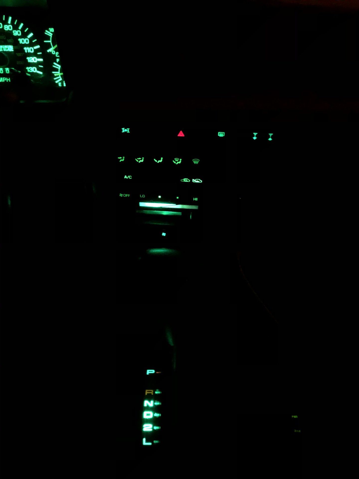

I used the type 74 equivalent from diodedynamics.
It’s got a hot spot under the N D 2 indicators but isn’t horrible.

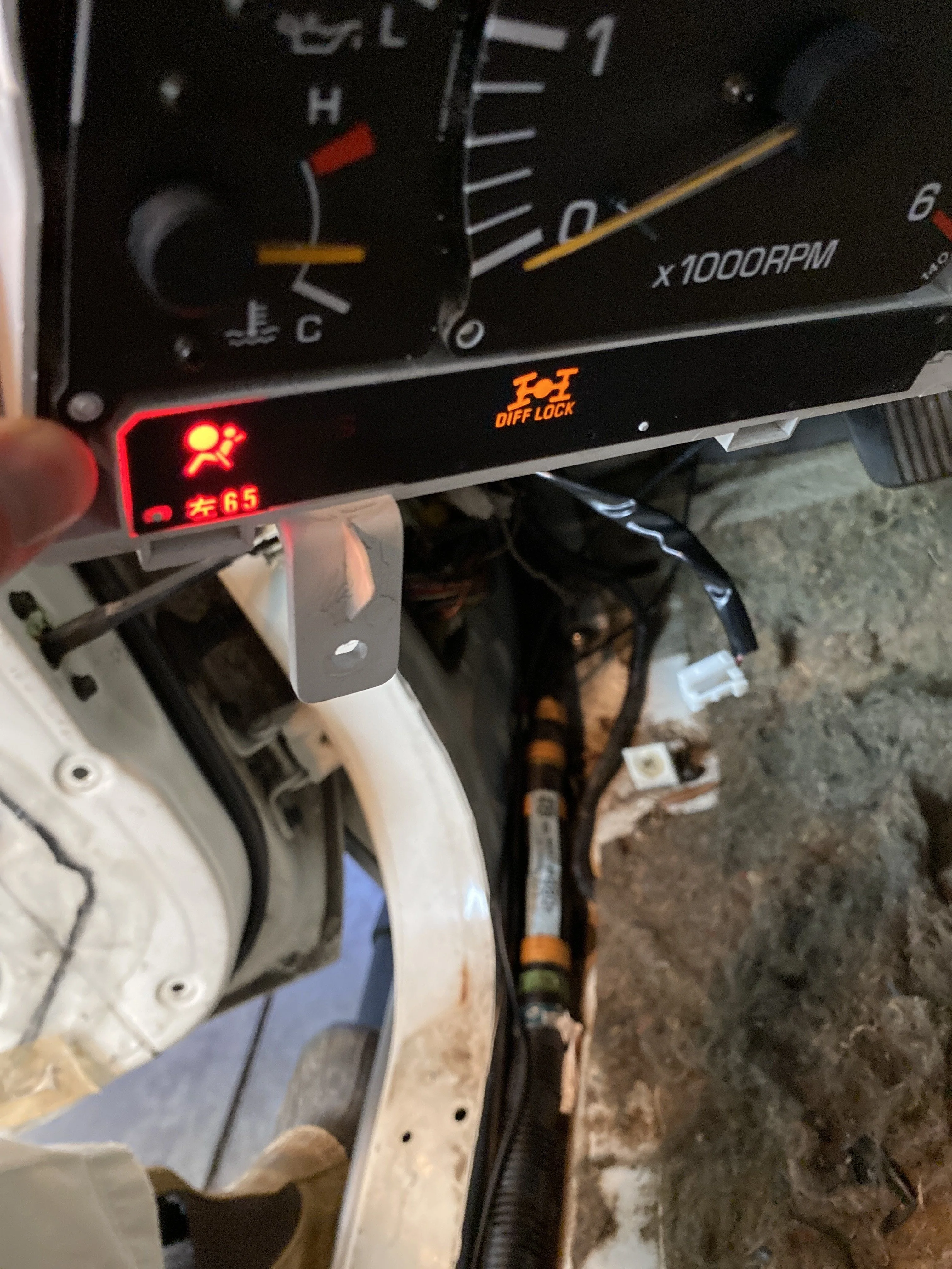

I was fortunate and the park and so forth only come on when they are suppose to. But this light won’t go off. Any suggestions? I may see if I can find an oem bulb if that will help. when I put the truck in 4wd low it does get brighter, but is always on otherwise. It’s the only light that seems to be doing that after putting in leds.
I really hate to be this guy because I can't stand it when people do this, but it might be better to find out the reason the light is coming on. I can't recall that light on my 80 series, but it has never come on. I have detached and re-installed an airbag too. As a matter of fact, I am pretty sure I have driven around with the airbag out for a while. Could it be something as simple as a fuse? The sensor in the 80 is in front of the gearshift. I would think it is in a similar place in later models. My experience with airbags (I deal with them as part of my job) is that they can go off in extremely inopportune times when f'd up. If the light is on, I would figure out what is going on, or if you don't care if the AB is working, then it is super simple to take the wheel off and disconnect it permanently. Just look up how to do it right. It is a redundant safety for an electric charge to set off a small explosive so keep ground and static in mind. So far, I have never heard of anyone setting one off by disconnecting it though. It might at least lead to the light issue.
