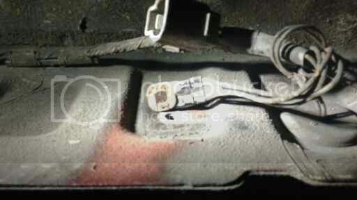

take a look at this plug in the DS quater panel area... it had a couple nasty pins in it that was causing my problems... i actually had to jump one wire around the plug...
Do you have trailer wiring? If so check the adapter in the rh rear quarter panel and the wiring under the truck.
So I did like itbrokeagain said and took a look at the ground near the trailer hitch:
pic doesn't show it so well, but it was plenty rusty. hit everything with the wire brush treatment and, well, so far so good! went from having to smack the tail light a few times a day to no problems in 5 days so far.

Well, as promised I am posting again as the DS brake light is going out again. Planning to use mirrors today to try and see what the heck we are missing behind that panel. The connector that gothodgie shows in his picture above will get another good look, but I recall that thing looked plenty clean. Plus, I seem to remember wiggling that thing around once while the light was out without success, yet the smack on the outside did the job. Sigh. Will update as I go. Thanks.
