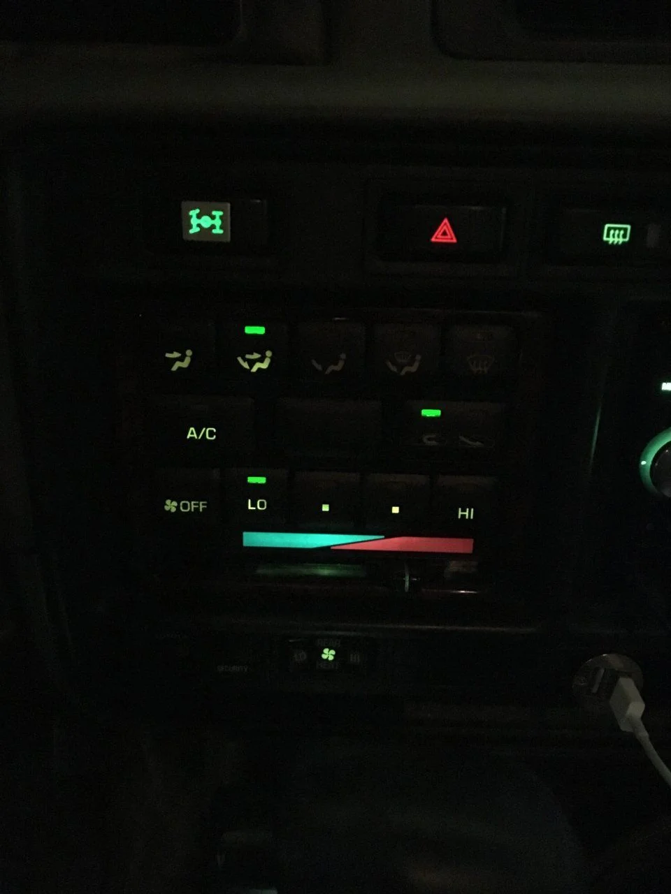

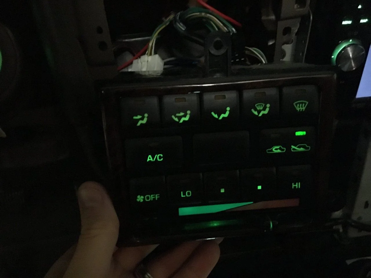

Thanks to @jcardona1 this is the list I'm using but I'm not doing LED
I replaced the AC lights with green...I decided against blue since the cluster was going to be blue. I like the green in the AC bc it isn't super bright....looks good.

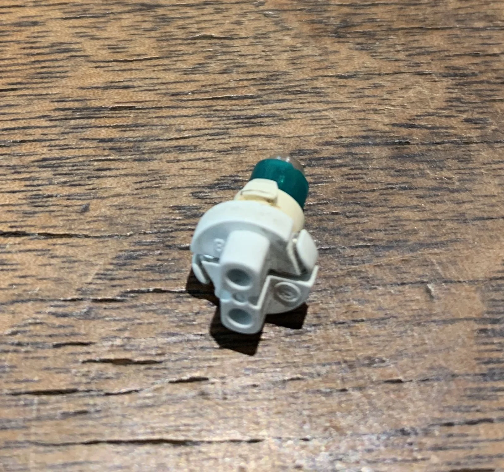

Hi,
I'm looking for a similar bulb for the lights in the heating console of a LC 1997 80 series collectors series. Bulb is 10mm wide and 15mm tall. Any ideas on a model number and where I could find this in North america.
Thanks

Does anyone know the small light type/size in the defrost button? H4 button? CDL button? Believe they should all be the same. thanks.
Got my answer. thanks

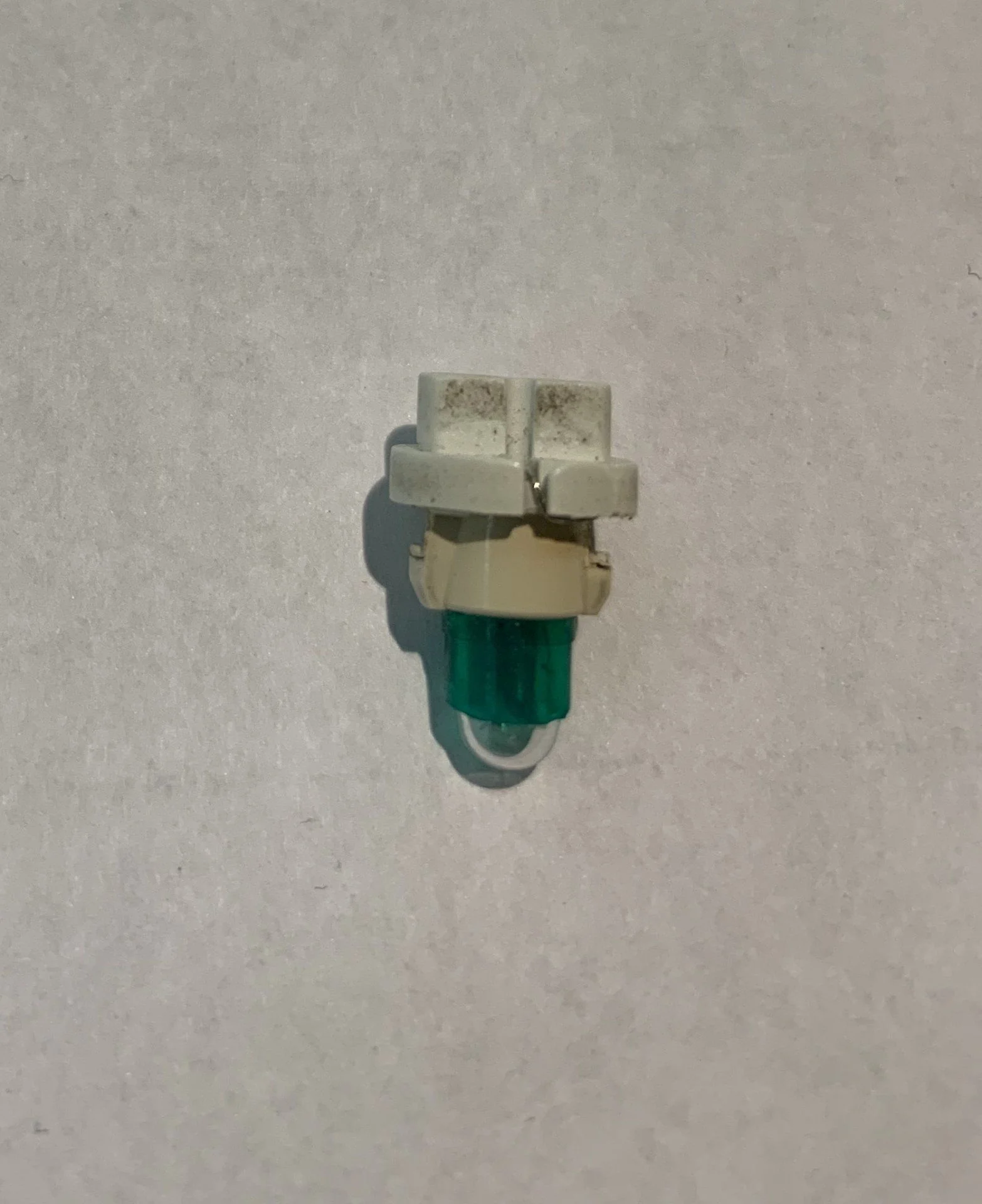

Hi,
Thanks
Duncan
Seeking this bulb as well. Any help would be appreciated. Took the dash apart to sort out a heating issue - never knew a few of these bulbs existed as the PO had removed the socket and folded it back into the dash cavity. Now that I have it all apart, I figure I ought to replace them.

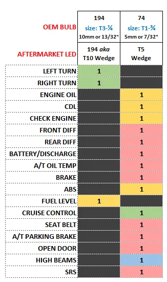

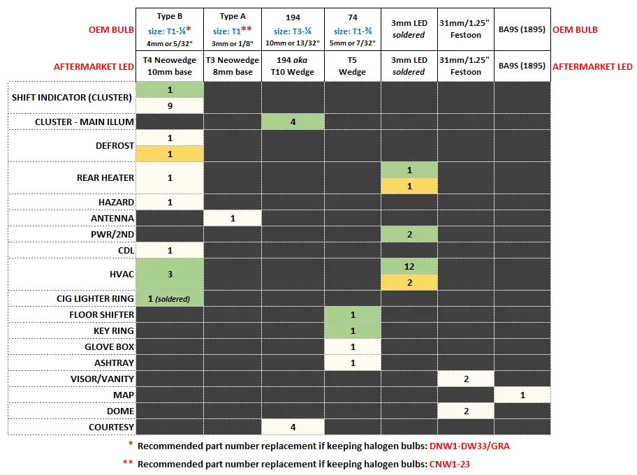

Hey all. My 'D' shift pos dash light has died, and was considering changing to LEDs while I'm in there replacing it. Can anyone confirm in this fantastic bulb size chart that the "shift indicator (cluster)" is the PRND in the dash between the rev/speedo displays? Want to be 100% sure before I order parts and pull my dash out :) Cheers!
…and also, are the PRND lights different coloured GLOBES or does the dash have the coloured transparent that control the colours, i.e., should I be getting white globes for here?
That chart is wrong. Easy example is the cluster illumination is not a 194 but a 158 bulb. The 158 bulbs also have a green condom for color I just replaced all my bulbs in my 94 and the PRND in the dash was 84999-50180 or 90072-02005
There were 8 white bulbs and 1 white bulb with green condom. The green bulb is ambient light while the white bulbs light up the indicators which are colored from the display

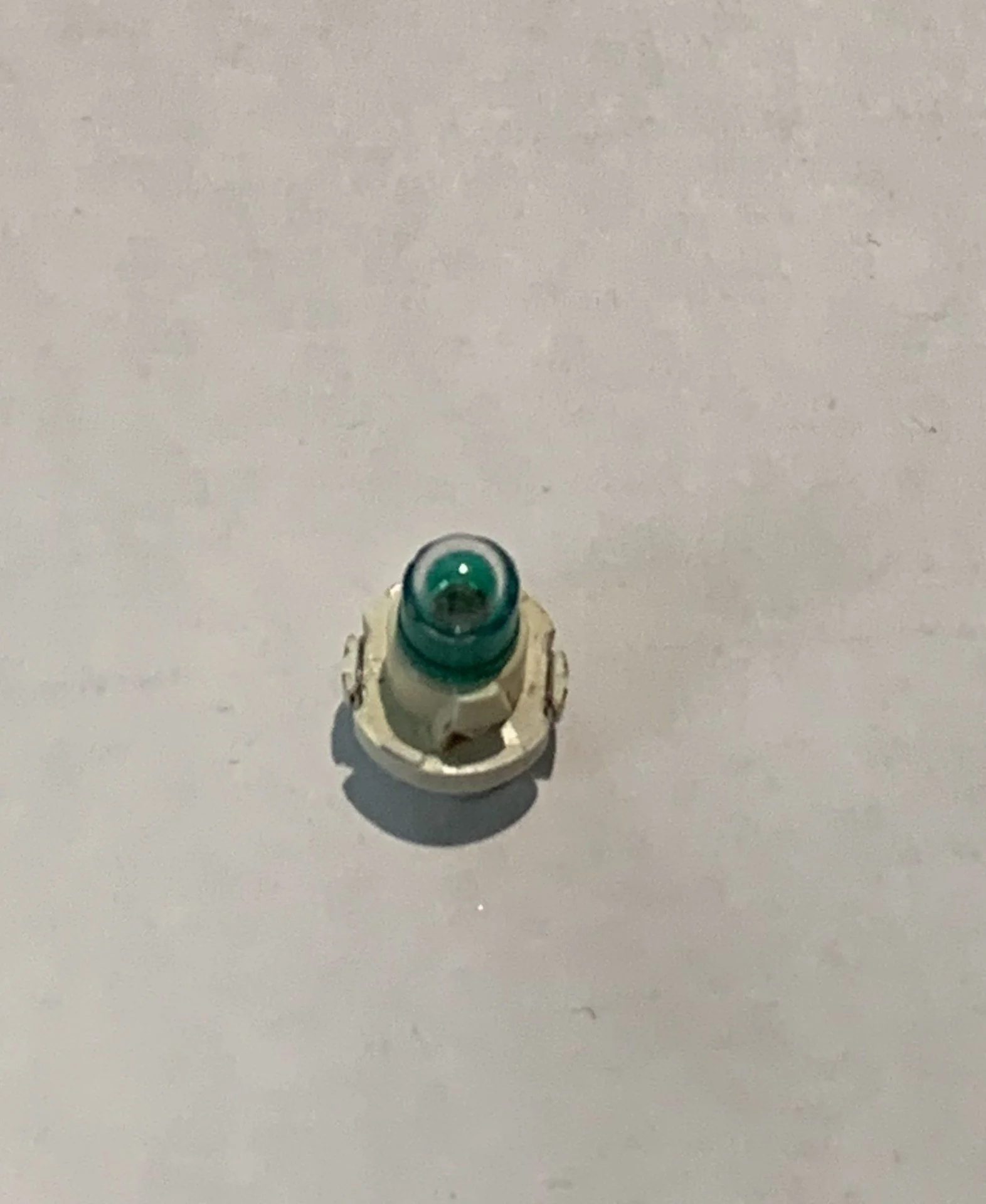

Check this out.
Yes, the shift indicator is a t4 neowedge. For a couple bucks on 90072-02005, why not stick with OEM? It's been noted before that some Amazon/etc bulbs don't fit quite right (happened to me with the small 74s) so many folks use autolumination or superbrightleds for aftermarket.
Not about your question, but - having changed the 4 cluster bulbs with standard and LED a bunch of times, the 194 listing is not exactly "incorrect," but I assume 158s were factory and what you get if you buy OEM** They are the same physically, but 194 is just slightly higher wattage. I have never used 158s as replacements, personally. Both work - I don't recall hearing issues with standard 194s in a Toyota.
**If you want to keep the SAME factory green on a clear bulb that uses a colored cap and can't save the original cap (they can be fused to the bulb & brittle) just buy OEM. I've tried every green/lime/yellow/etc aftermarket cap I could find, and none are the same. Too saturated, mainly, but that 90s OEM lime green is just right.

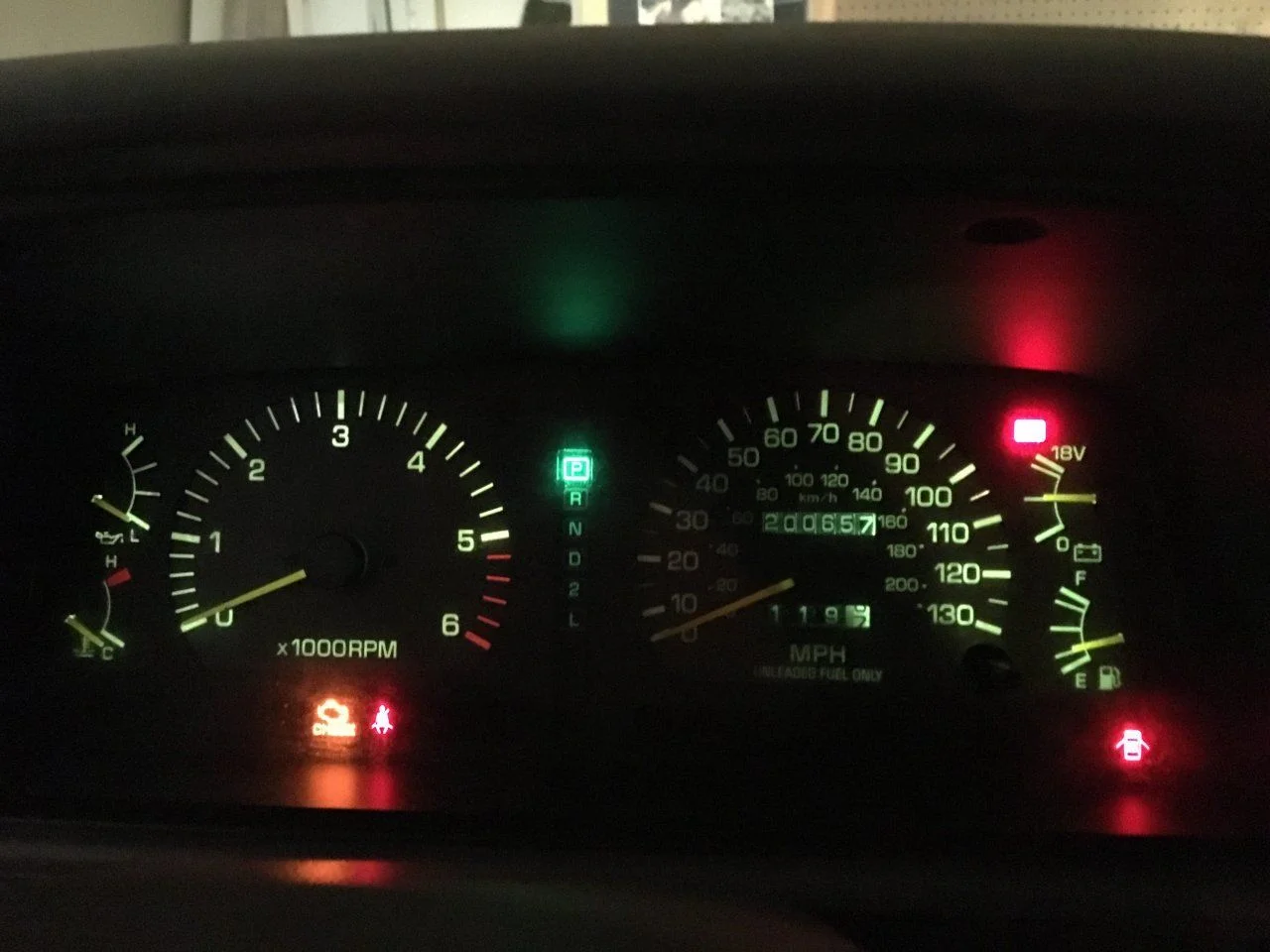

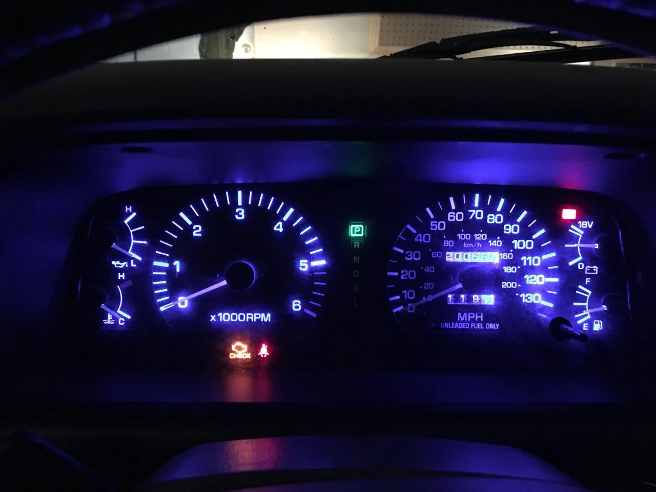

I have considered replacing just the OEM bulb, but having not removed the dash before I feel it's a big task and therefore wanted to replace bulbs with LEDs so I wouldn't have to deal with it again. I quite like the idea of a generally white dash cluster over the lime green, BUT I do particularly like the emerald green of the P and D. I've read that the quality LEDs are dimmable, which is important if I decide to go white for the cluster. Last thing I want is to be blinded by the instruments while driving at night. I have the luxury of the 80 being a second car, so can leave the dash out for a few days while I try LED fitment and reorder parts if necessary.

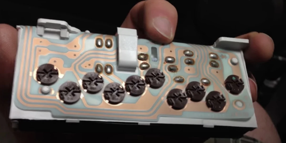

Related, has anyone found a diagram/explainer on the PRND cluster and which bulbs affect which letter? There are way more bulbs that letters and arranged in a weird, stepped (?) pattern:
Note, that just because an LED is dimmable, that's doesn't mean it's a great choice, as I learned. The ones I put in are WAY TOO BRIGHT, and if I dim them down enough, then the rest of the dash is basically unlit. One of these days, I have to go back and put in dimmer, dimmable LEDs (which I have now, but haven't gotten around to), or maybe just go back to incandescent. Or, you have to replace EVERYTHING in the dash with LEDs.
I made this grid when I put LEDs in, which might be helpful:
