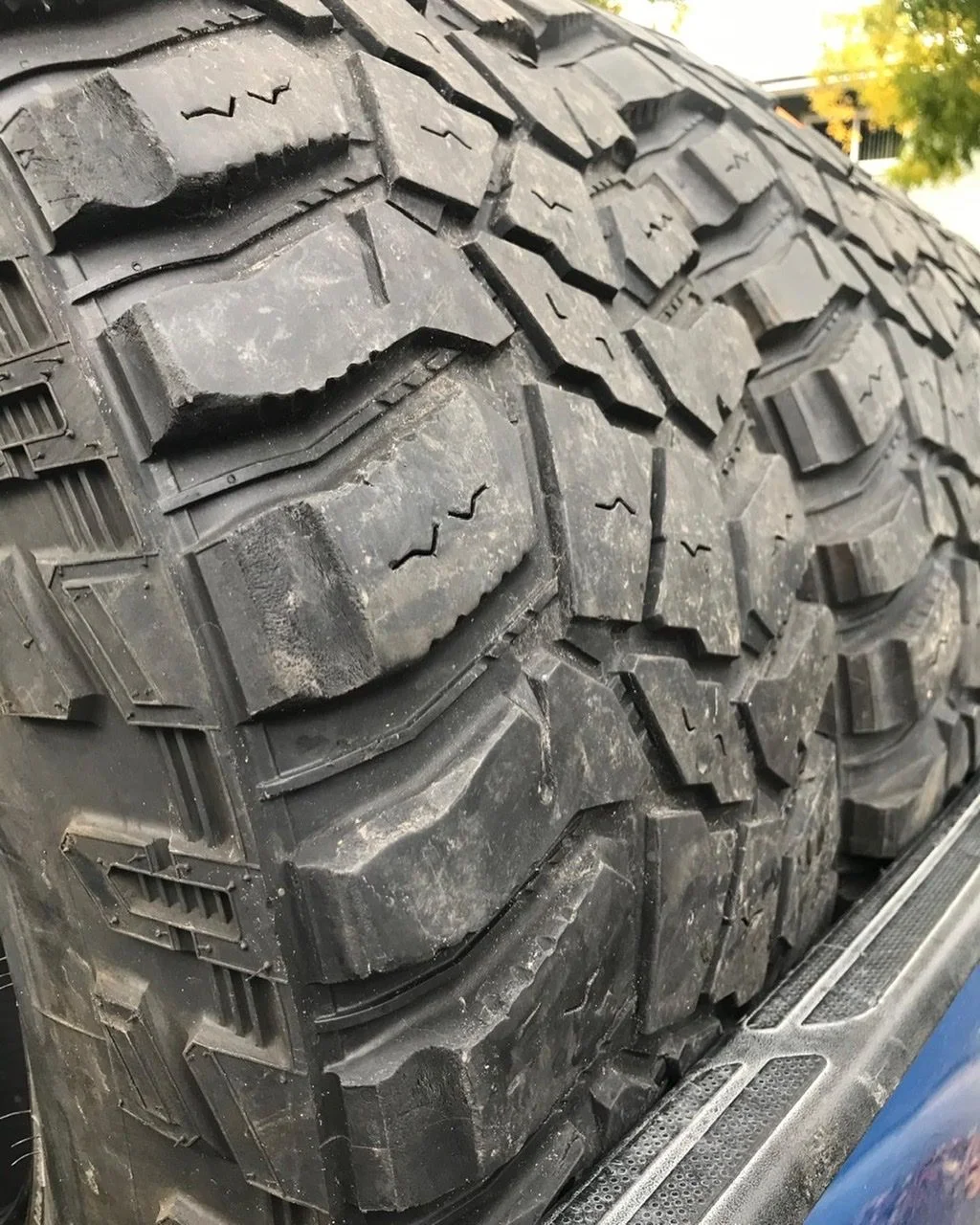

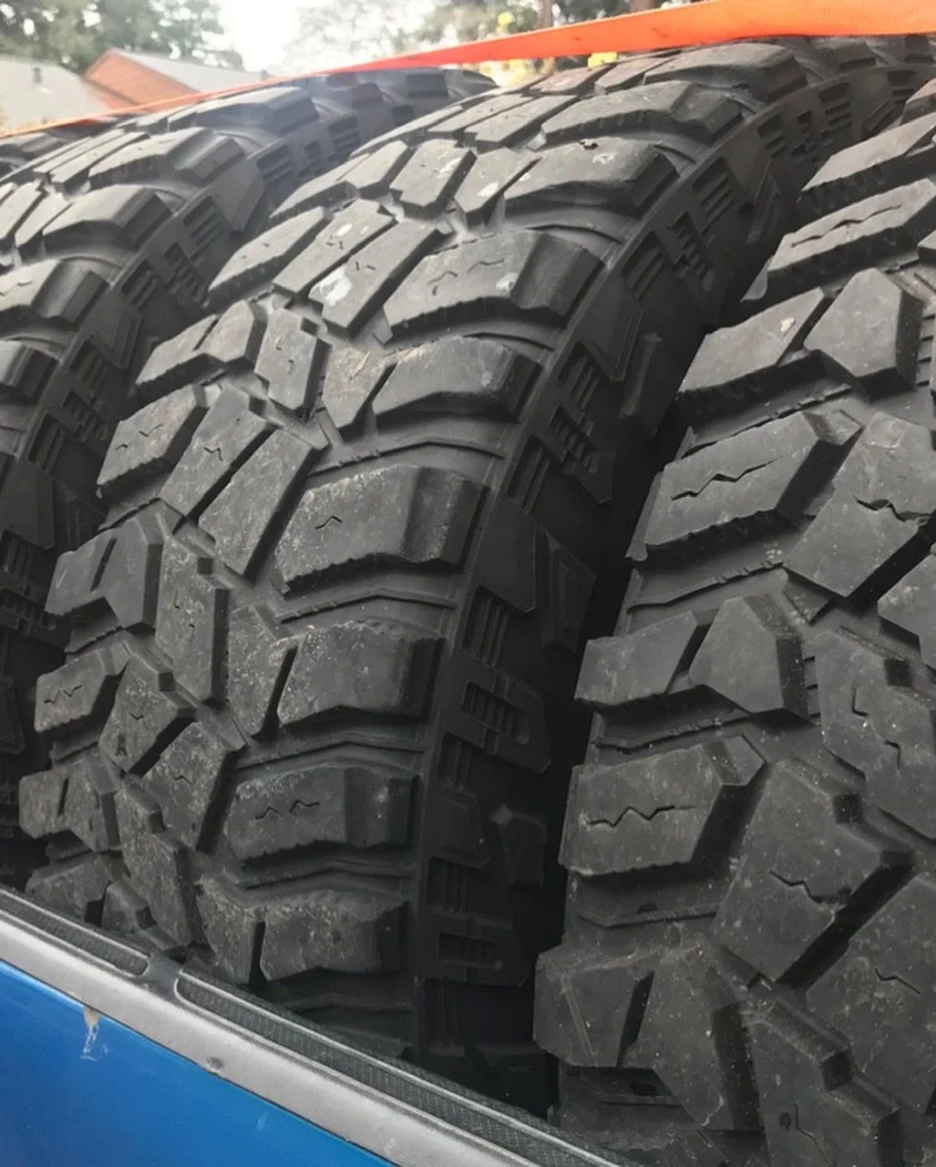

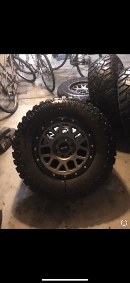

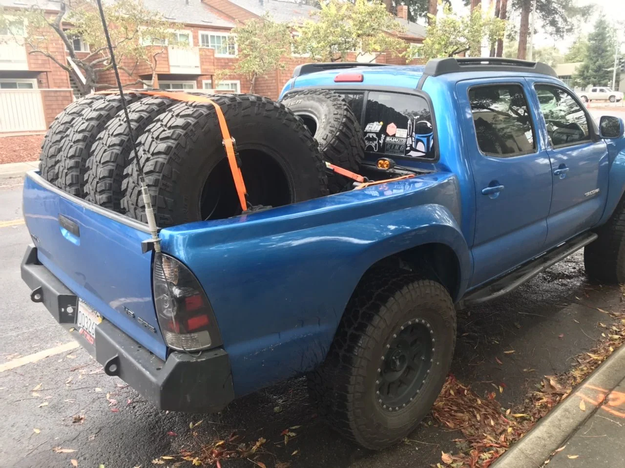

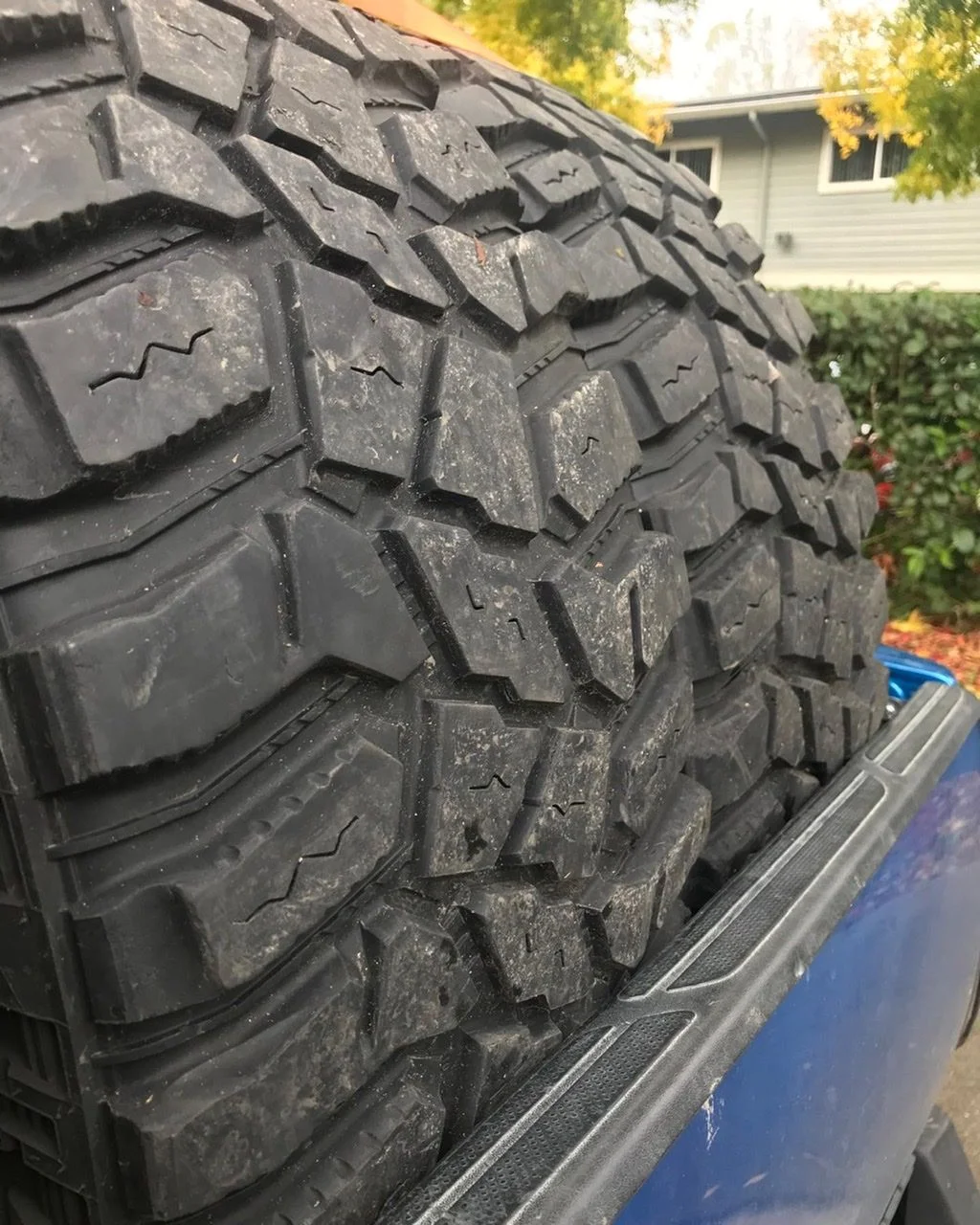

@BayArea80 found me an awesome deal on these 315/70/17 Cooper STT Pros - 5 for $75!! Dude had no idea what he had lmao. These aren’t pretty or ready for more than maybe 8-10k miles, but they should hold me over for a couple months while I sort out the rest of the maintenance. Anyone got a set of 17s for sale?

I recommend replacing the knuckle studs as well. Those could be gotten fron wits end. Btw those cooper will be LOUD, I have the same set on my truck.

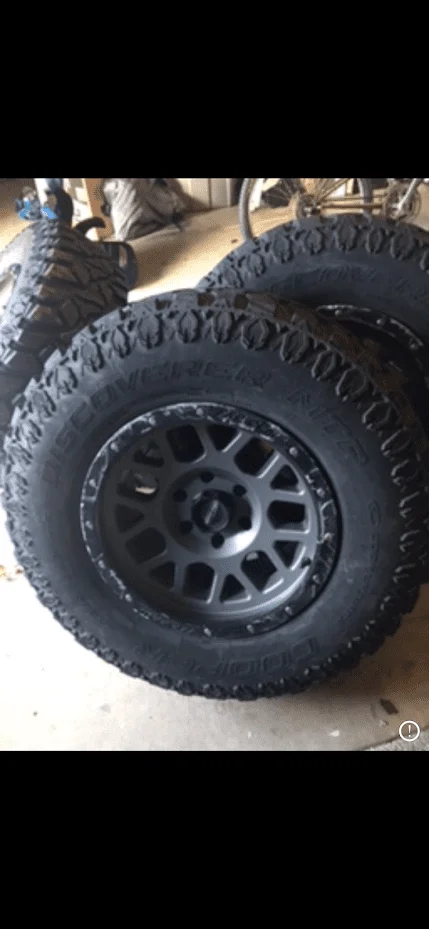

My buddy had a spare set of rock rashed Pro Comp wheels. He let me have the set of 5 for 250, so all in I've dropped 325 on a set of wheels and tires to hold me over for a couple months. The deals just keep rollin' in! (See what I did there?)

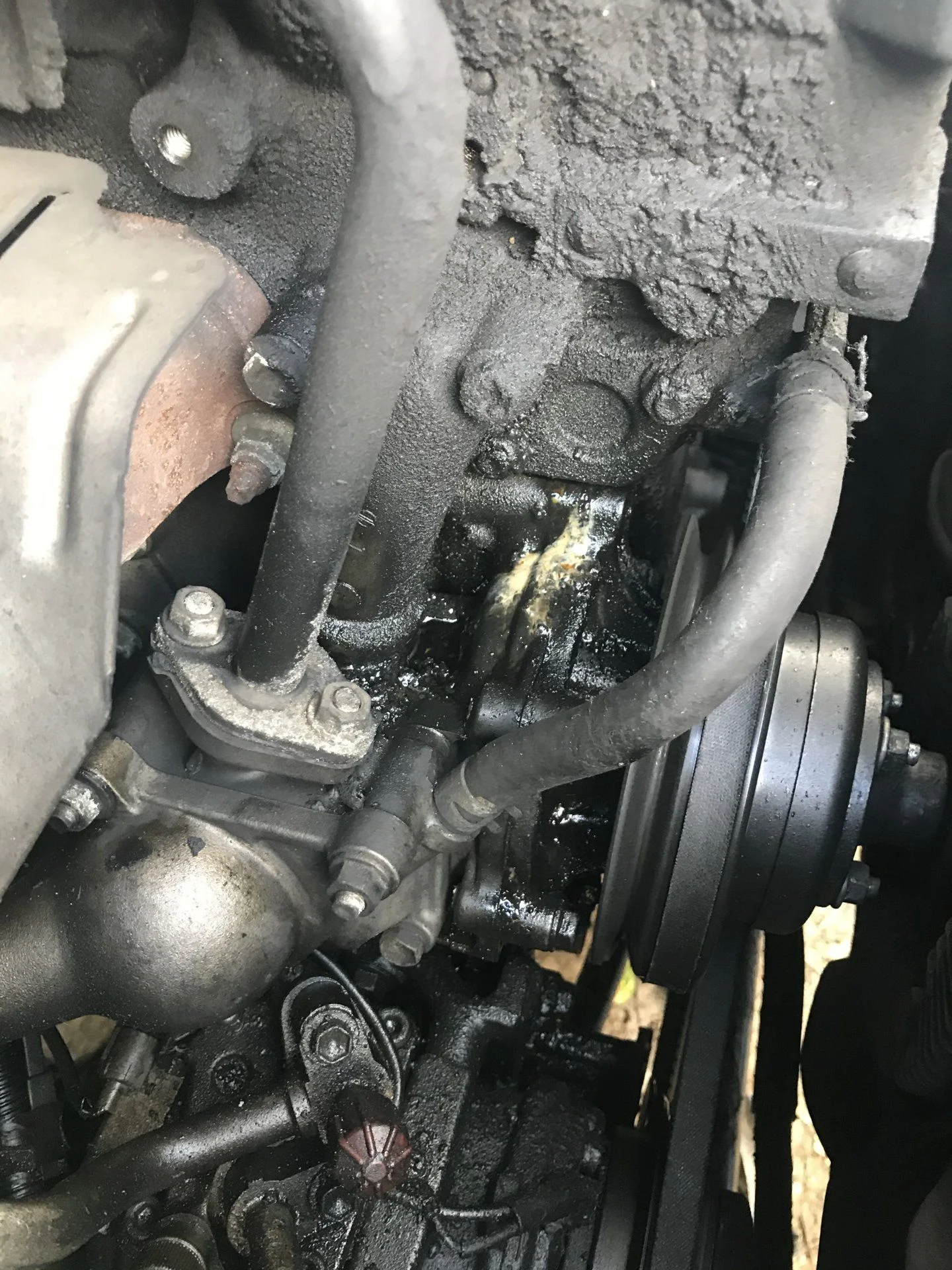

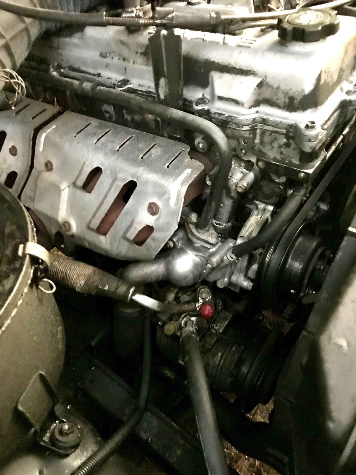

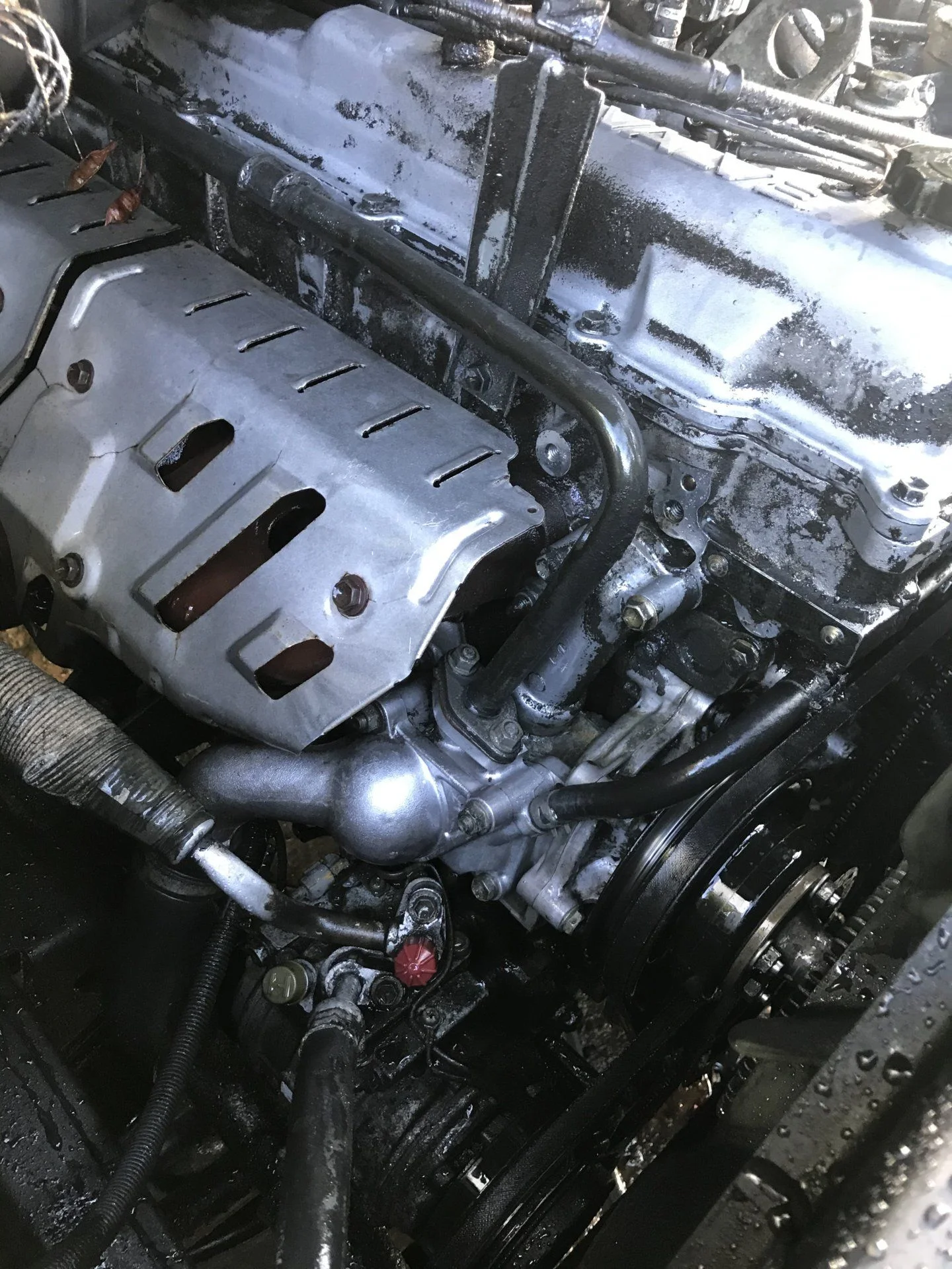

I discussed the concern with my toyota mechanic buddy. He said these old girls do that when they’re cold I guess. After letting her warm up it actually went away. Gonna keep an eye on the coolant and oil to see if mixing. Currently both look clean actually, but gonna keep a close eye. Also, bottle of simple green goes a long way. Let’s see what shakes out.
Comparitively speaking the water pump seal and the thermo are easy to get to and replace. One of the nice things about the design that i appreciate. I changed mine while doing some other coolant refreshes and it was very quick. I like changing pumps on my schedule not theirs.
I don't think i would do it until you get around to replacing hoses and doing a good flush though.
