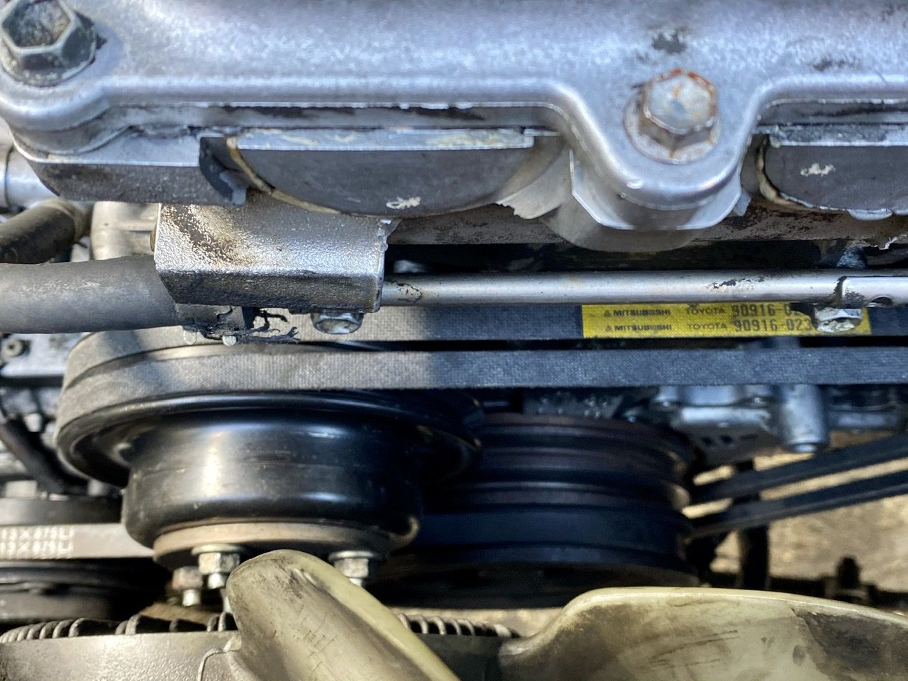

2) New OEM belts (all of them lol, thanks @BILT4ME :cheers:)

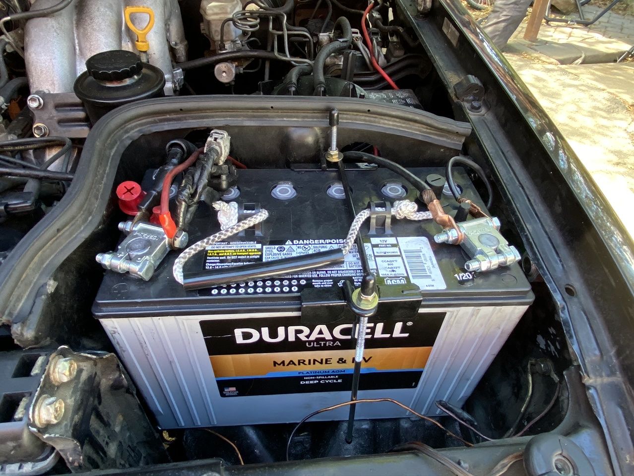

4) New group 31 Duracell AGM battery and @LandCruiserPhil battery tie down

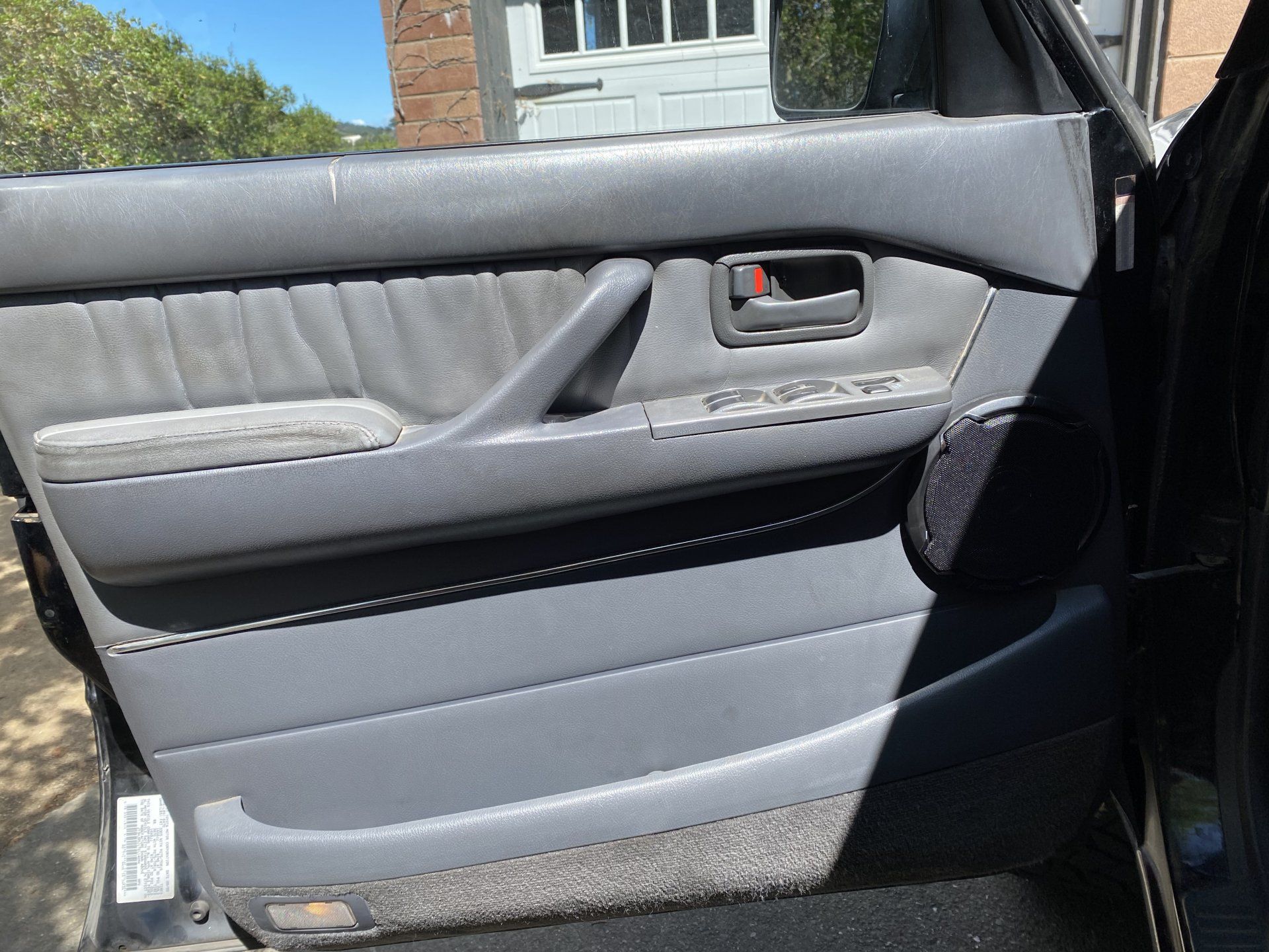

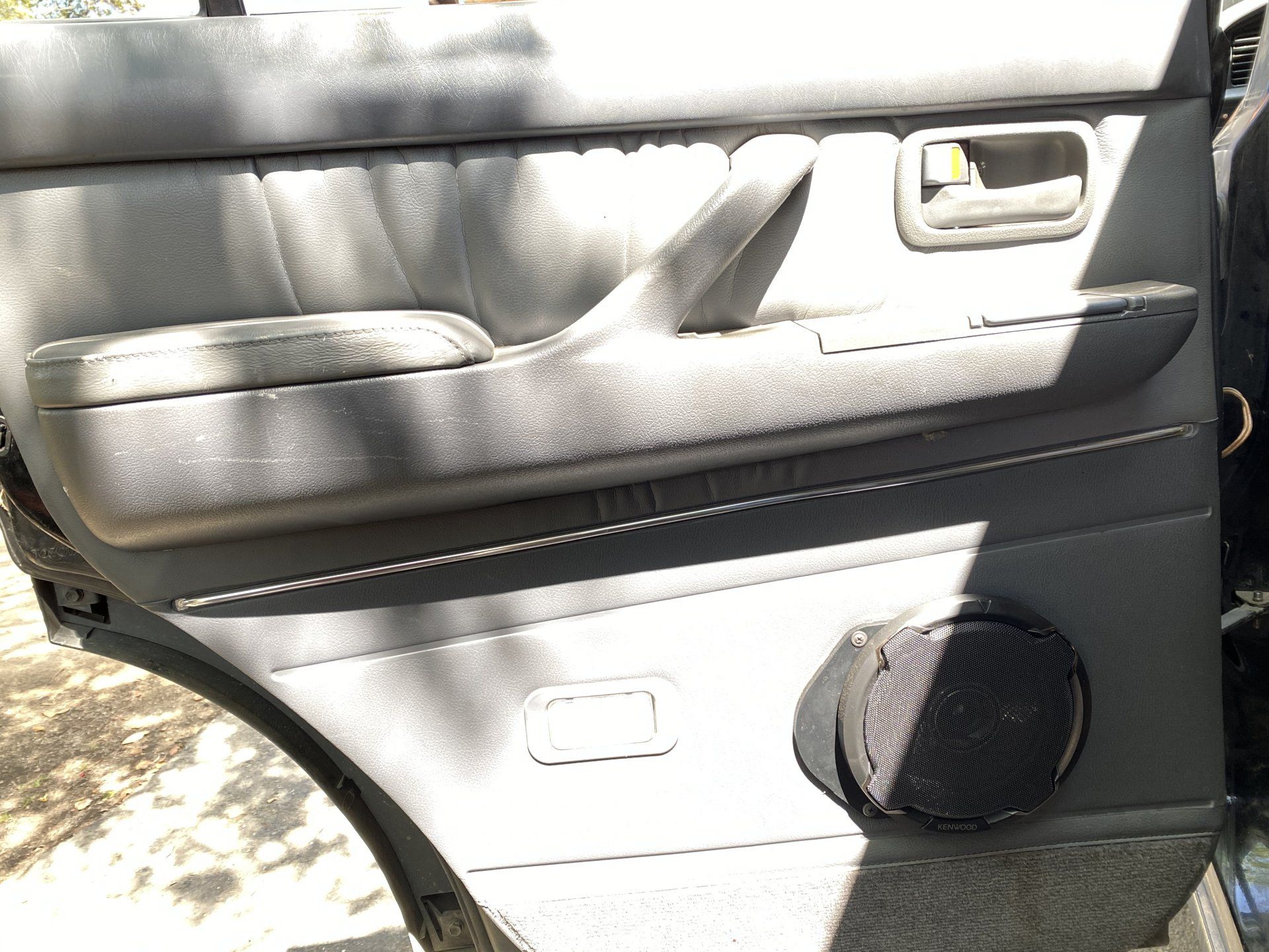

5) Had an audio shop clean up and dial in my sound system with some custom mounts for 6.5” speakers in the front and rear doors, as well as a wood panel in the back to mount the amp and Alpine 8” sub

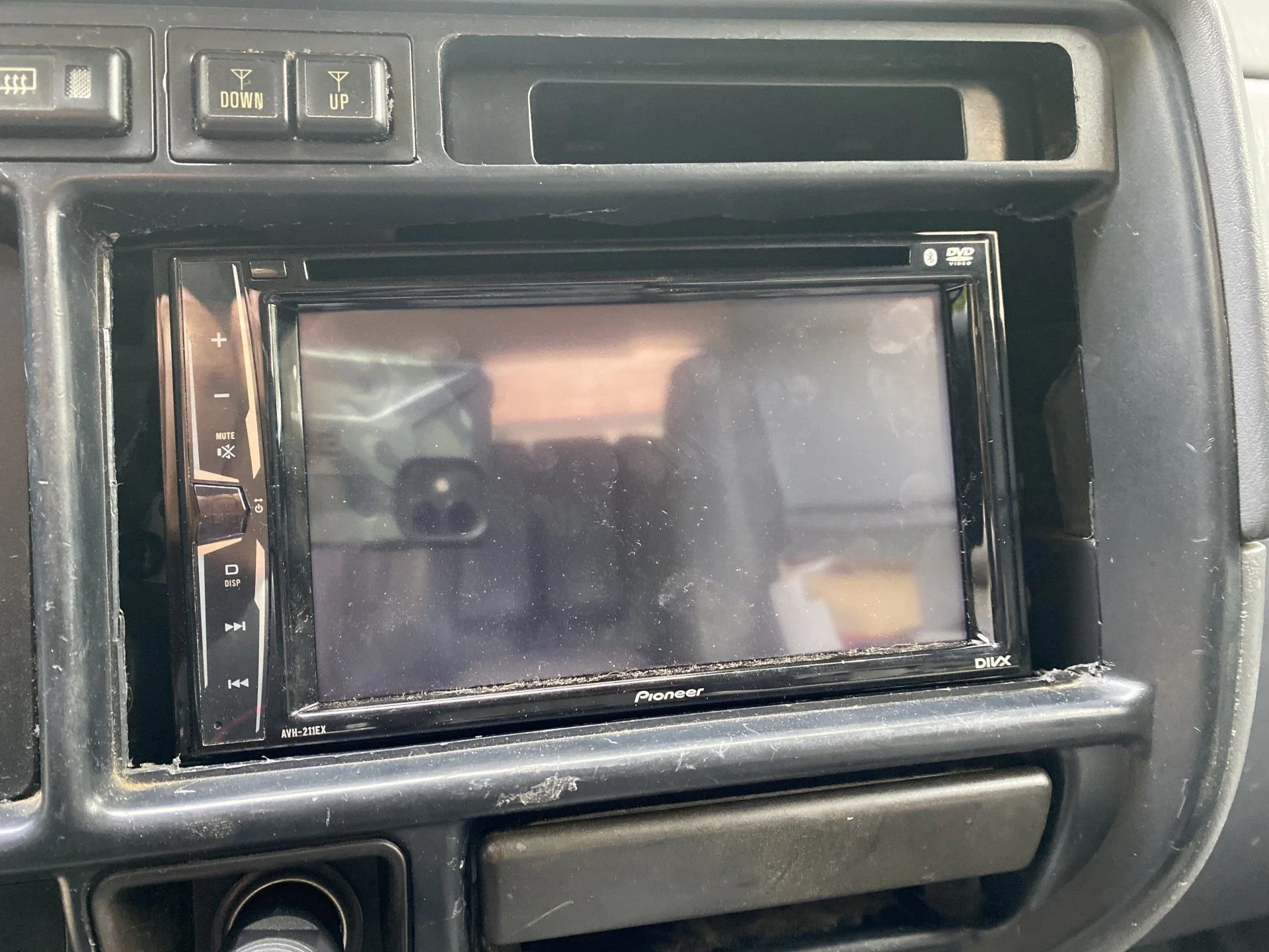

Also, the prev. owner hacked up the double-din surround, so we couldn't get a fit kit in there...it also looks like s***. One day I'll replace all that stuff.

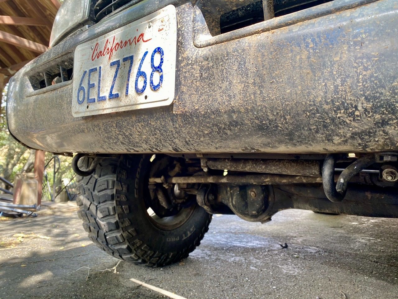

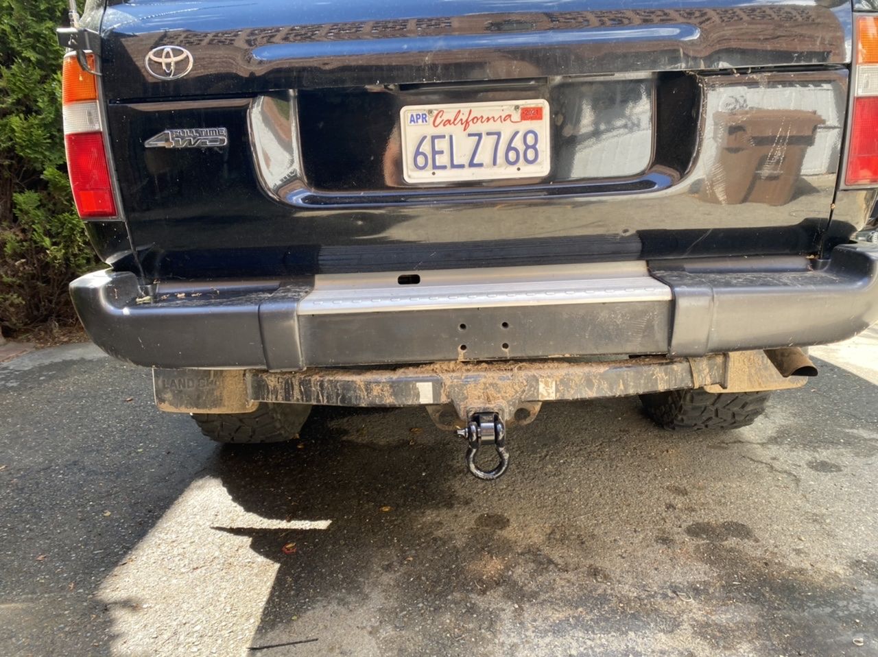

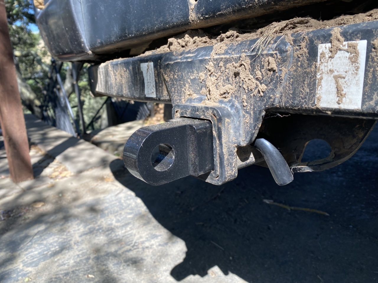

During this trip, I found out at the wrong time that the p/o removed the front OEM recovery points smfh. When I got home, I was happy to find out on the forum that you can relocate the rear points to the front, so I grabbed some bolts and washers from my local Ace and did just that. I bought some more D-rings and a hitch recovery point from Rhino, whose products have worked great for me with my Tacoma. Gotta figure out another way though because that trailer hitch sits waaay too low
If you find something post it because I've been trying to find best recovery points w stock rear. I took off hitch so no longer have the hitch shackle. My rear points are gone so was thinking about just buying a pair of those.
I'll definitely do so. I may end up doing the same by just adding some OEM recovery points and removing the hitch
The rear receiver is also known as your rear slider :) they are very low for sure. Looks like you made some great progress and are in the enjoyment stage. Congrats!

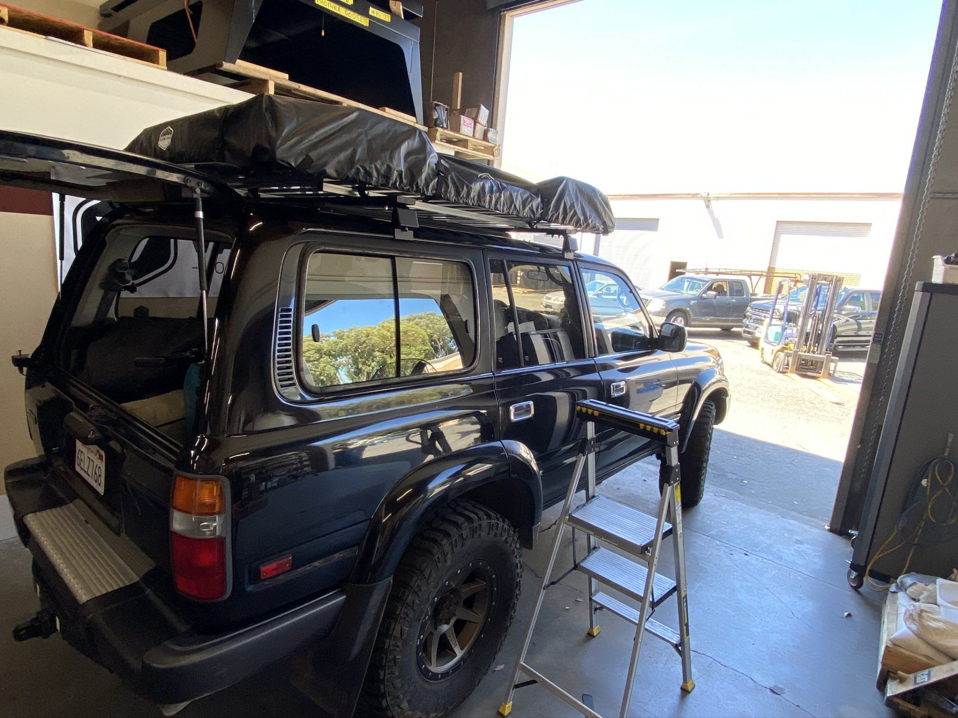

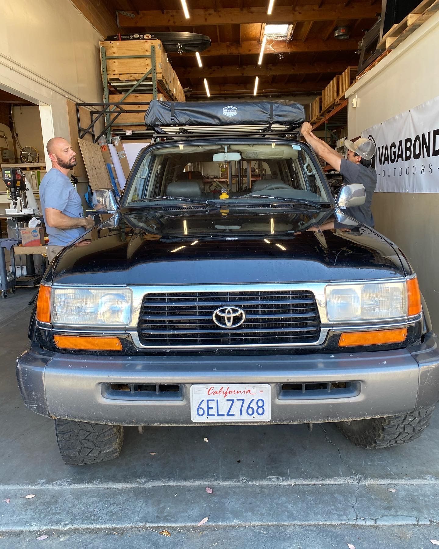

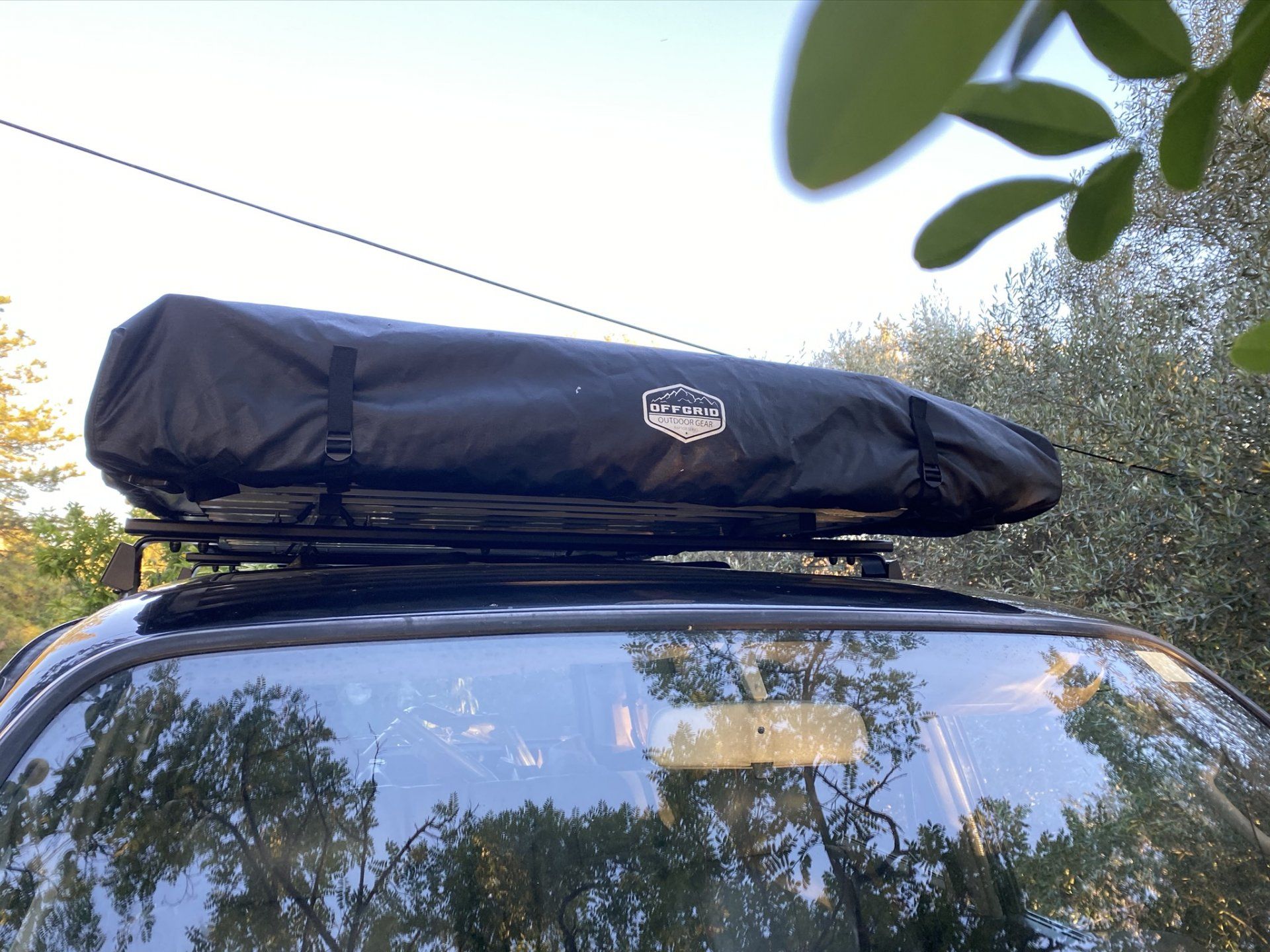

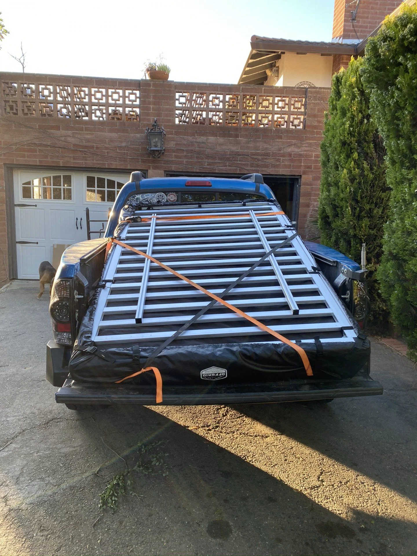

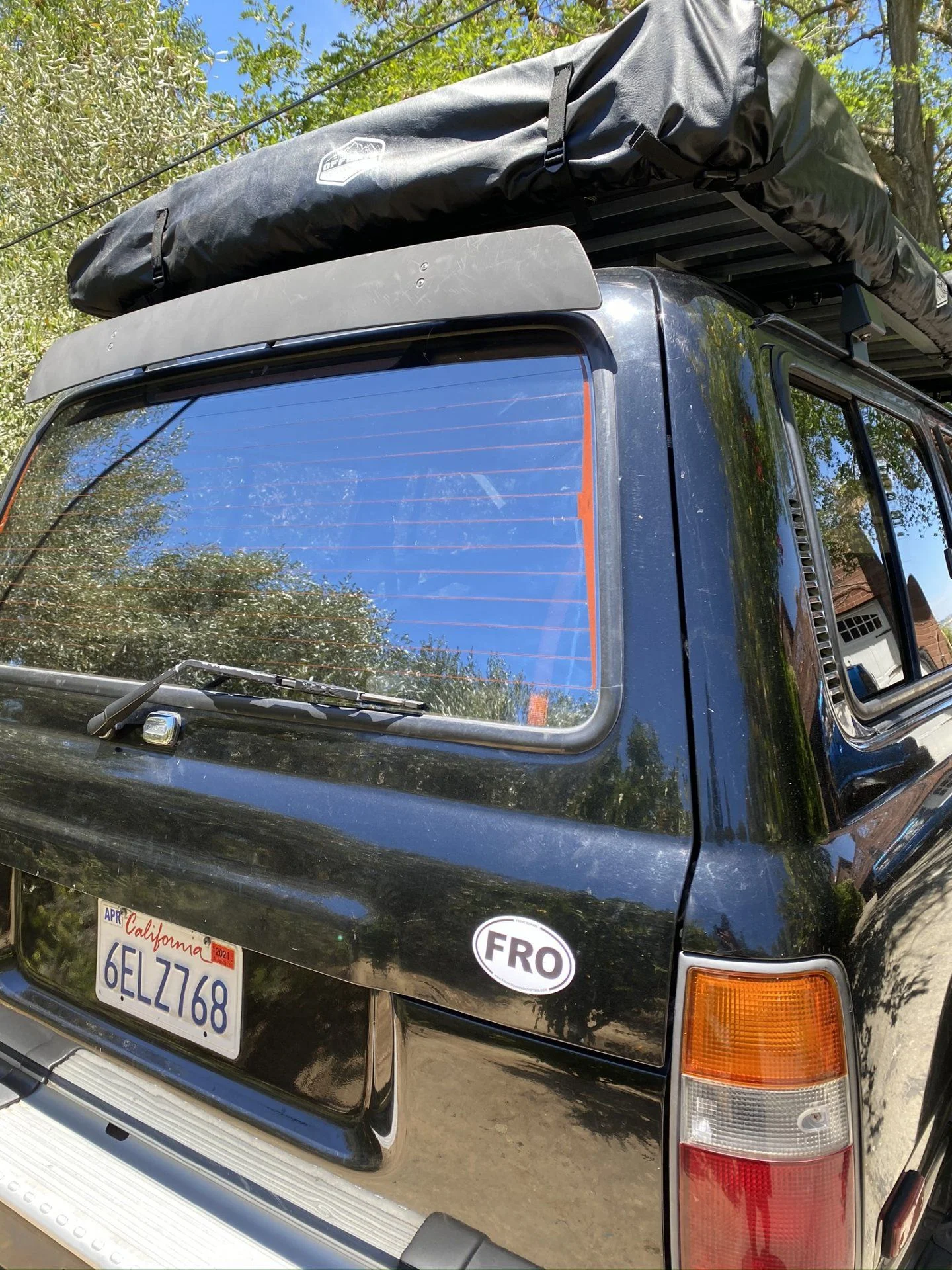

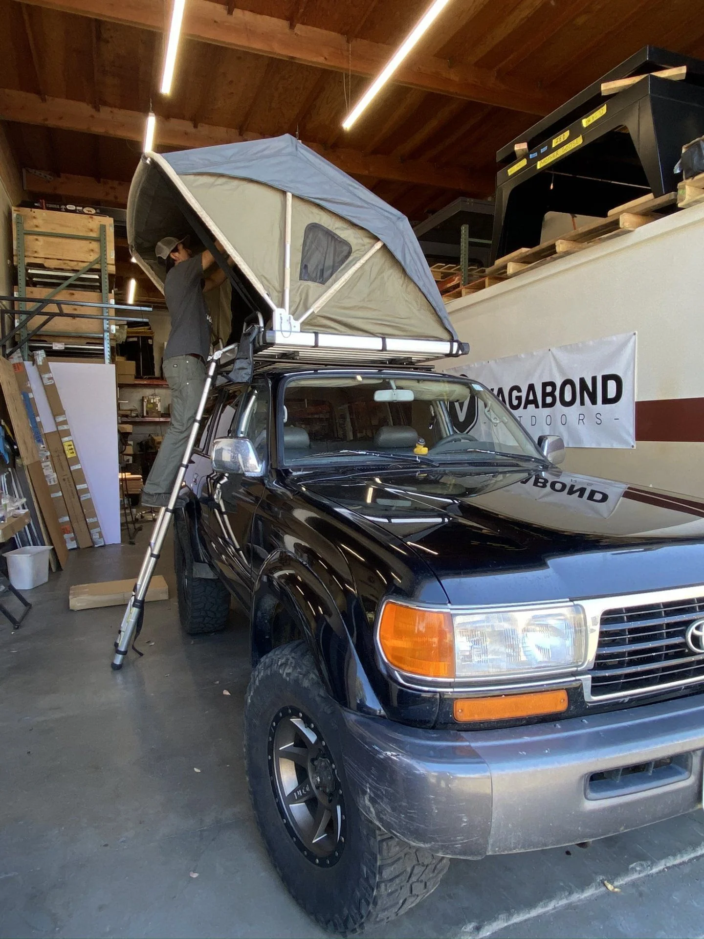

Did another thing: mounted my Front Runner roof load bars and a non-name brand RTT on the cruiser. The tent is a "Rapter Series Offgrid Voyager" rooftop tent, and it heavily resembles the original Freespirit Recreation M55 tents (probably is the same tent lol). The mattress is really comfortable - much more so than my CVT Mt. Shasta from before and on par with my FSR 55" High Country, if not slightly more comfy. All the seams look heavily sealed, the canvas material is nice and thick, and setup is easy. My only criticism is the quality of the buckles on the cover, but otherwise it seems like it's a great tent for the price. These Front Runner load bars are really nice, especially for the price. If I were going with a typical clamshell RTT, I probably would've gone with a full rack to take advantage of the remaining roof space, but since this style tent covers the whole roof, it seemed like a bit of a waste of money. My buddies at Vagabond Outdoors are a FR dealer, so I may add another load bar for the tent and one for a wind fairing, but the setup works just fine right now.
Yeah. You're gonna be fine with that setup.

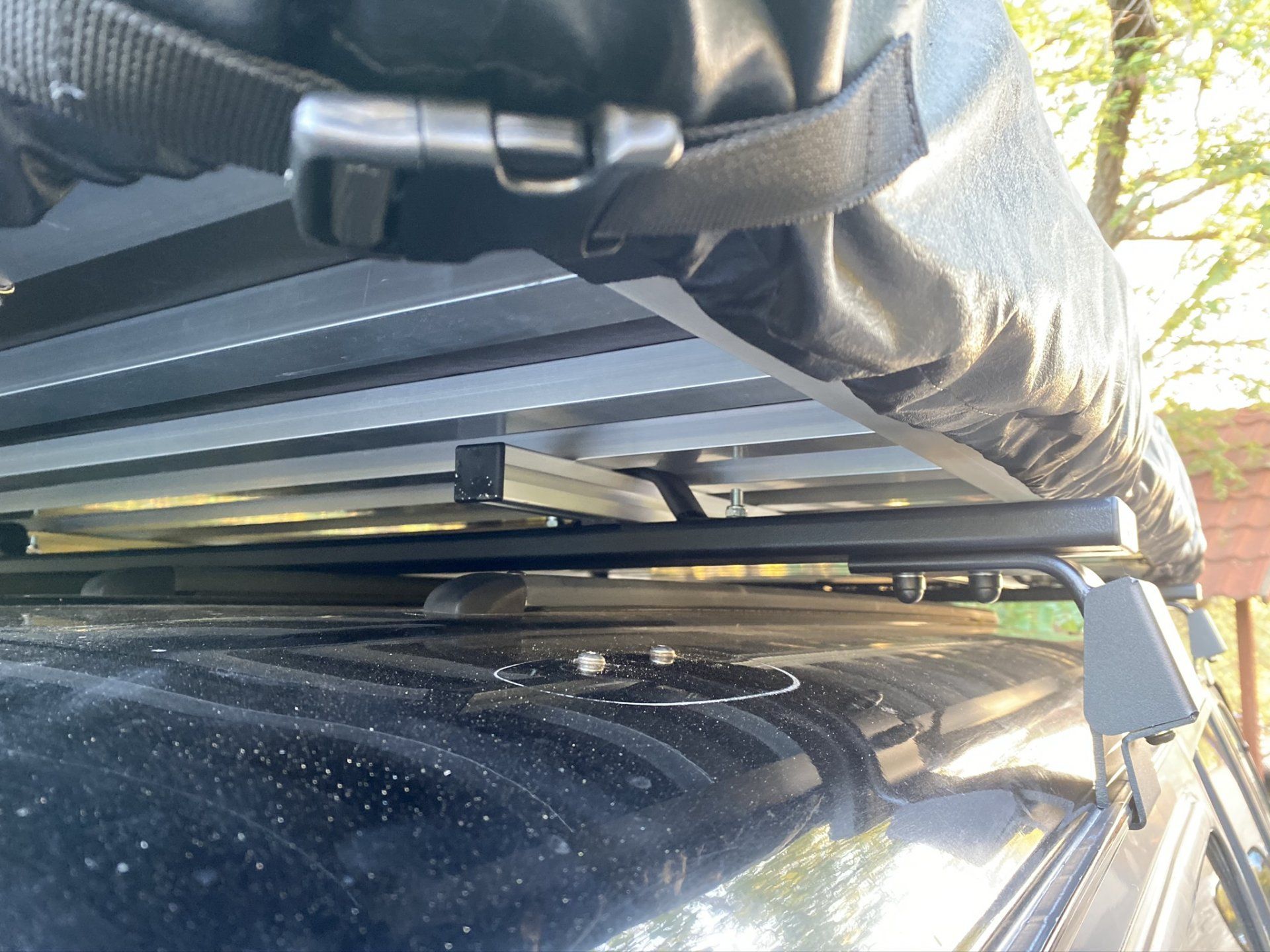

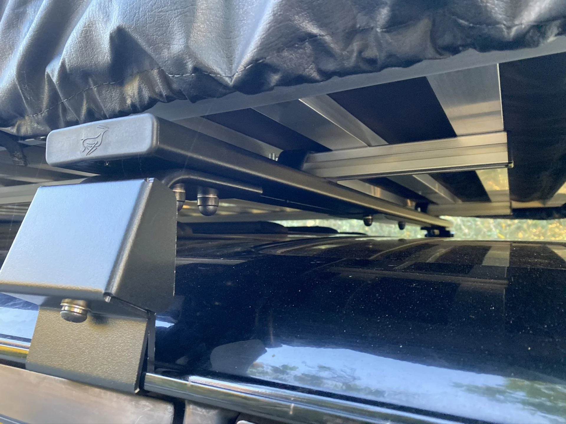

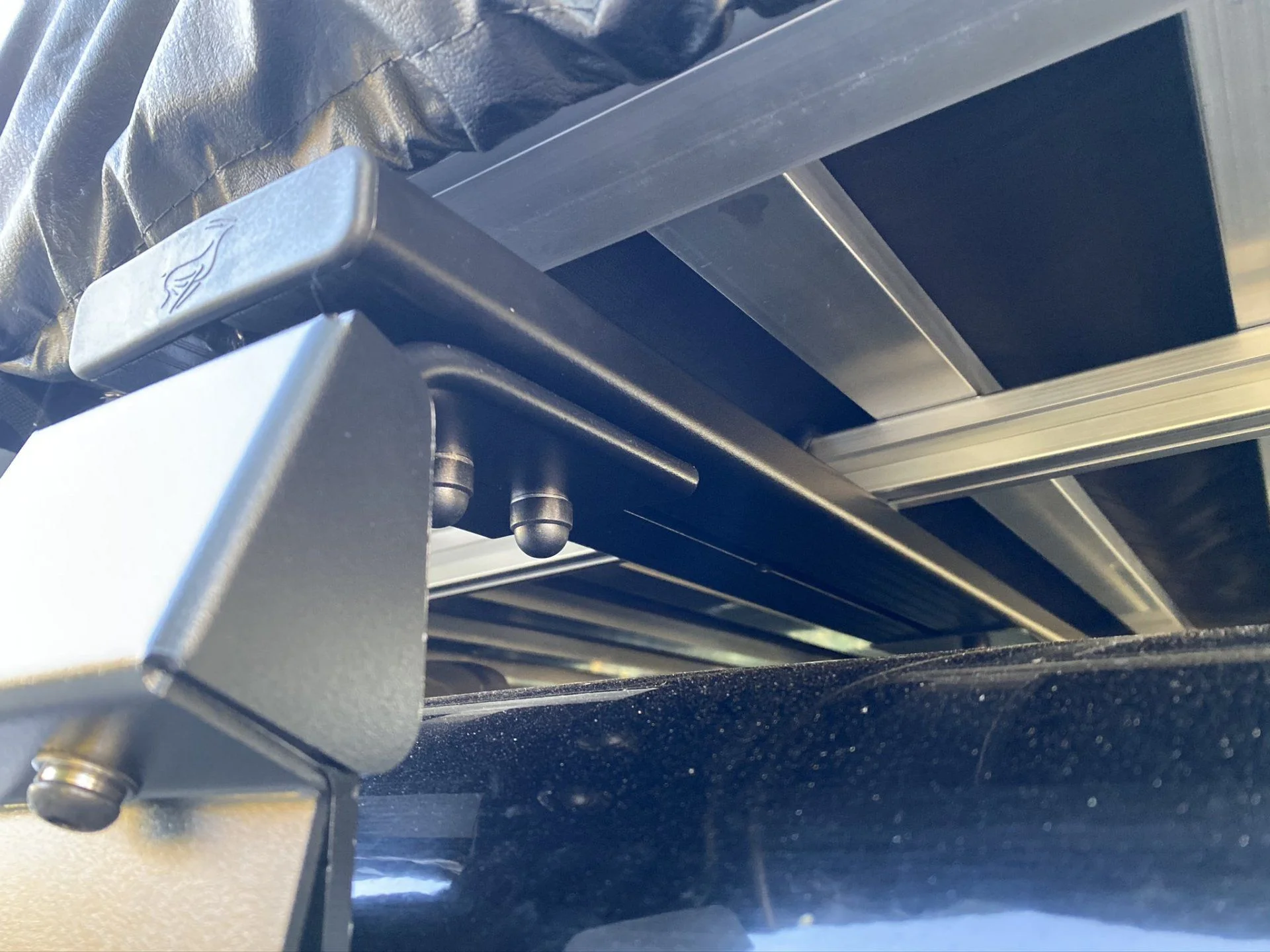

Can’t wait to go try it out! We actually installed the tent a little differently too. The mounting hardware it came with, although of good quality, was intended for round bars or stock roof racks rather than these wide Front Runner load bars. If you zoom in on the mounts you can see how we audibled the mounting in a very solid way that also doesn’t solely rely on the strength of the inside of the aluminum mounting channels under the tent
Yeah I didn't mount mine using the channels in the extrusion crossbars either. It is probably strong enough but for me clamping the whole bar to the tent mounts seemed stronger.
