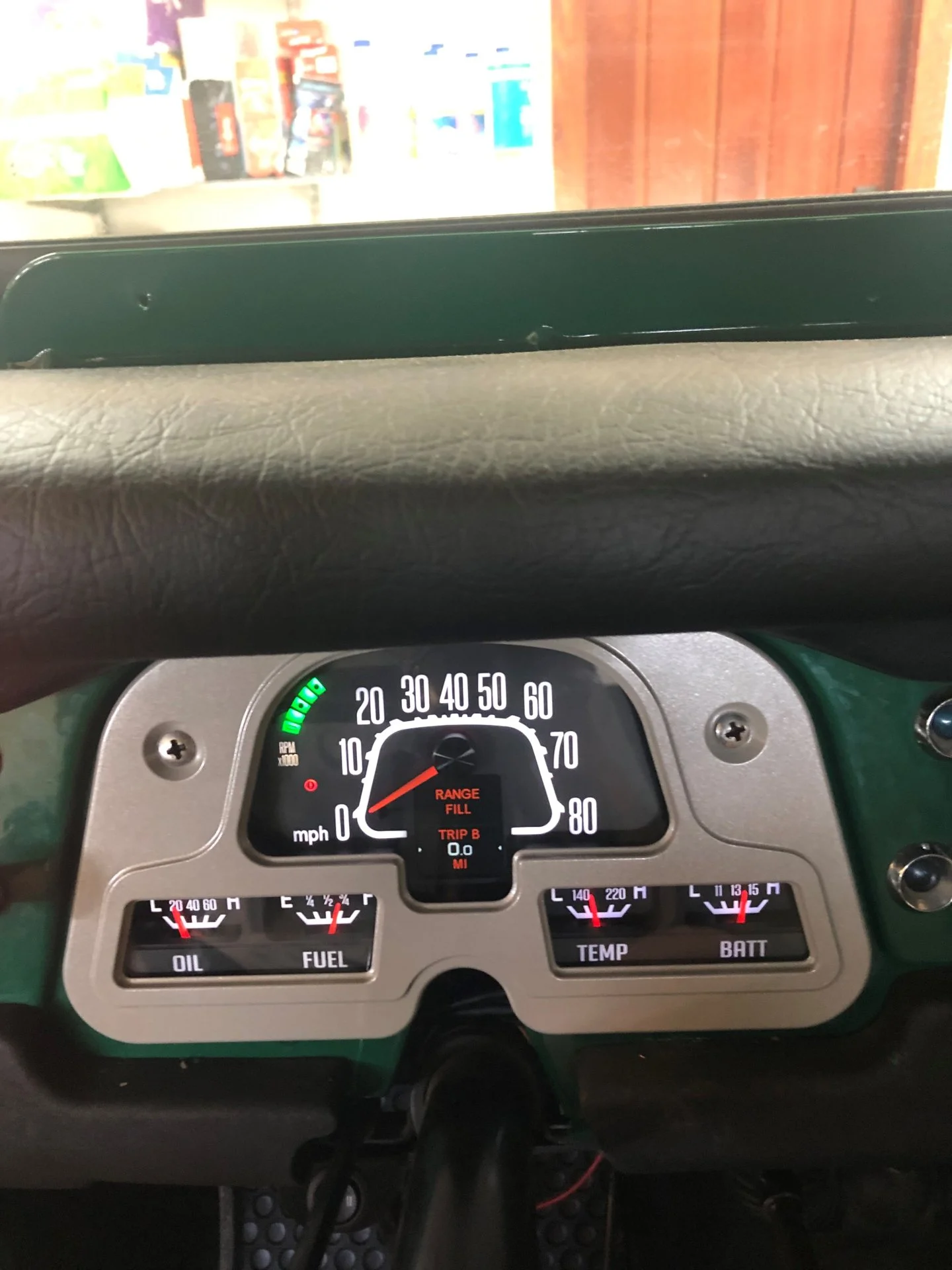

This was one of those "upgrades" that, for me anyway, just made sense. Our old stock instrument cluster on our 1970 was limping along. The oil pressure gauge and odometer were not working and the amp meter was all over the map. Moreover, the fuel gauge was not very reliable. I recognize that those could have probably been fixed to keep the truck more "bone stock." But the "bone stock" ship sailed long ago. There are upgrades for safety such as 3-point restraints and roll bar. We went with 16" steel wheels. The DD instrument cluster is one of those things that is just really nice to look at; makes driving a pleasure and provides peace of mind for accuracy on oil, water, fuel and voltage. The tach is nice as well. Night driving is much easier too. The installation is fairly straight forward. We went with the custom 80 mph top speed, 4k tach and digital compass module.

Yes. The DD fuel gauge has a wide variety of preset ranges that are compatible with most fuel sending units. Unfortunately the stock early fuel sending units are not able to communicate very well with the DD because the ohm readings are off. I ended up replacing the stock sending unit with this one: Amazon product ASIN B00VAGA19SThe 240 ohms empty / 33 full matches with one of the presets in the DD and no calibration was necessary. In addition to the sweep gauge, the DD also has a readout showing the percentage of fuel remaining. I've found it to be very accurate thus far.

OEM fuel sending unit for my 1978 works with DD.
My 71 uses an OEM sending unit and it works fine with the Dakota Digital. There is a custom preset option where you can train it to whatever sender you have.
I do like the 80mph version. Didn't know that was an option when I got mine. Fits better than the default 120mph.

We bought ours before the RTX was available and had them match the 40 font and bill the analog tach down to 4k.
