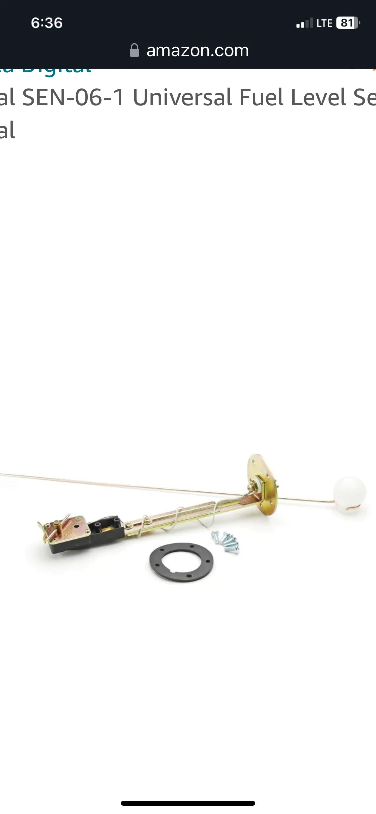

I couldn’t get my Toyota sender to work with the Dakota- ended up using a Classic Instruments sender. It was a little stubborn to get sealed up though.
Similar to this, you’ll need to measure to get the right fit. Classic Instruments SN35T8 Classic Instruments Tube-Type Fuel Level Senders | Summit Racing - https://www.summitracing.com/parts/cin-sn35t8?seid=srese1&ppckw=pmax-restoration&gclid=Cj0KCQjw1Yy5BhD-ARIsAI0RbXbHX4S79fT7zPQnB3l6pvN2Z2qNNOVnBX1NxOoit_NhVvmTs1p7WZIaAmnCEALw_wcB
Similarly, on our 1970 40 series, I couldn't get the OE fuel sender to sync with our DD. I ended up using Actron SP0F000013 Bosch Fuel Level Sender from Amazon. (240 ohms empty/33 ohms full and 130 ohms half). I believe that it cost about $30.00 a few years ago.
I believe that the Toyota sender should have a range of 17 to 120 ohms full to empty but I found on mine that those ohms were not continuous across the range. From what I understood after speaking with DD is that you have to program each quarter tank measurement.
I ended up ditching the OEM sender and going with a 0-90 ohm floatless sender.
Thanks everyone - that helps and confirms my findings. Looks like I’m shopping for aftermarket.
The Actron SP0F000013 Bosch Fuel Level Sender is still available for $21 on Amazon.

I had to open up one of the holes slightly. Had an issue with fuel coming up the threads so had to use sealant on the bolts.
I’ve tried to calibrate mine too multiple times without any luck. I gotta pick up one or those tube senders eventually as I hear those are plug and play once you cut it to the correct length
I highly recommend the floatless sender from Tanks Inc. It’s a bit pricey at $125 but it is super high quality and very accurate. It also provides a very consistent reading without much fluctuation from fuel slosh.
You can get these made to custom length but you can’t modify it once it is made because it has a circuit board inside that spans the full length of the tube.

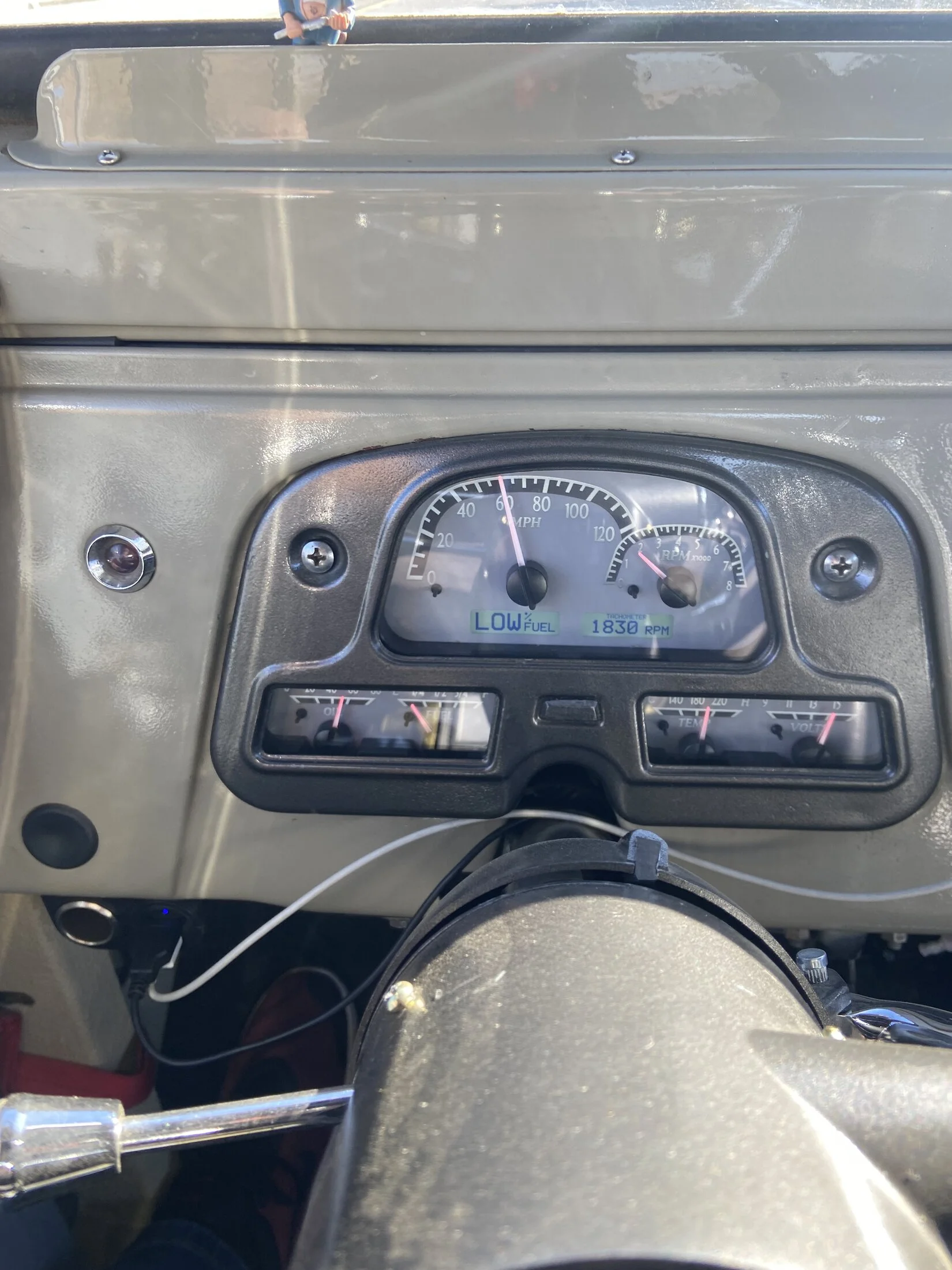

@fireflyr, am I understanding correctly that the low fuel warning can’t be adjusted? 10% for me would be about 10-15 miles assuming that I probably will need a gallon or two left behind in the tank to submerge my pickup tube. It would be nice to set this warning to 15%. Thanks for the reminder about this feature.

I forgot about the 1/4 mile, 0-60 stats. I turned all of that off. Let me know if you do find a way to tune the empty warning specs.
