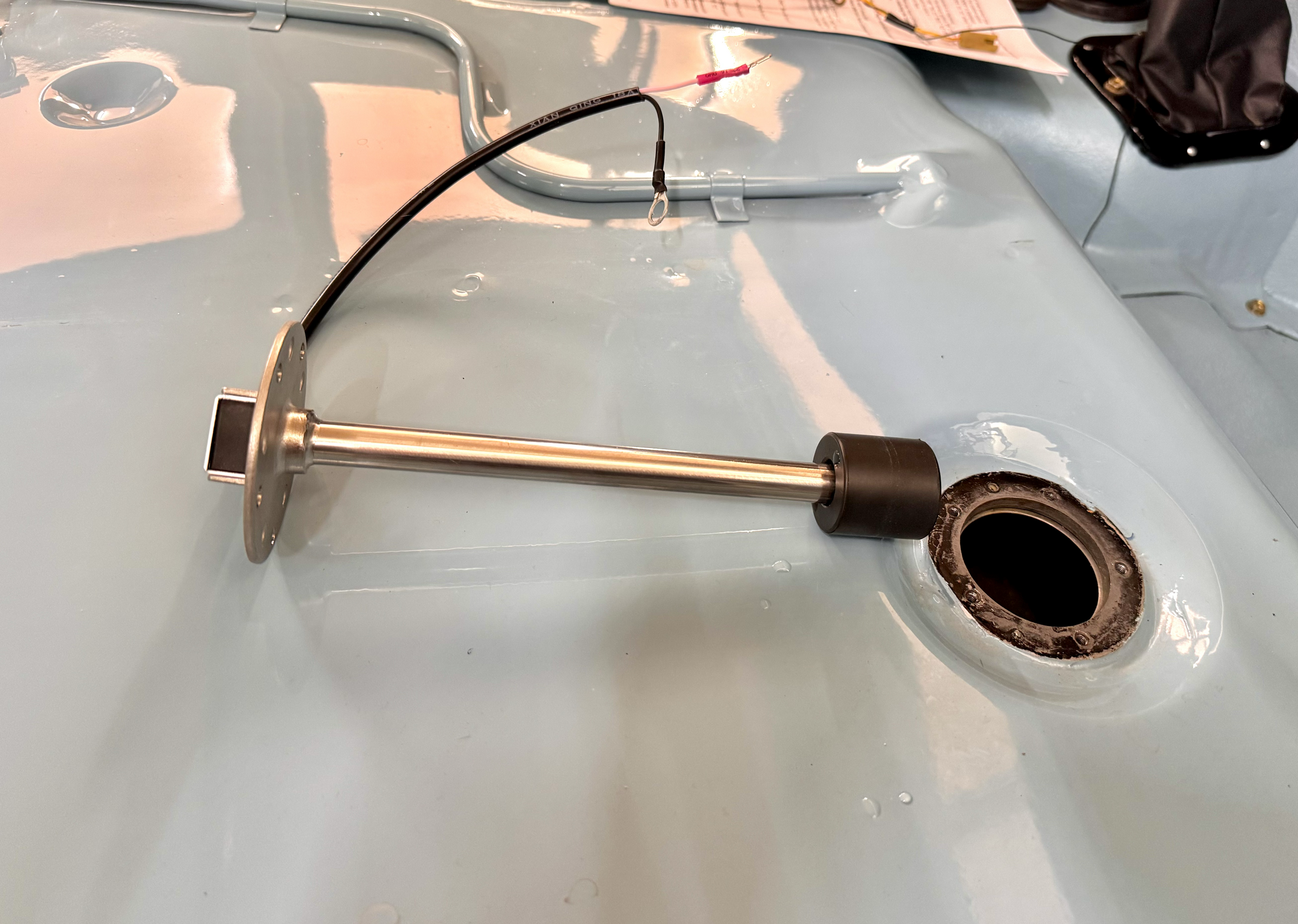

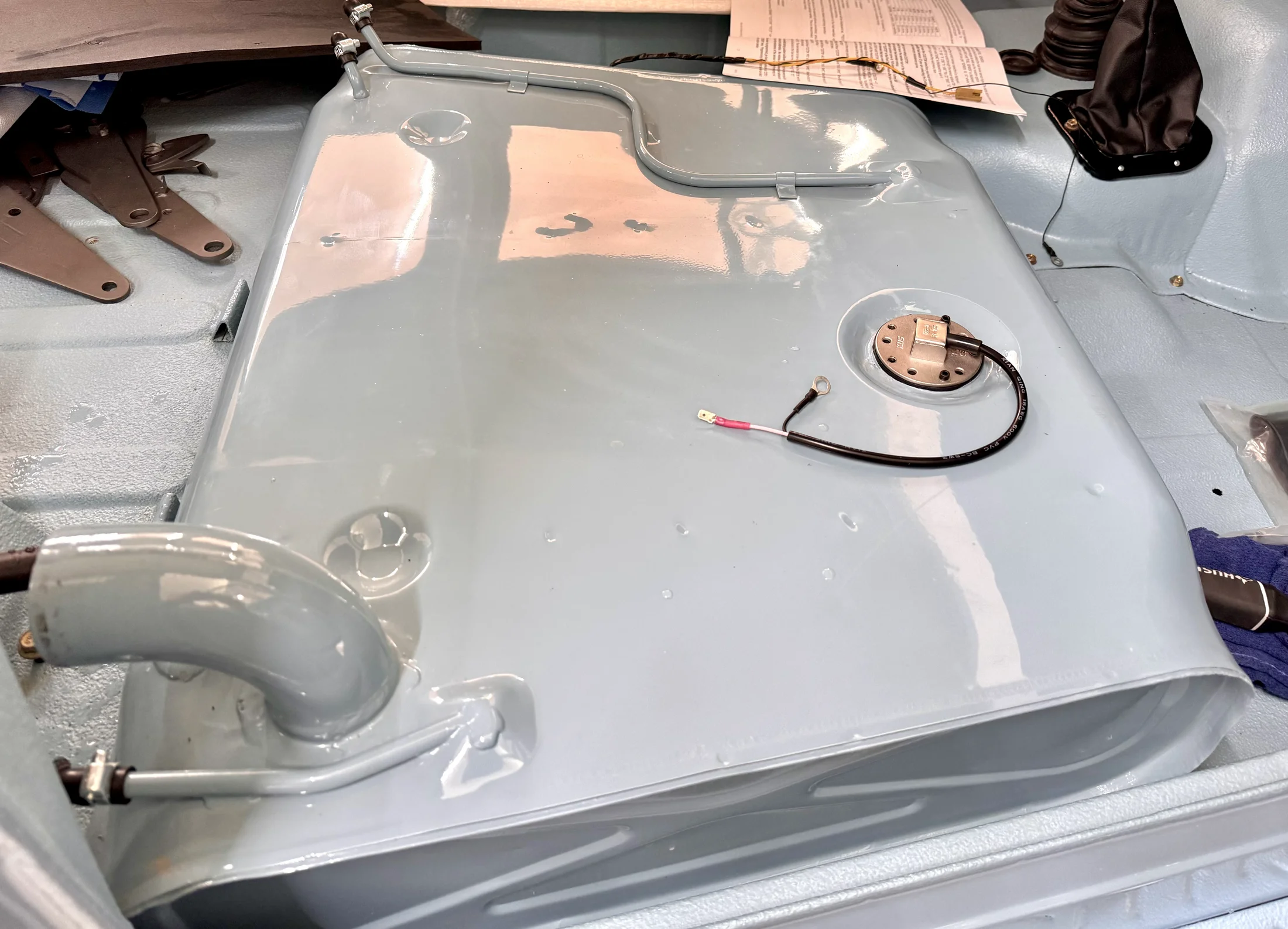

update: I fought with the factory sender but despite all my efforts could not get it to work. Ended up getting a 8" KUS sender (about $50) which is rated for 240-30 ohms. The bottom of the sender is a little less than an inch from the bottom of the tank. I was concerned because it rest just along the side/ edge of the lower sump so the float doesn't quite make it to the bottom of the sender stalk. I tested it a few times and 1.5 gallons puts the needle off empty and with 4 gallons its right at 1/4 tank so that seemed pretty reasonable to me.
I did have to drill new mounting holes. It comes with a staggered 5-hole screw pattern which of course, doesn't match up but the mounting plate is heavy gauge so I just drilled to accommodate the tank pattern.

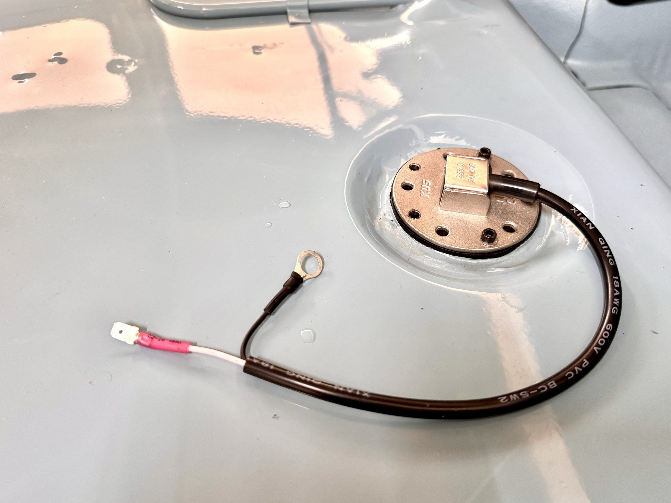

I highly recommend the floatless sender from Tanks Inc. It’s a bit pricey at $125 but it is super high quality and very accurate. It also provides a very consistent reading without much fluctuation from fuel slosh.
You can get these made to custom length but you can’t modify it once it is made because it has a circuit board inside that spans the full length of the tube.
I installed mine in a custom tank so I can’t provide any tips for the stock mounting holes.
Did you buy Tanks model 0-90 Ohms - GM 1965 and up - T-GML? Do you have the early gas tank? I need to buy one for my 1971 FJ40.
I do not have a factory tank. Mine is a custom tank that is under the rear of the Cruiser.
Yes, I used part# T- GML-14. I imagine that you could use the same type of sender in a factory tank, but one that is shallower.
I did some research and found this ring adapter for the tank that Proffitt’s Land Cruisers sells, as well as this fuel sender that can work with the GM preset of the DD.
https://www.amazon.com/AODITECK-240-33-Sending-Marine-Sender/dp/B08RBN82D4?tag=ihco-20
Hope this can help someone!
I just ordered This exact set up for mine . Lets hope it works

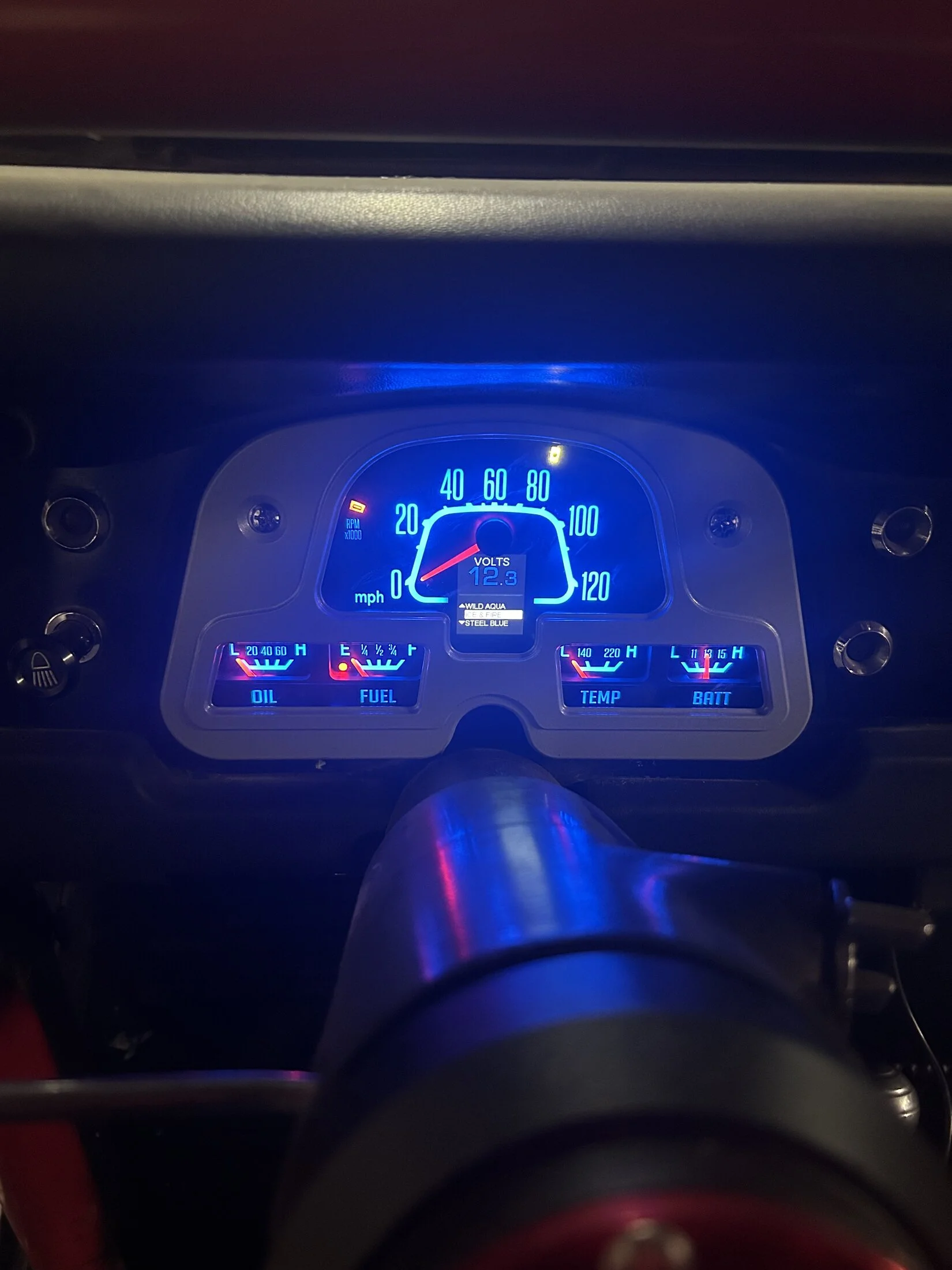

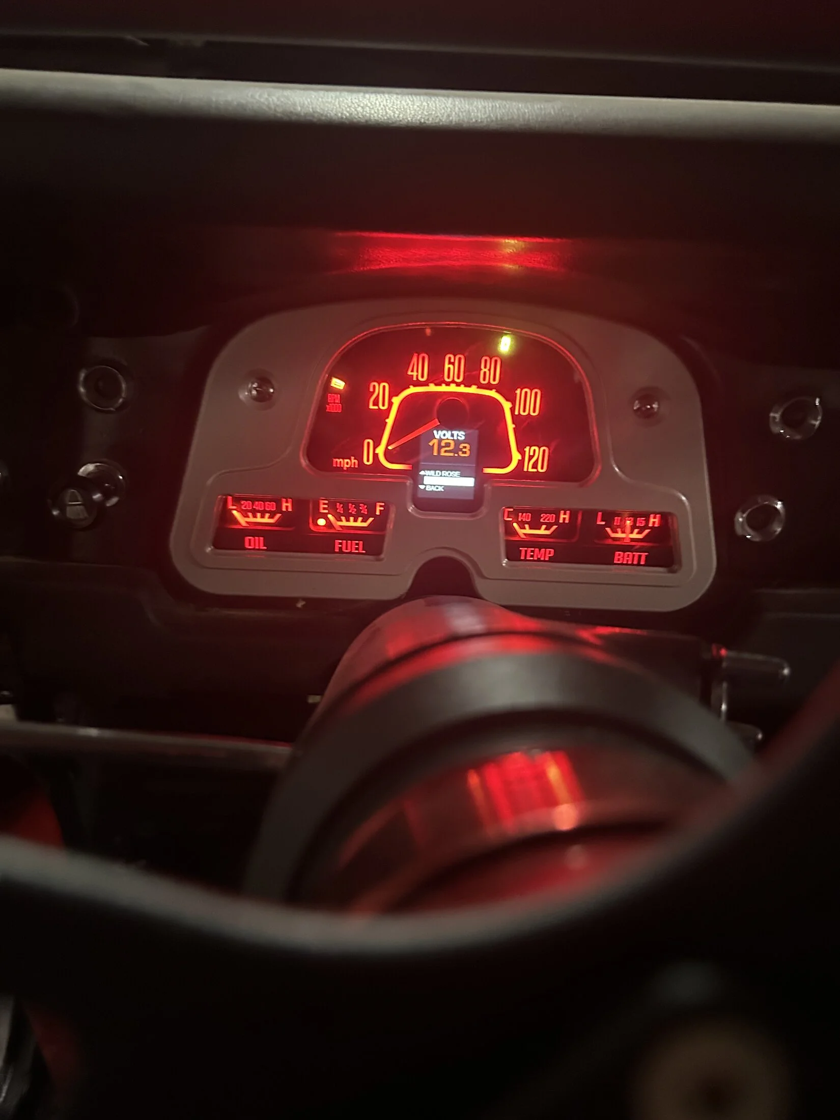

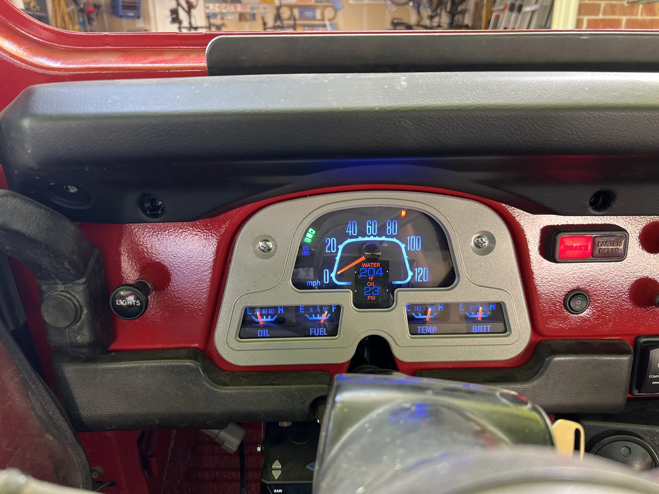

I added a few pictures for fun.
Mike how did you get those colors ? and the temp and oil display there ? i just get Volts
Both of those features can be adjusted in the setup menu > lighting or display. I have the temp and oil pressure displaying through one of the group displays. You can have up to 5 different displays that you can toggle through with the momentary switch.
I figured it out. . all kinds of cool things .
Tons of options, and if there aren’t enough options, DD has been open to programming custom options for additional cost. I might send my gauges over to them to change the parameters of the temp gauge. My LS runs 200-208°F while the needle sits around 220, hence why I have the number readout displayed.
I got all my warning lights set . I got the gps speedo stuff I need to set up today . Just not sure where I am going to put the option antenna yet
