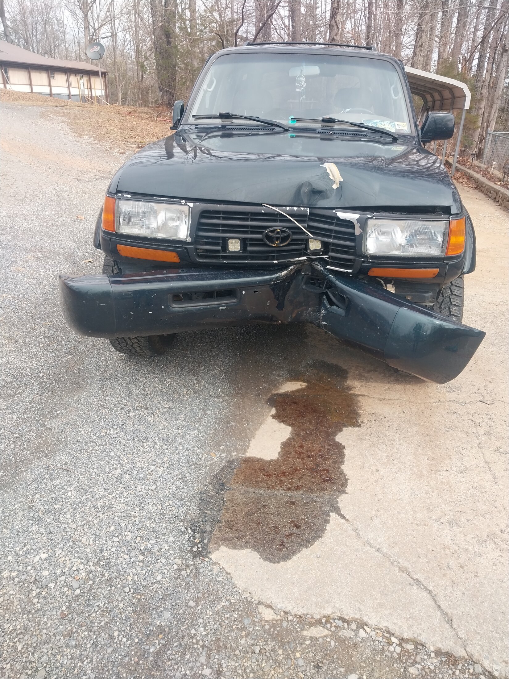

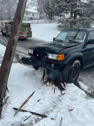

Well guys I'm gonna try and use / figure out what to do with these depo lights if I can use them I'll try . My girl crashed her 95fzj 2 weeks ago stock headlight assemblie mounting tabs are broke might be able to fix them not sure at this time lots of parts to replace but I'm fine with that she wasn't hurt nor the little kid walking it's dog out in the snow that ran put in front of her damage on the 80 made it to the core support no further telephone pole had to been old as hell.
OUCH!
