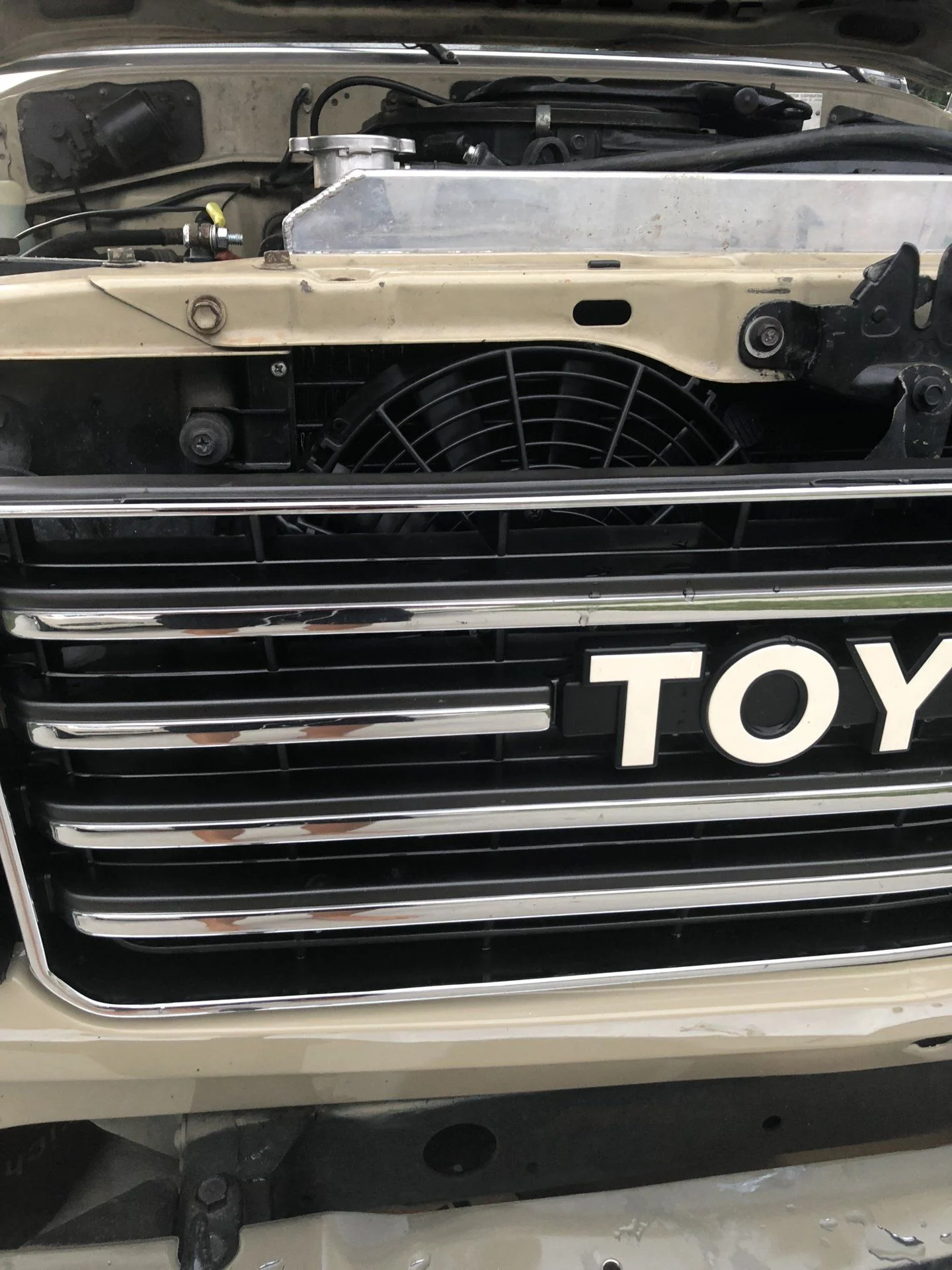

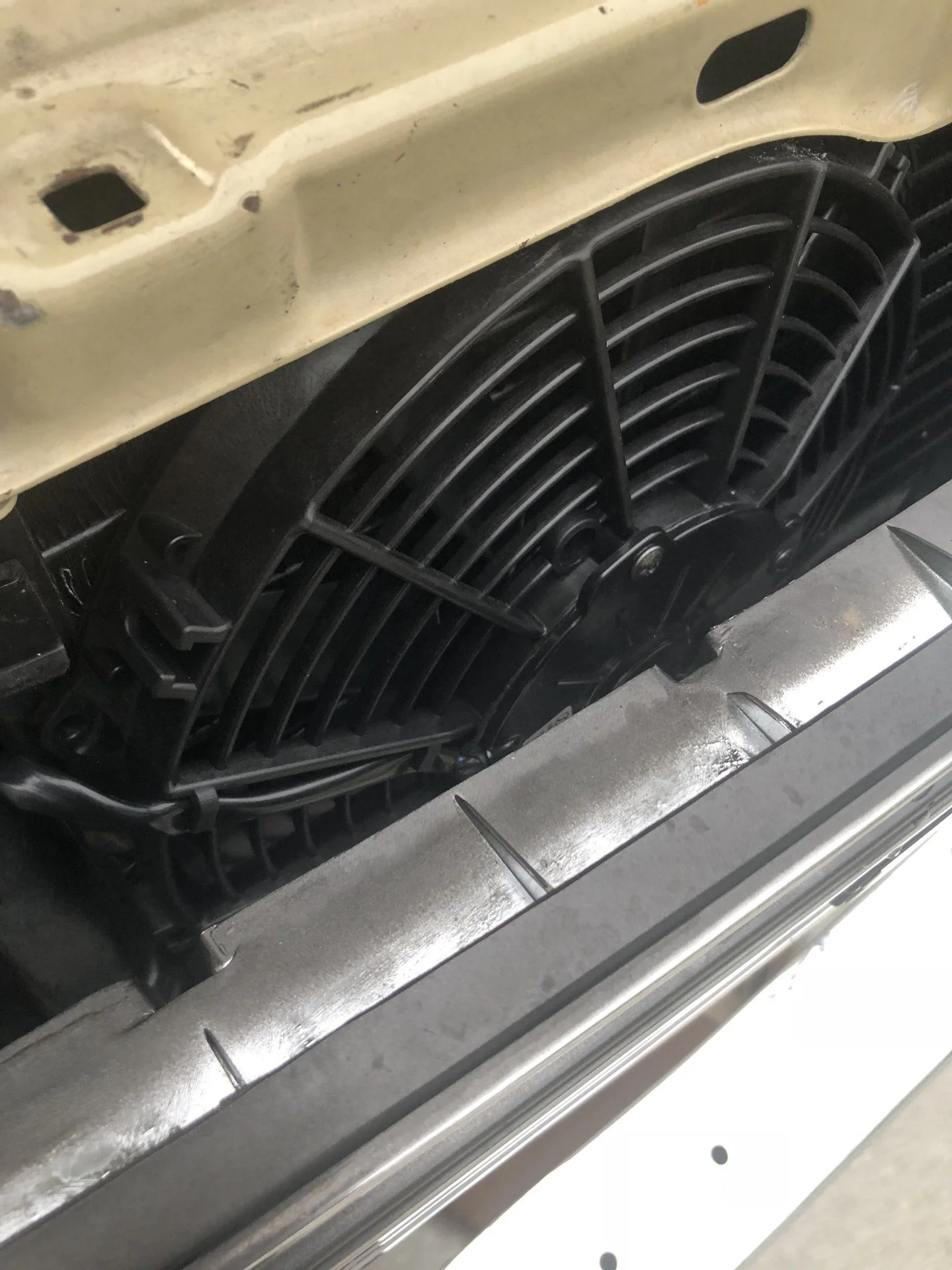

I recently installed a pusher fan on the front of my cruiser to help my A/C during in town driving since I daily my 60 in 100+ Central Florida heat.
it is a pretty simple and easy install but I figured I'd put it all in one thread in case someone else wants to do it.
I used a 10in SPL fan and just a 4 Pin universal relay.

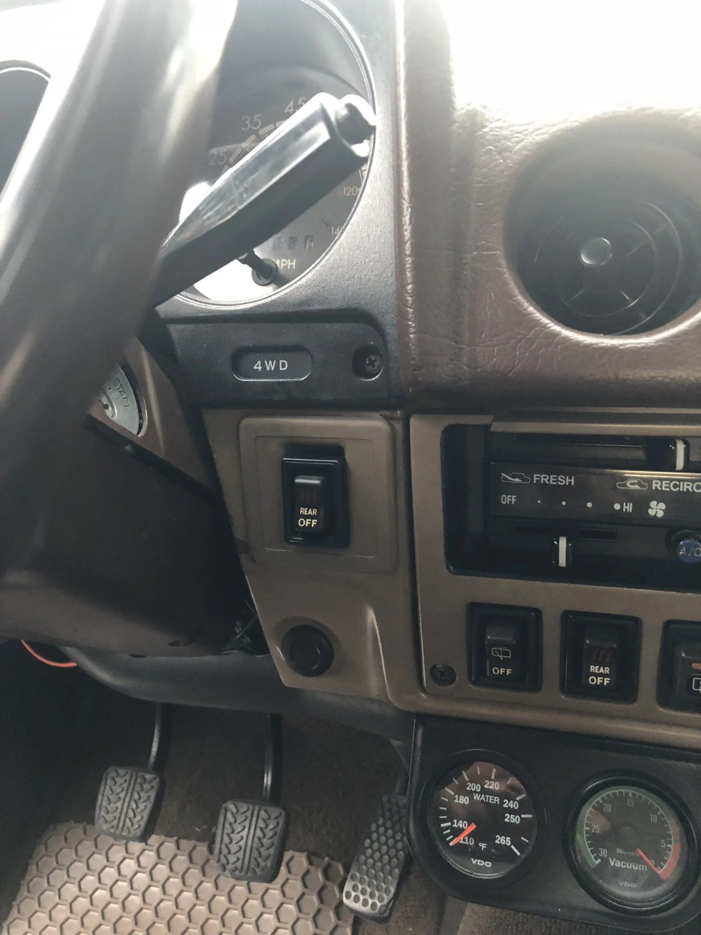

I used a factory switch so it looks fairly stock in the cab. The switch works by breaking and reconnecting the ground for the fan.

What is that hard line running horizontally in front of the condenser? Seems like that would be an obstacle to fitting a fan in there. Is that a Freon line? I'm about to have my shop go with a new compressor, dryer, expansion valve, flush, and recharge locally here with CoolStream parts. So, it seems that if that is a Freon line, I wonder if it can be rerouted or a flexible steel line can be used. If so, not is the time. Just brainstorming.
