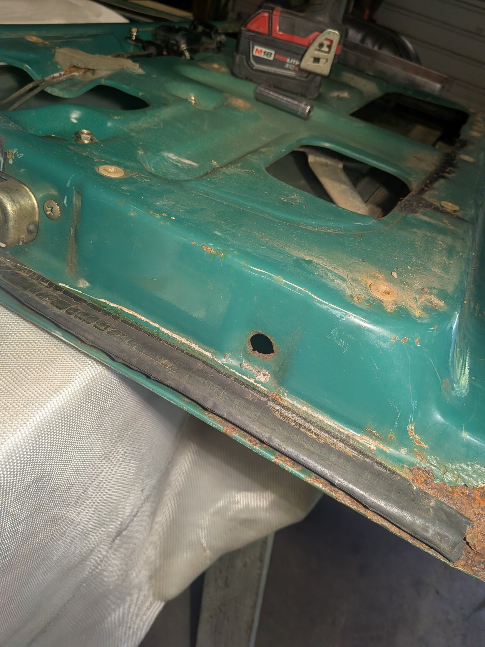

One piece of my order arrived. At least these look Ike they should go in pretty easily.
Quick test.
Pretty reasonable price I thought. About 40 bucks a side from amayama.
170 each from Toyota parts direct 🙄🙄🙄🤢🤮
Well this is a fiddly pain in the ass.
The new style seals that use these rectangular holes are easier to get and probably work better, but cutting these holes in the other door would suck.
Filling them also sucks. 🤣
Still thinking this is easier than the alternative but probably not by much... can't win. :meh:

Got the driver's door back together yesterday. Closes with a solid thump now instead of a rattling clang...it's downright strange.
Gee. I wonder why my old door rattled...🤣🤣View attachment 3952273
Weird...how did that impact fit in there with the battery on?
Side two...
Getting the front lower runs in might be the worst part of all this.
It'll go in a couple inches then it's like putting a marshmallow into a piggy bank.
You can help it along with a long screwdriver but you'll probably cut it. I found popping the bottom inch out enough to grab it and pull worked. :meh:
Nice thing about a truck that took a 25 year nap is the wear parts aren't worn. These were only 10 years old when the nap started. Close one is what most look like.
Considering what a pain it was to find these outer felts, I don't see why you couldn't use inners on both sides. Bit narrower but not by a ton.
Ive seen lots of bitching about these being hard to install. Just snapped in for me. No biggie.
