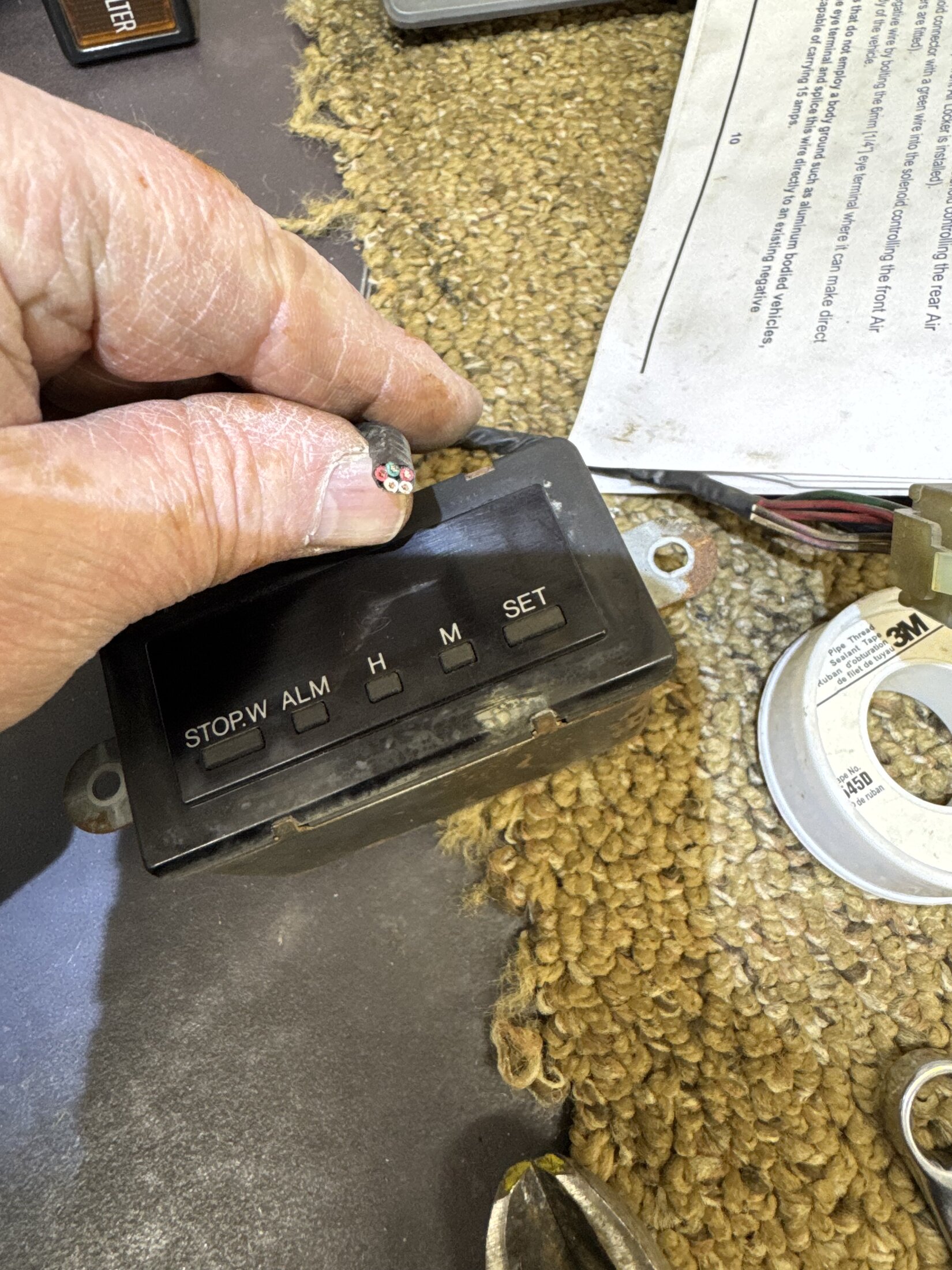

Hey. Do you have a 12V clock in either of your trucks? I found one and want to plug it in to see if it works. If it works I’ll see how to wire it. No idea why it has 5 wires
Hey. Do you have a 12V clock in either of your trucks? I found one and want to plug it in to see if it works. If it works I’ll see how to wire it. No idea why it has 5 wires View attachment 3912763
No, I have a 24v version of that I've been meaning to reinstall if I can find the plug inside the dash.
It dims with the lights, and goes dark with the key off so I can see it having 4 wires. Not sure about the 5th...

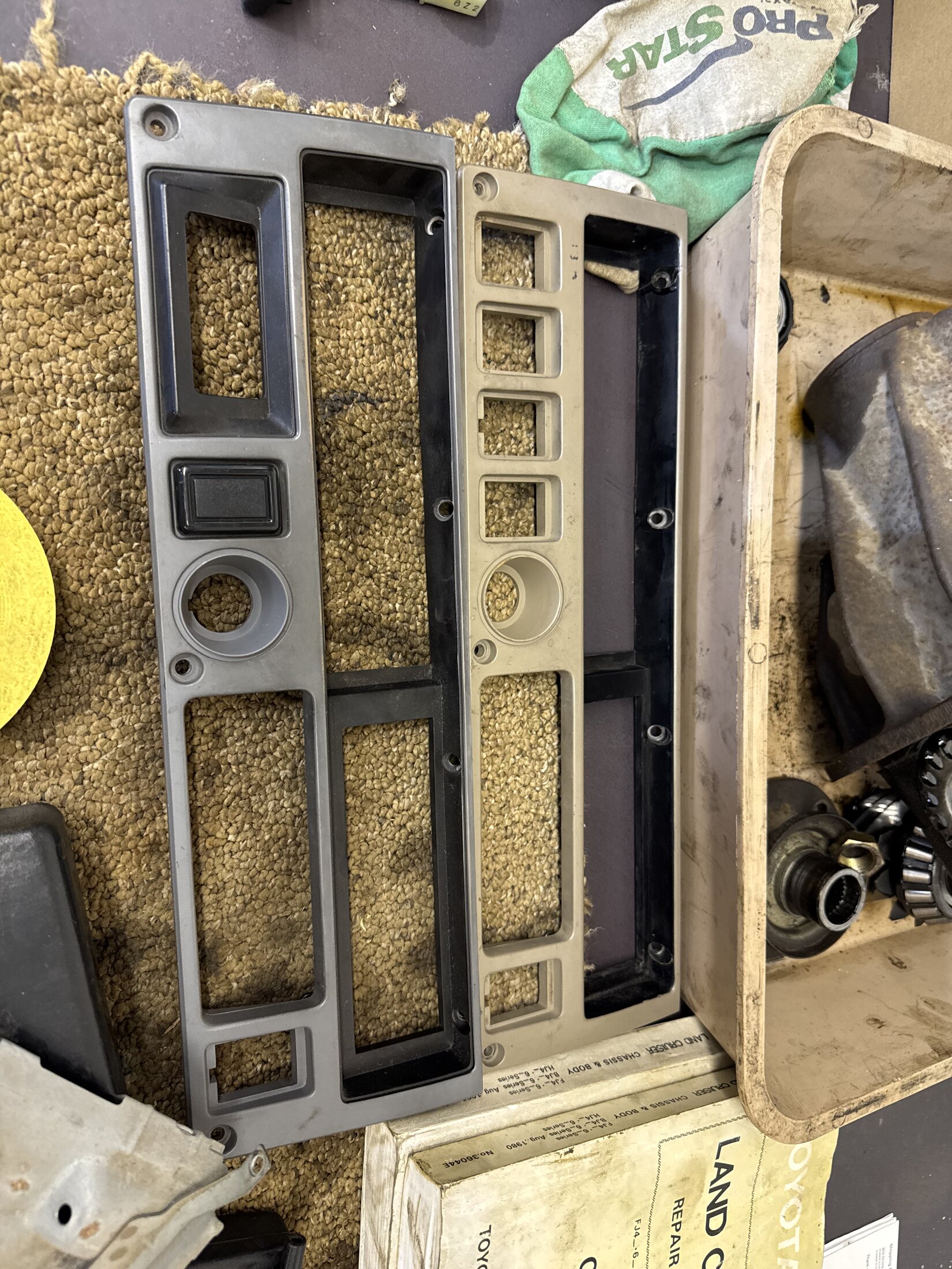

I think two wires wrap together. I’ve got a 24V clock too. Had to swap housings to get this one to fit. I’m changing my dash panel to clean it up. Clock looks better than all the rear hatch switches I don’t use
I think two wires wrap together. I’ve got a 24V clock too. Had to swap housings to get this one to fit. I’m changing my dash panel to clean it up. Clock looks better than all the rear hatch switches I don’t useView attachment 3912818
Yeah I have that big blank piece of plastic for a switch panel in my 60, I've been meaning to put the clock back in. Just haven't gotten around to it.

I'm fairly sure it's a 4 wire plug...but I'd have to look.
Makes sense tho. B+, keyed hot, dimmer wire that goes to stereo, ground.
The plug is 4 wires. I think the two run together for hot to keep the time. I’ve read up a bit on search but no one’s just produced a pic of a plug.
Yours is a 61? 24V? Oh and in that first pic if you count there are 5 wires burning the plug to the clock the two white/black are together
Yeah 60 is 24v
The clock should install pretty much like a stereo. Hot to battery for memory, another to key to turn it on.
Dimmer is probably optional
Thanks, I just not confident enough to start powering up wires without thinking I'll wreck it.

I think it should be pretty hard to hurt. All three are connected to 12v, sometimes all at once. ( other than the ground :lol: )
The dimmer can probably go to one of the dash lights that's nearby. They only work with the lights on I think.
