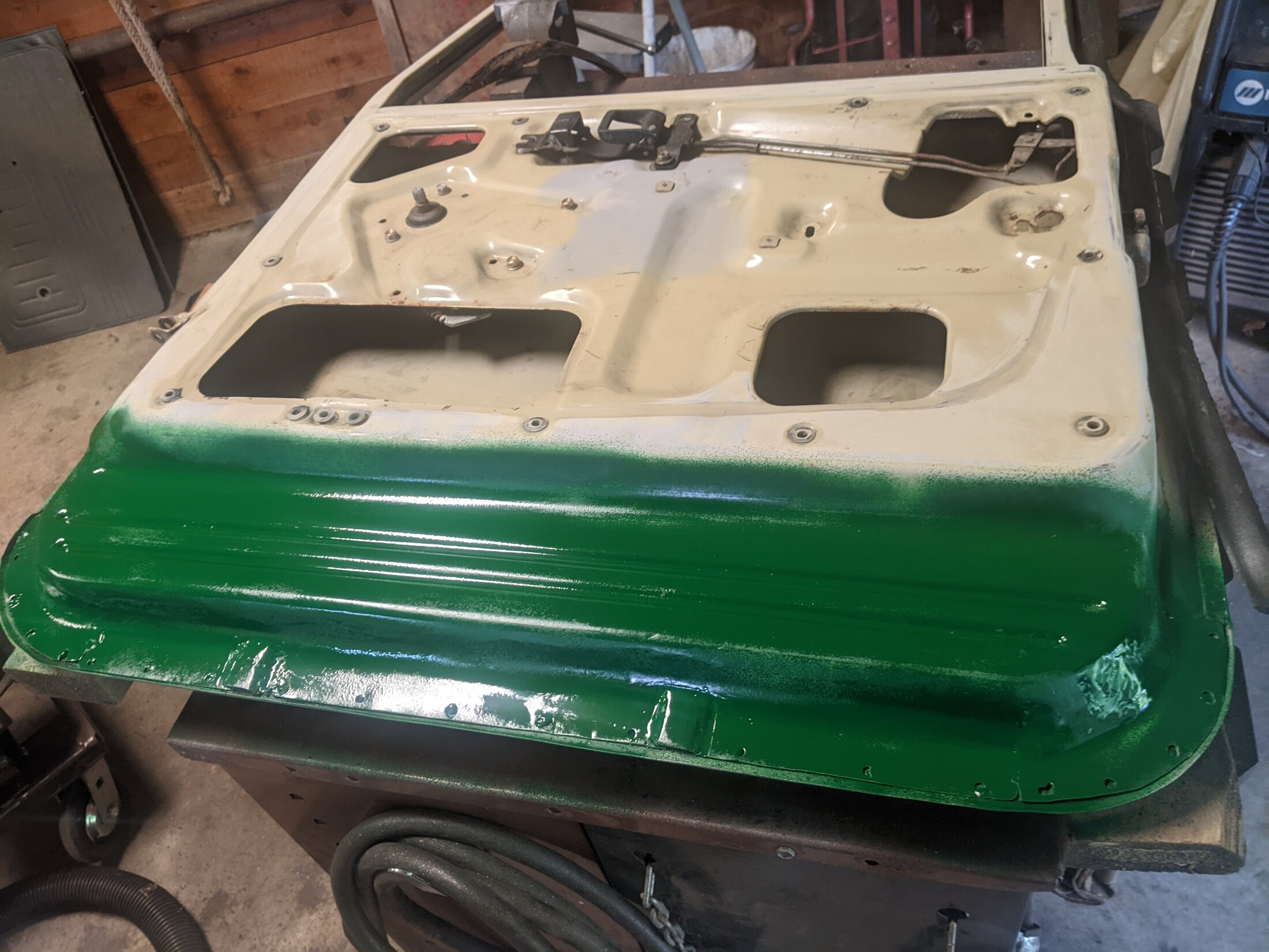

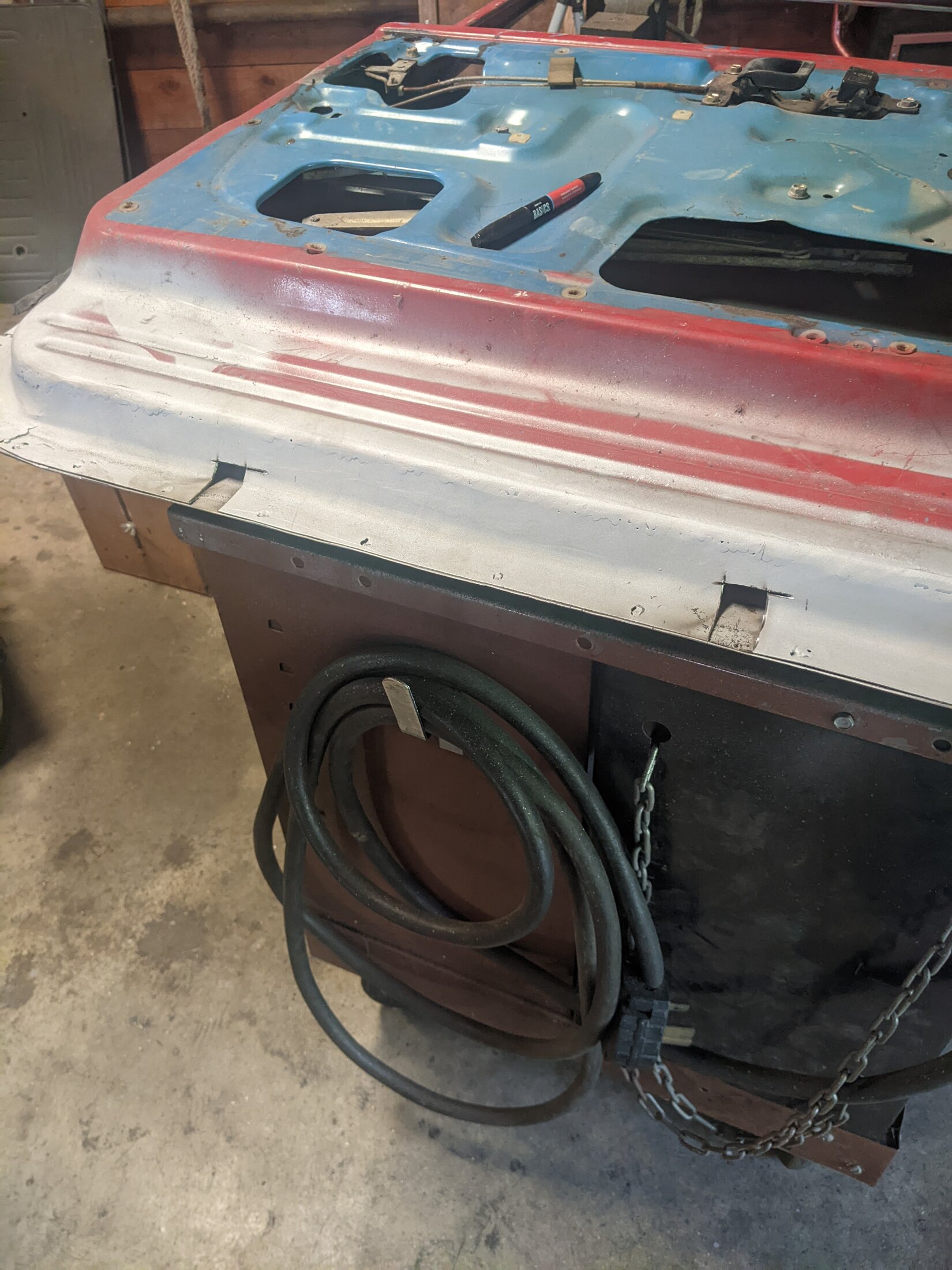

Woke up dying for a shower but knowing I had epoxy to sand 🤢🤮
Anyway, sanded off that and all the house paint, applied the magic eraser to my ugly drain welds, cleaned off the black goop, then some ...
Seeing as primer is just flat paint with pre-installed sanding dust... let's call it primer. :lol:
Sanded all the white house paint off.
Now behind door #2
Magic eraser first this time :p
Now I get to sand the epoxy, and all the white AND the red off this door. I can't wait.
My first ever bj40 was blue then painted red with a brush.
I kinda wonder if this is one of its doors that found its way back to punish me. :lol:

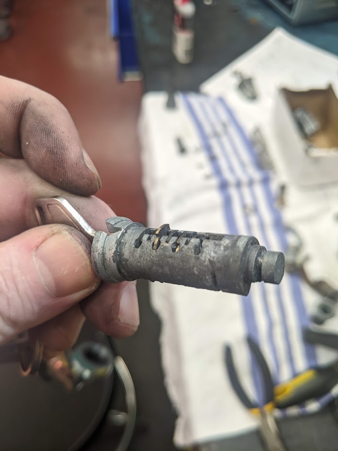

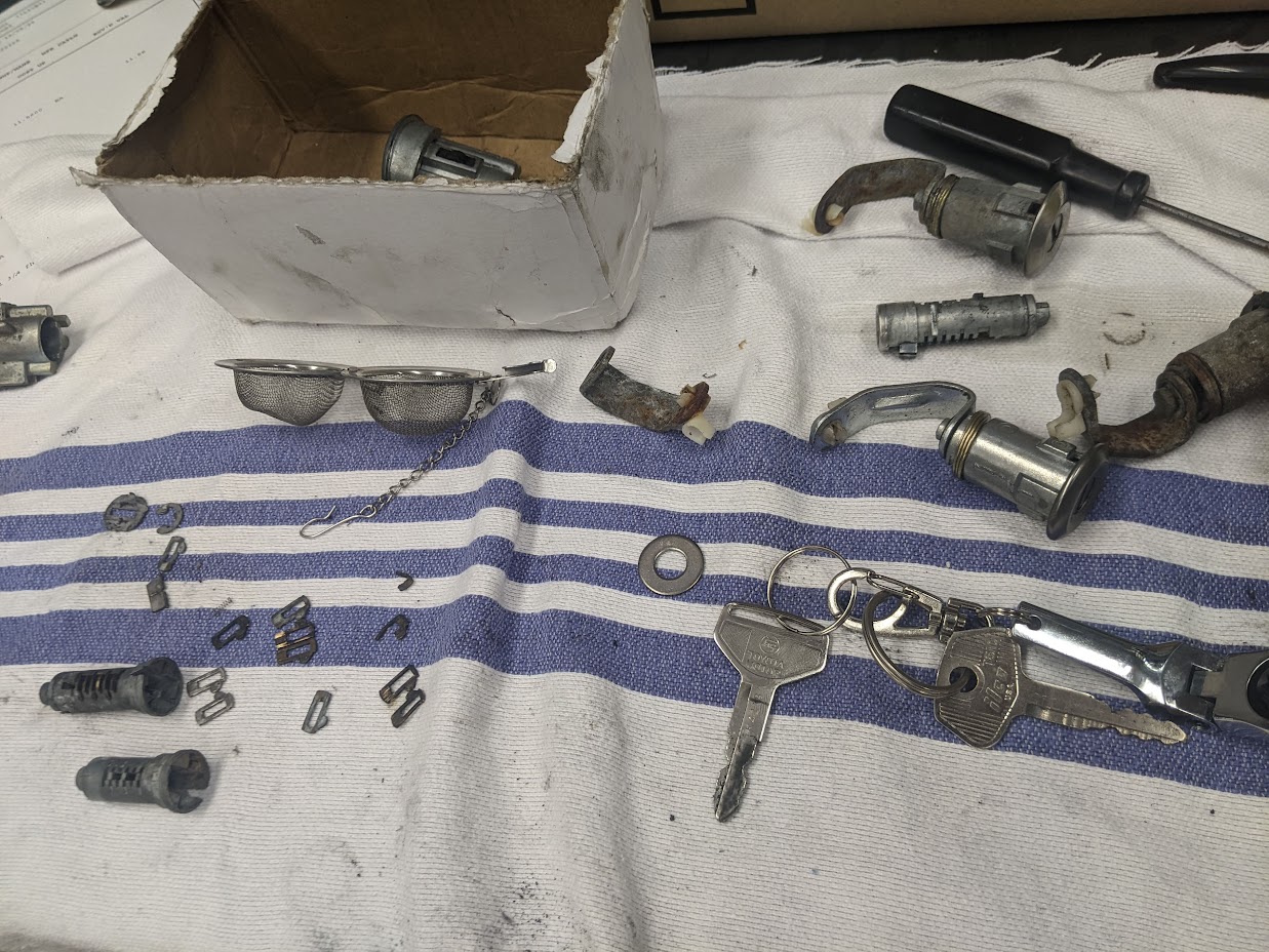

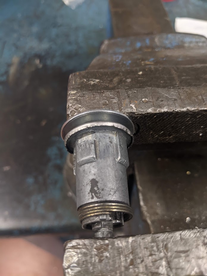

Did some rekeying of door locks while I wait for stuff to arrive.
This sh!t'll make you go crosseyed.
It's actually pretty easy to do, hardest part is getting that chrome cover off without making it ugly. Small screwdriver with a bend in the tip worked for me.
And maybe some patience...
The little door flap is a bugger to reassemble, ( and easy to lose when the chrome pops off) fortunately with the two aftermarket ones I rekeyed that all stayed together. Cylinder comes out once that chrome is off and you pop the spring off the back.
Make sure the key is in at this point or you'll lose things.
Lots of things...some of them very small :lol:
Then you just mix and match these flat pieces until they're all pulled in when you put the key in. Fortunately these ones were close, I just reversed a couple, that one sticking out is obviously a mismatch.
