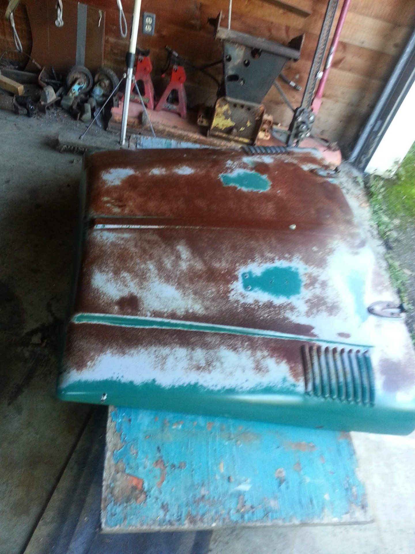

This should piss off the paint snobs...:lol:
Very trendy of you.
Is it trendy now ?
Oh well, if it wasn't before it would be after I did it.
Fashion follows me. It's a curse...:lol:
I douched it with clr then gave it a squirt of Tremclad clearcoat. We'll see how it lasts.
Trouble with linseed is the reapplying all the time. More trouble than I want for a $12 paint job.
