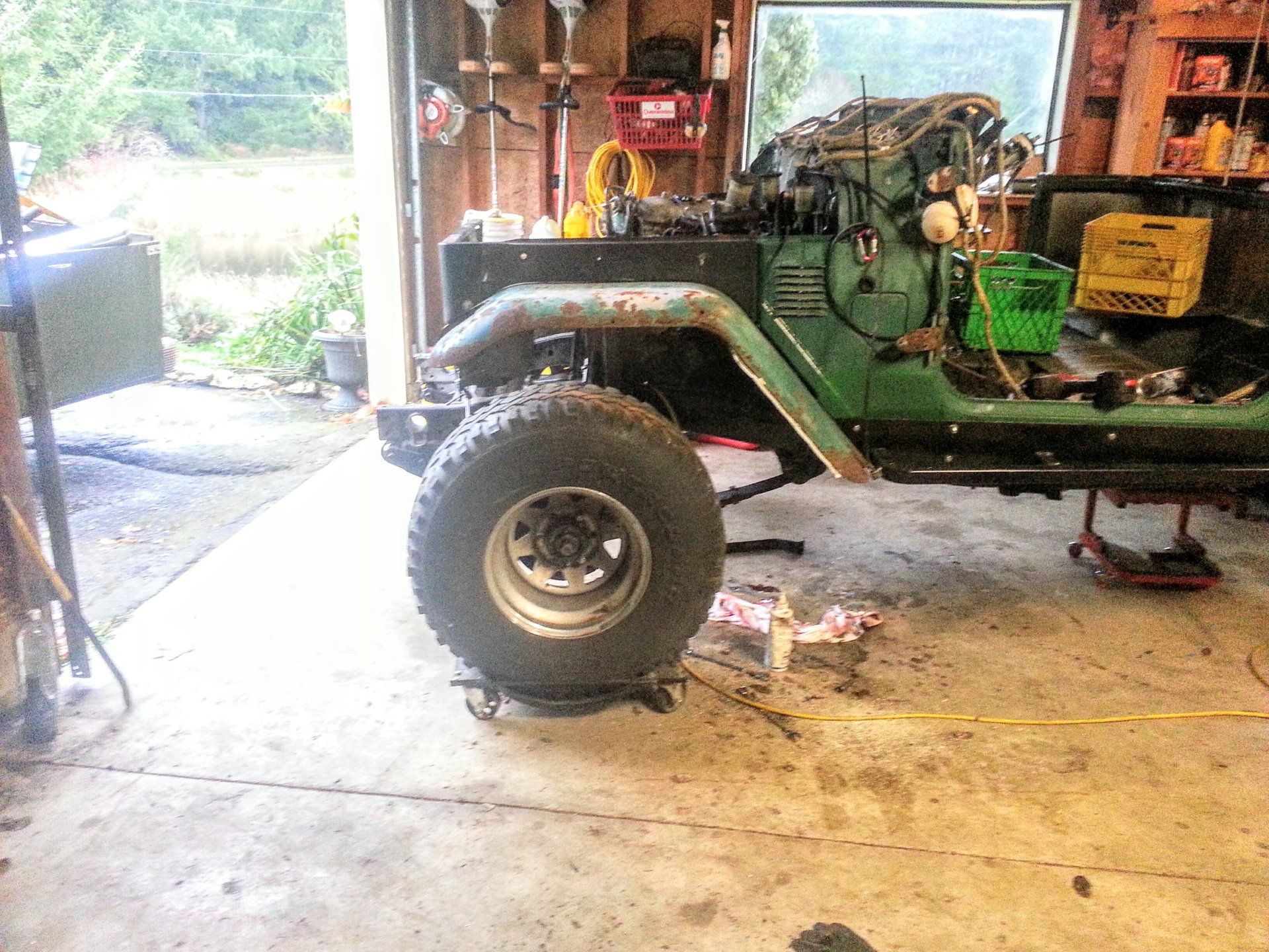

I had to throw it together to get a look at it outside, and do a clean up.

It's starting to look like the picture in my head...:lol:
Working tomorrow, not sure what we're doing today.
It's about 27" back from the cab. Could still push it back another 1.5", but I think this'll be ok. Really just about proportions and how it looks under the box.

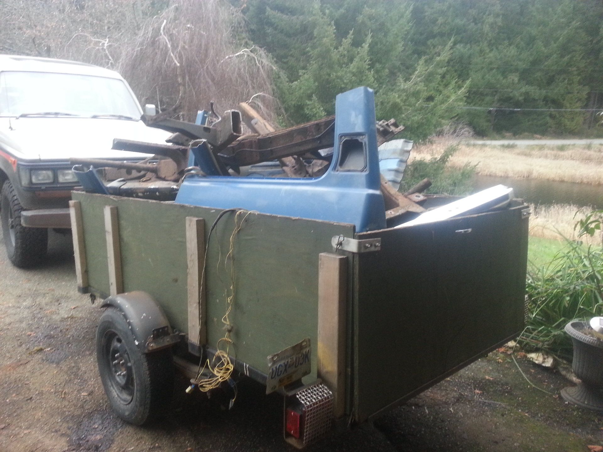

Foam in the wheel wells to keep the rust hole spray at bay... nice.
What are you doing, trying to fit a 60 in a utility trailer?
Pretty much.
Basically, I needed a bunch of stuff out of it that would render it immobile, and the easiest thing would be to let some scrap junkies come take it for free, but I'd rather waste a day cutting it up than let those skids anywhere near my house :cautious:
