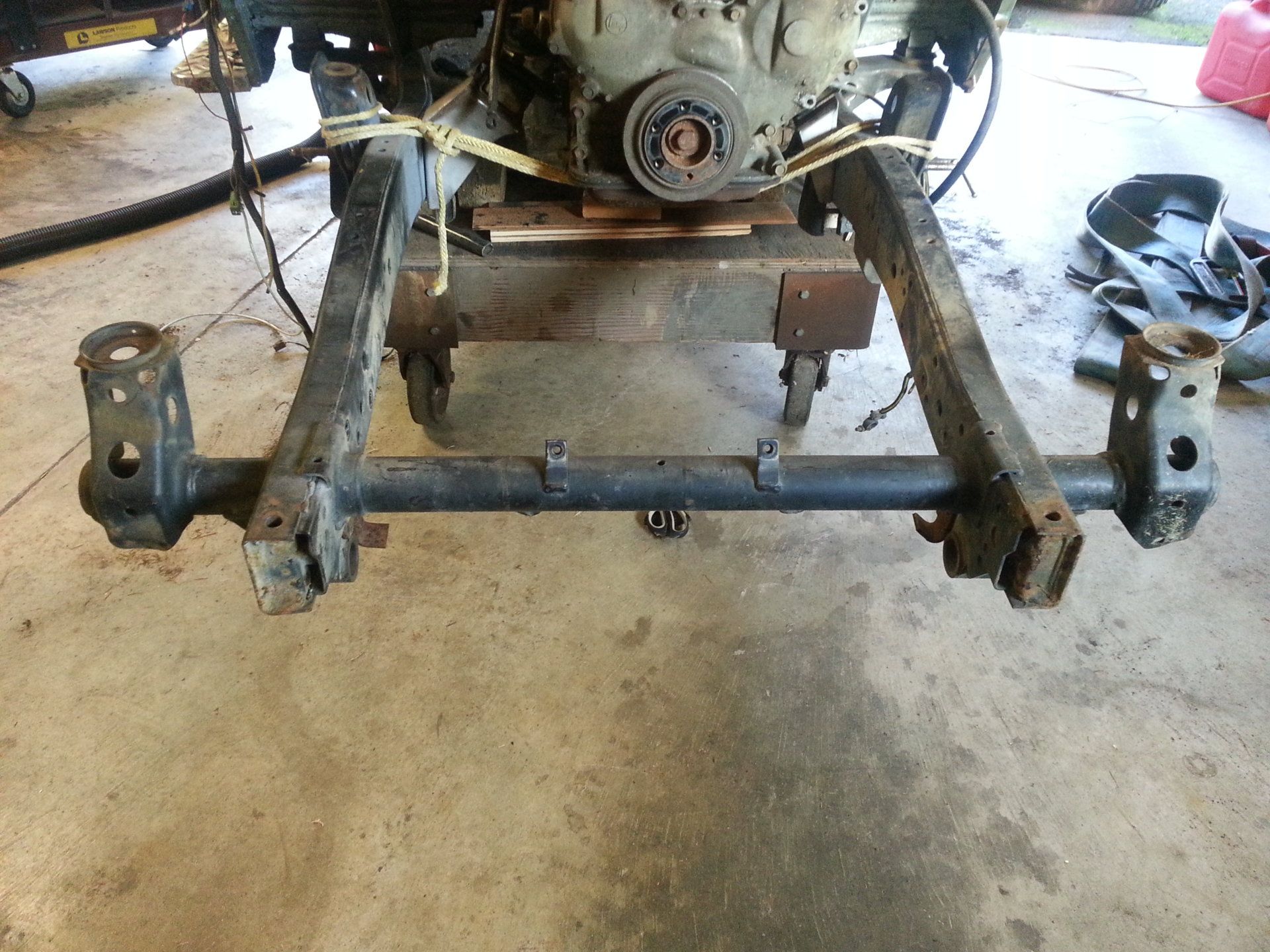

I'll need to temporarily assemble the front clip to get that thing in the right place. Maybe I'll give it a soak in some rust potion so it doesn't infect the newer frame :lol:

some front clip ****ery.
That 33 is sitting pretty close to where the stock bumpstop is. Hard to say 100% without a fender mocked up, I need to remove stock shock mount to get fender in right spot, but. ...the shock mounts are kinda holding up the engine at the moment. :hillbilly:

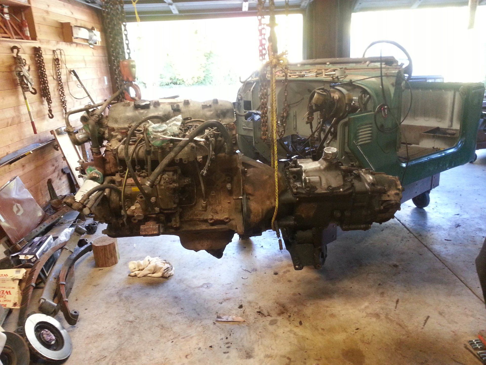

Ritual disembowelment of a bj60...
I left the greasy 3b in the 60, and using the one I got from up island. Has half the miles and 1/100th the mung on the outside so may as well give it a shot. Won't have to worry about the other one rusting while in storage...:lol:
Crammed it into the hole, and missed a photo opp of swmbo with AISIN imprinted in her hand when she made the mistake of walking by and offering to help as I was trying to lever this heavy ass lump into place and the crossmember got stuck...:rofl:
Tcase is just sitting on the cart, but I think the height isn't bad. I'll deal with rear mounts and such when I pop the body off again. Need to get it about an inch further back to be close to stock location I think. May also peak under that pto cover and see if the gear is in there. If it is, I think I'll steal the pto box off my 61 and put it on there. At some point I want to find a use for that freakin' thing.
