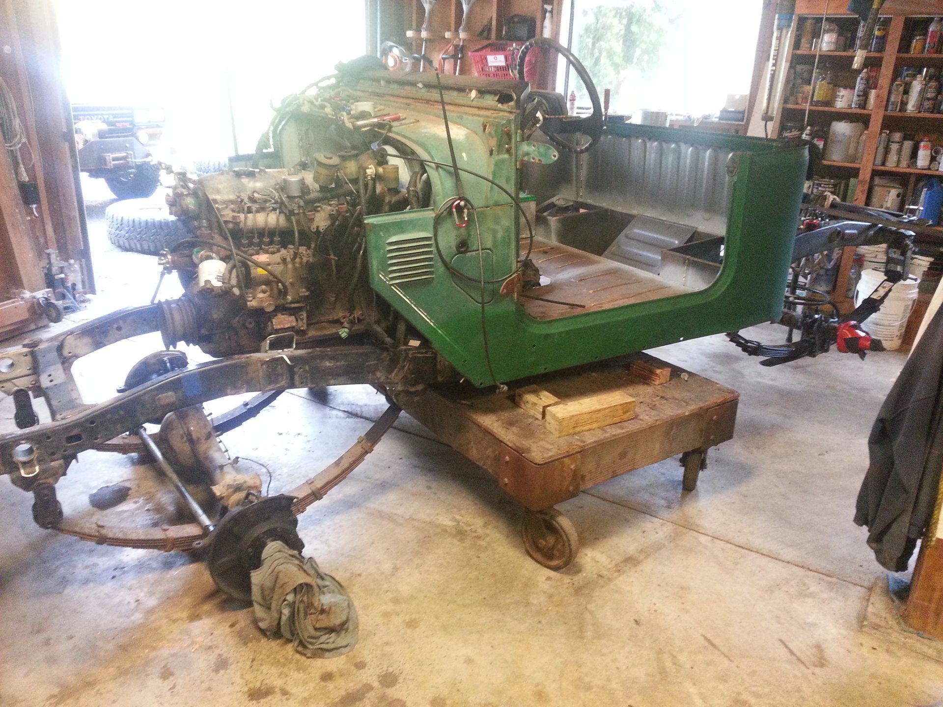

Today started with a fairly awesome hangover....fortunately Brett visited at about 830 and dropped off a case of beer otherwise I probably wouldn't have accomplished much...:lol:
Anyways, I started by turning the cart sideways, it was getting in the way.
Once I could properly test fit the rear driveshaft, it was actually a smidge too long, so I flipped the springs. It's now a bit short but I can deal with that later .
Shock mount tube is in right place now which is a bonus .
And now to instantly make it look like I've done ****all I lifted the body off to do some welding underneath it.
Probably build an exhaust and deal with crossmember mounts at the same time.
