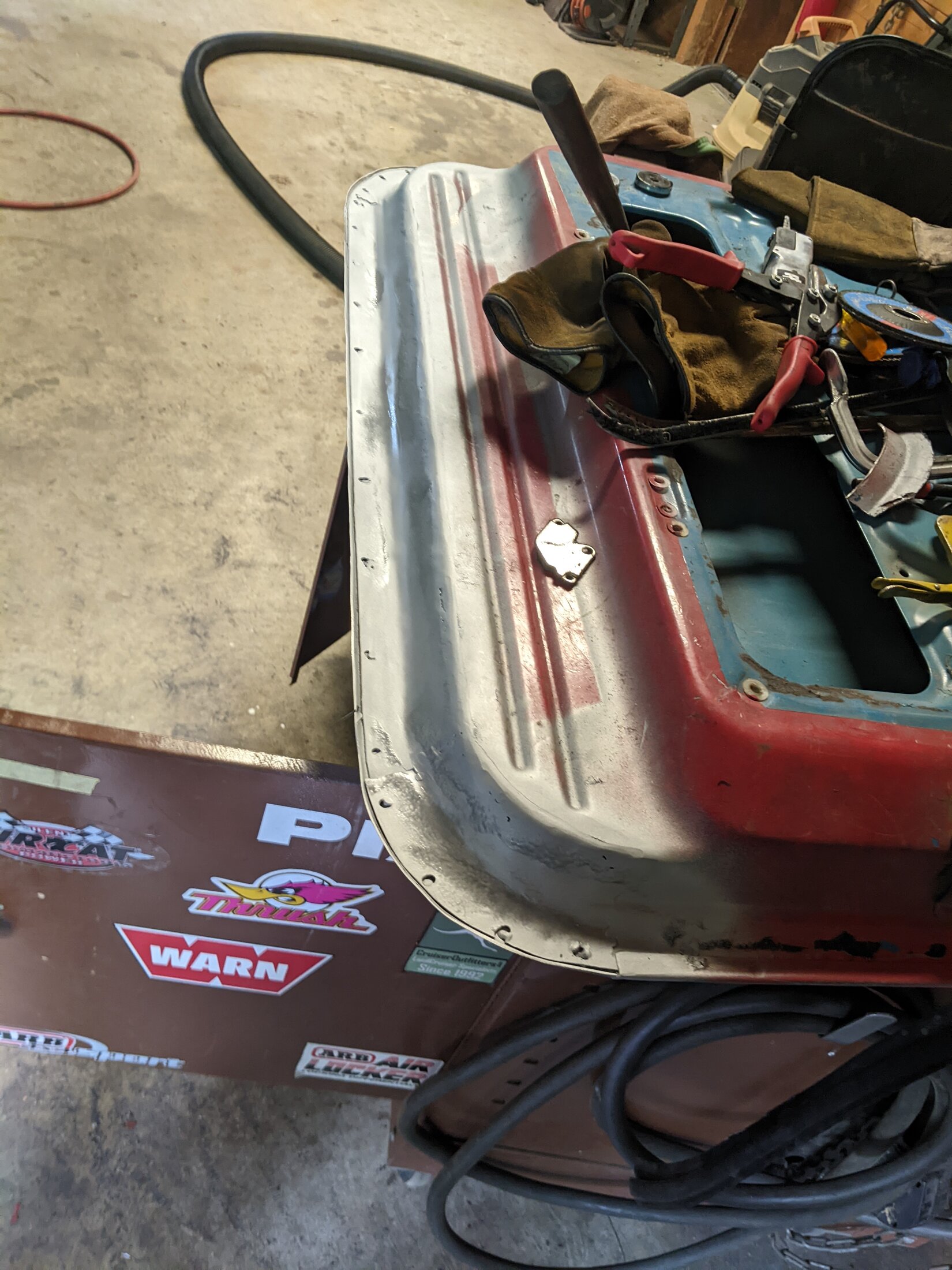

With the door bottoms, they're not bad. Jig has a limited lifespan, the lines will get less crisp with each one, but I can probably get a couple more sets out before they're too beat up.
And I'm calling that good enough.

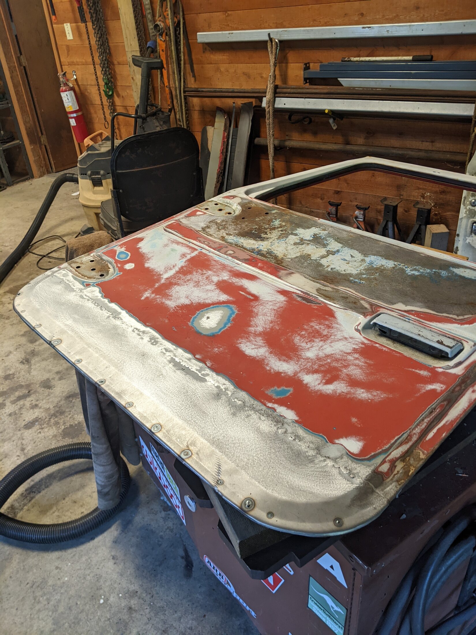

I flipped it back over to give it a sand. the white is pretty s***ty so it needs to come off. Sanding picks up the low spots, it's actually pretty good except for a couple 2 inch sections of the weld seam.
I'll have to decide if it's worth slitting and re zapping those...filler is calling ...🤣
Overall, the door is slightly concave, just went to check and it's flatter than the door on the cruiser right now. :meh:

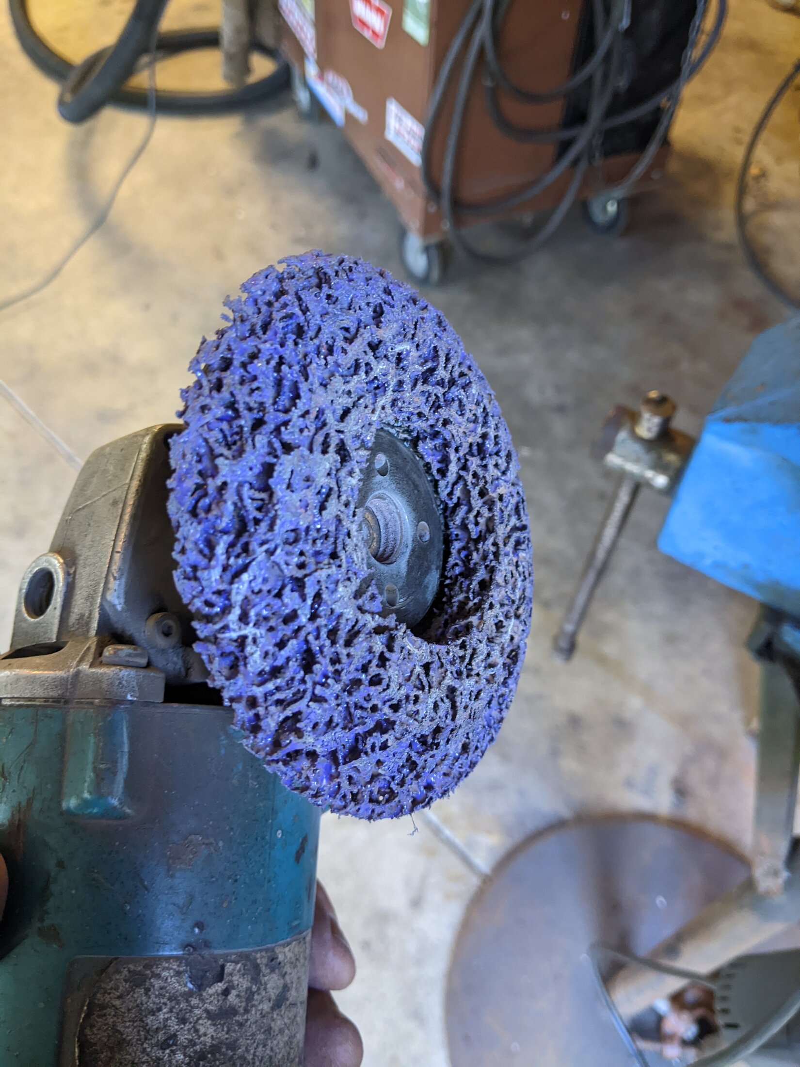

Neighbour gave me this a while back. It's like a plastic scrubby on a grinding wheel. Awesome for ripping off paint without removing any metal.
He's an old hotrod builder...the nicest cruiser on earth wouldn't rise above "bush truck" with him....so you can guess where mine lands 🤣🤣

Gave it a sand so it looked less like it was dragged out a swamp 🤮
Looking at all 4 of my 40 doors, they're all a bit concave in one way or another. 50 years of slamming shut, or one fat guy leaning against them I guess.
Can't really tell by looking at them, just when you lay on a straight edge.
This will be annoying to fix as well.
