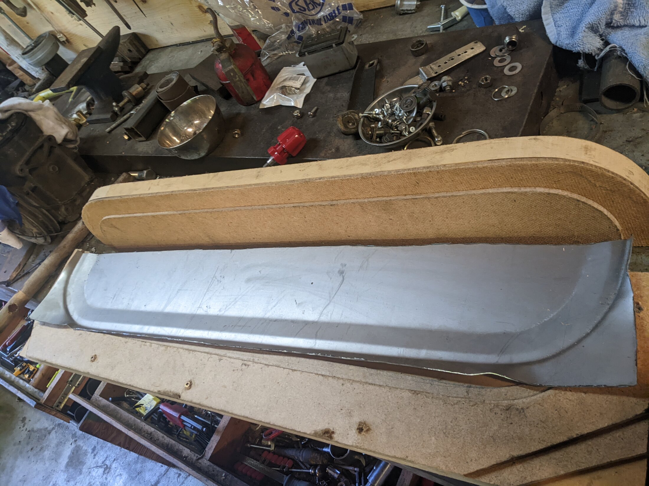

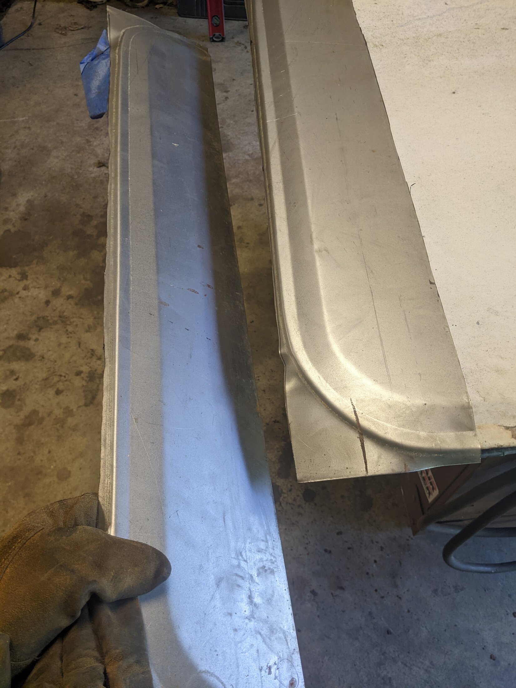

Got some doors from @stevebradford a while back, thinking I'd make some half doors.
Now I'm thinking rather than chop up a semi half decent set of doors , I'd patch them up, then decide if I'm going to cut them.

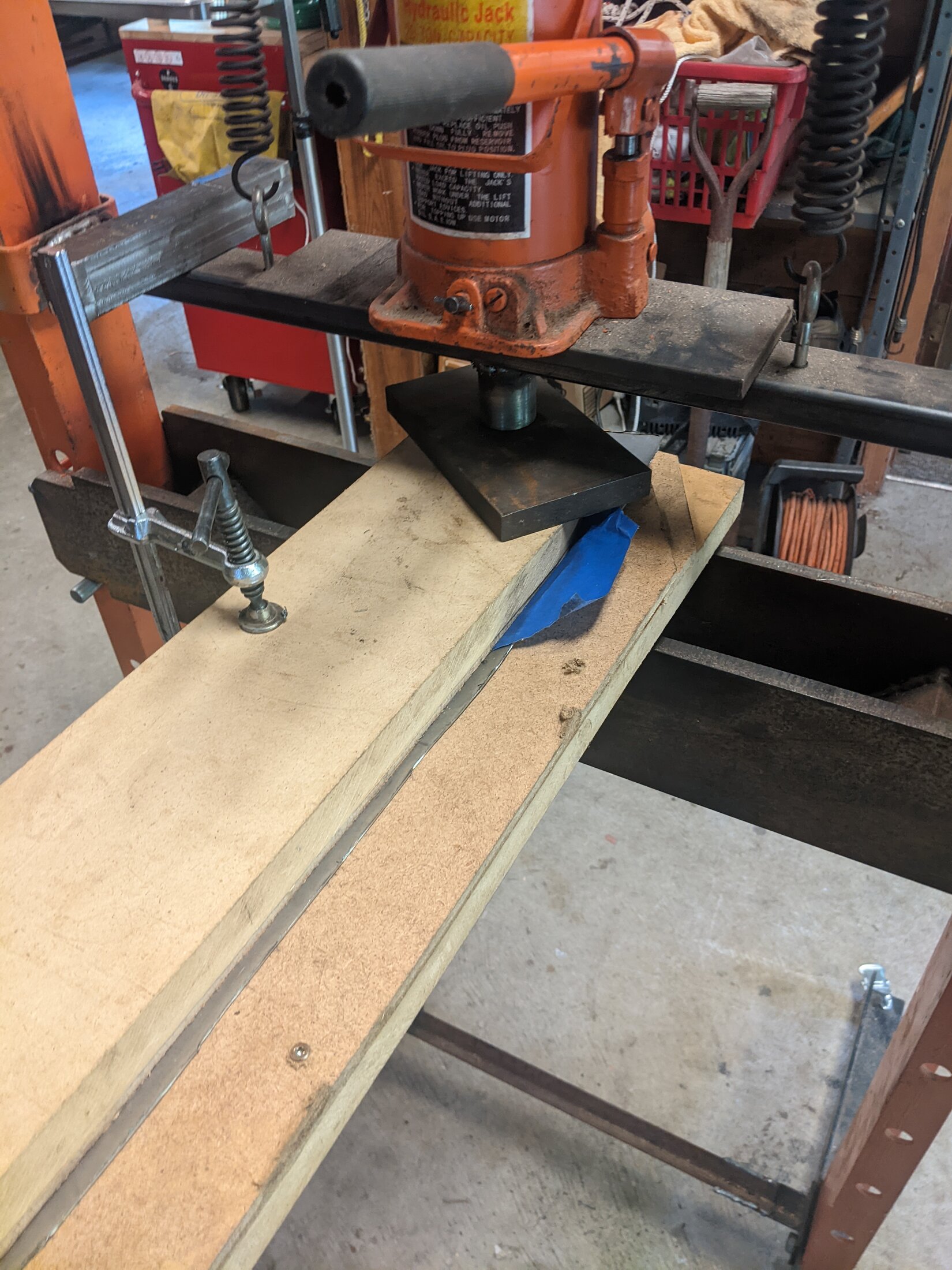

My high tech door bottom presserator survived another set.
Doors on my truck aren't great. Look ok on the outside but the inside bottoms are a bit fooked. I'll see if I can figure out something for patching those too.
Occurs to me I could damn near make a whole skin for a half door with this contraption... :hmm:
I have to say that’s quite impressive. I’d agree that you’re not that far off build half doors from scratch.
Id be inclined to do something very similar… if my doors weren’t flat from the factory.

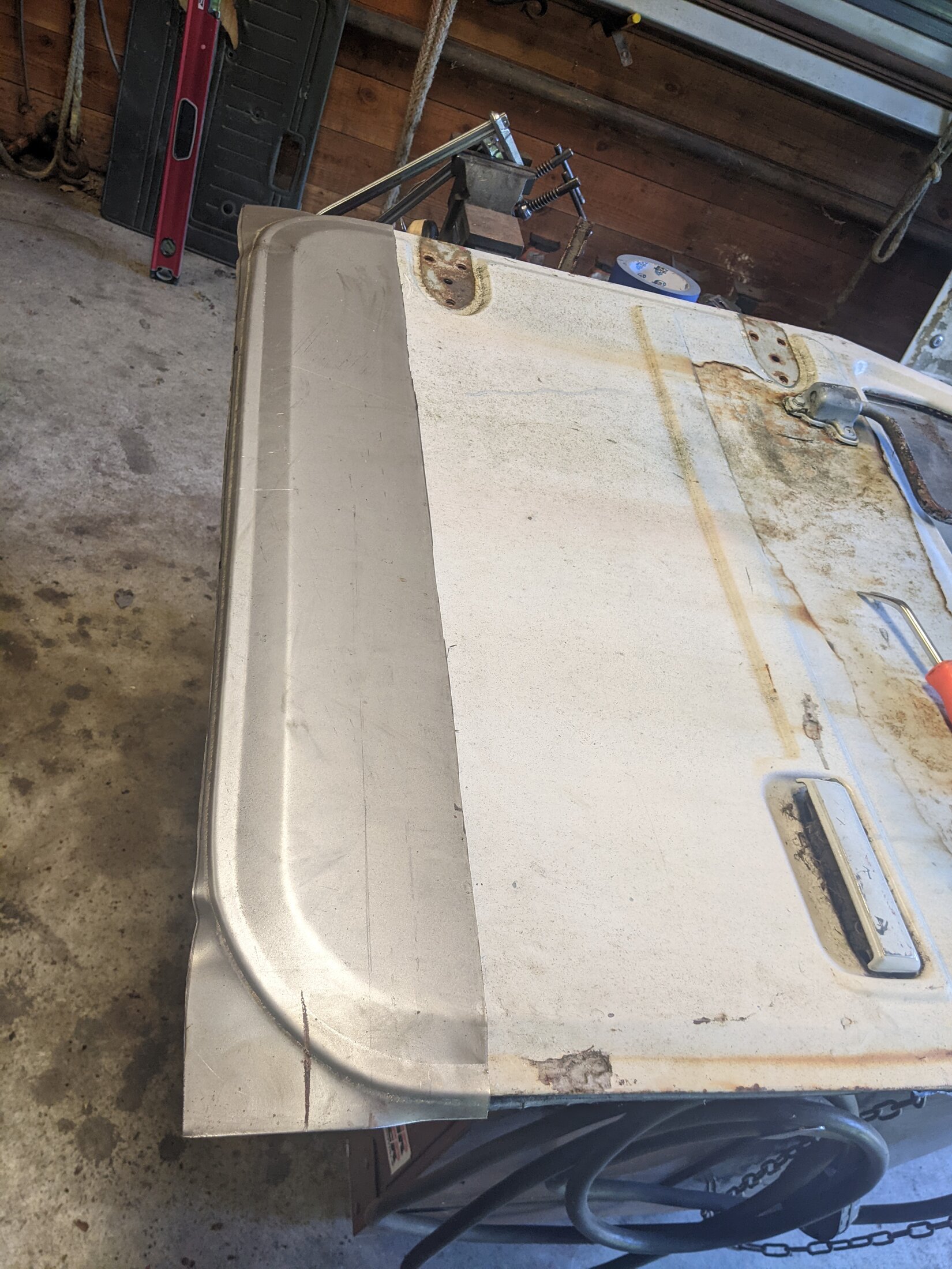

Maybe if I had 100 years of doing nothing but 40 door bottoms, I'd get one perfectly flat.
Probably would jump off a tall building before the end of year 1 tho.
Anyways. Not perfect, not terrible. Considering the current cost of zero dollars , I can live with it.. :meh:

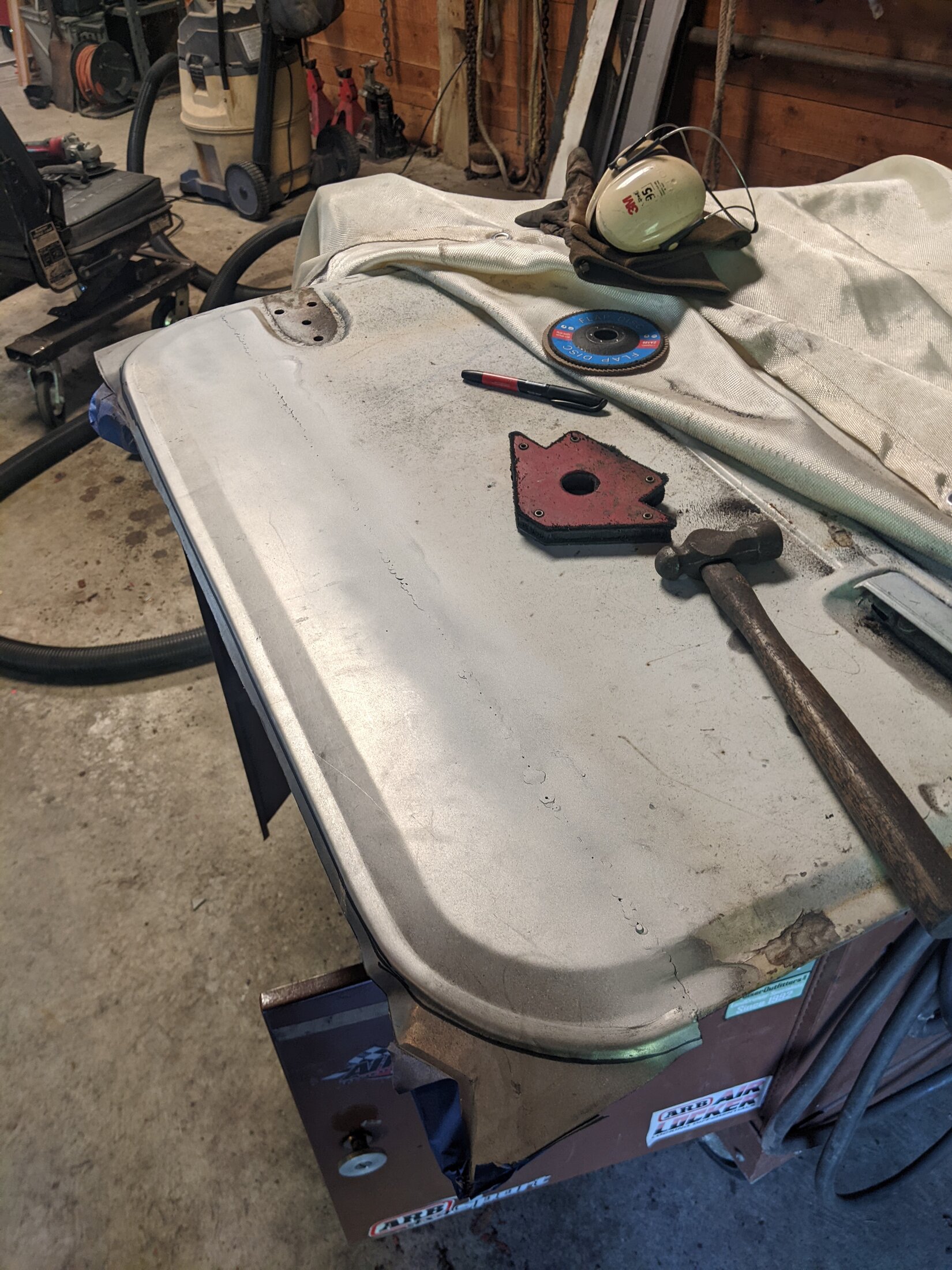

I'm happier with the stamping panels portion than I am with the installation, but honestly I think this style of 40 doors might be the hardest fix to not warp on a cruiser.
Dead flat and the way they're made there's not even any tension to keep them from oil canning one way or another.
I still need to grind the welds down a bit more, and touch up a few spots. Then figure out something for the inside.
Bright side, welder is noticeably different now that it's not drinking a milkshake through a straw😁

I absolutely hate filler… almost to the point where I’d rather see where the patch is.
But many new cars have a skim here or there when they left the factory. And since we are driving around old tractors that will rust again I’d agree that there’s no reason to sweat it.
Meh, it's fairing compound. A light skim doesn't offend me, if it's just there to fill dimples in the seams.
I don't care about seams where you can see spot welds from the factory, but when it's a weld across the middle of a flat panel?
It should be invisible. :meh:
I just used a chisel to remove 1/8" of it from the top half of the door where it's a bit wowed in. Won't be doing that.
