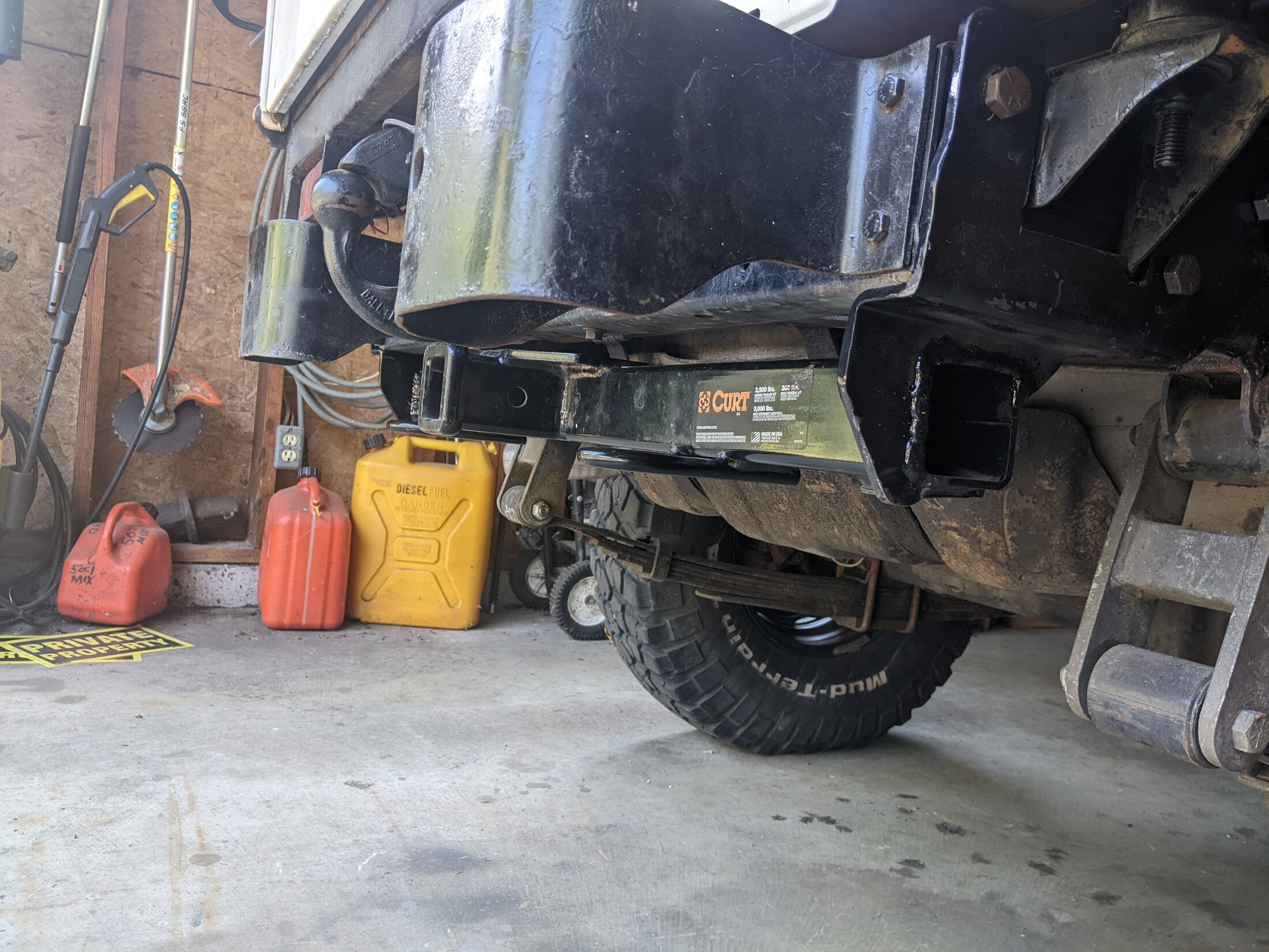

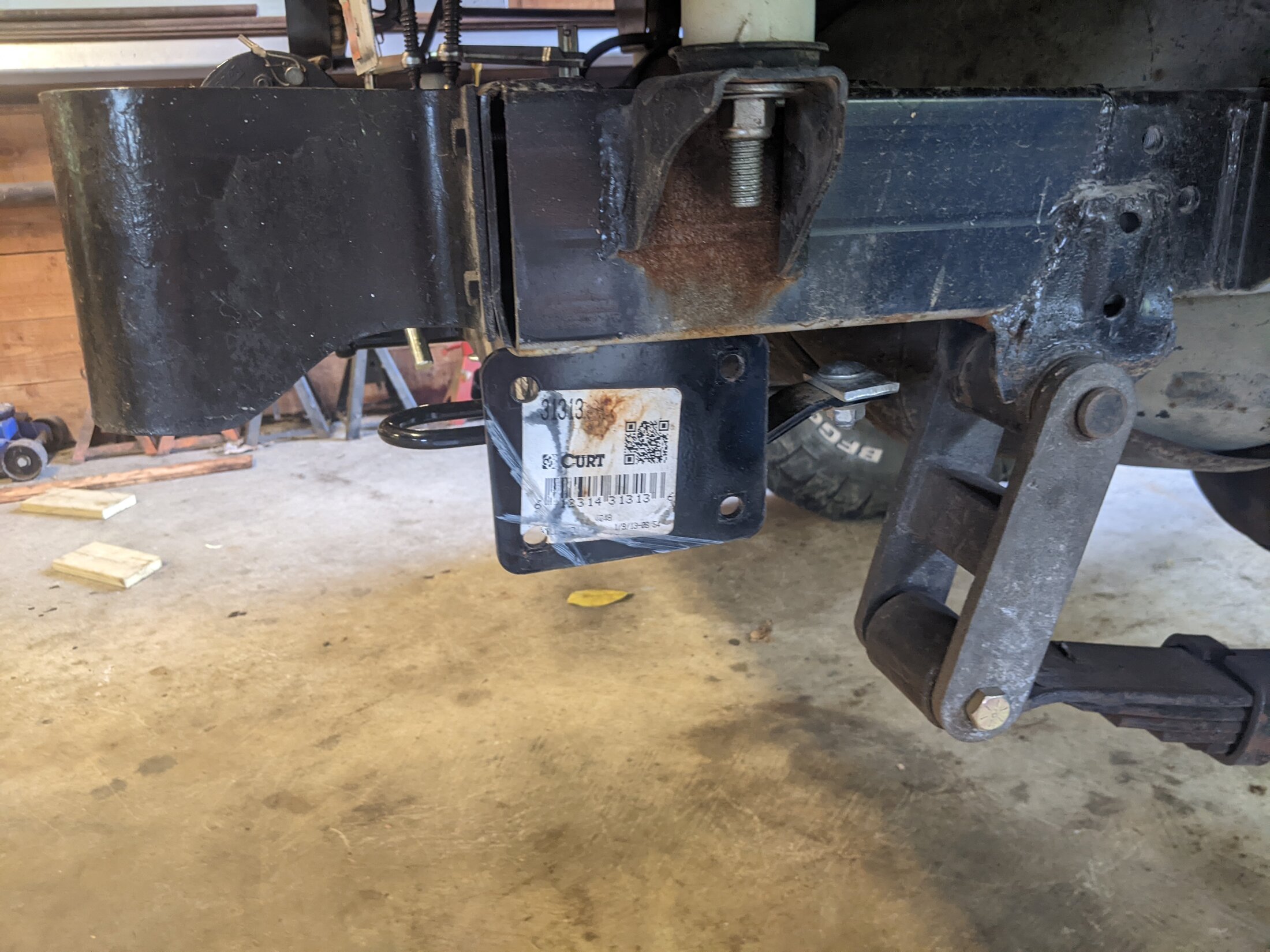

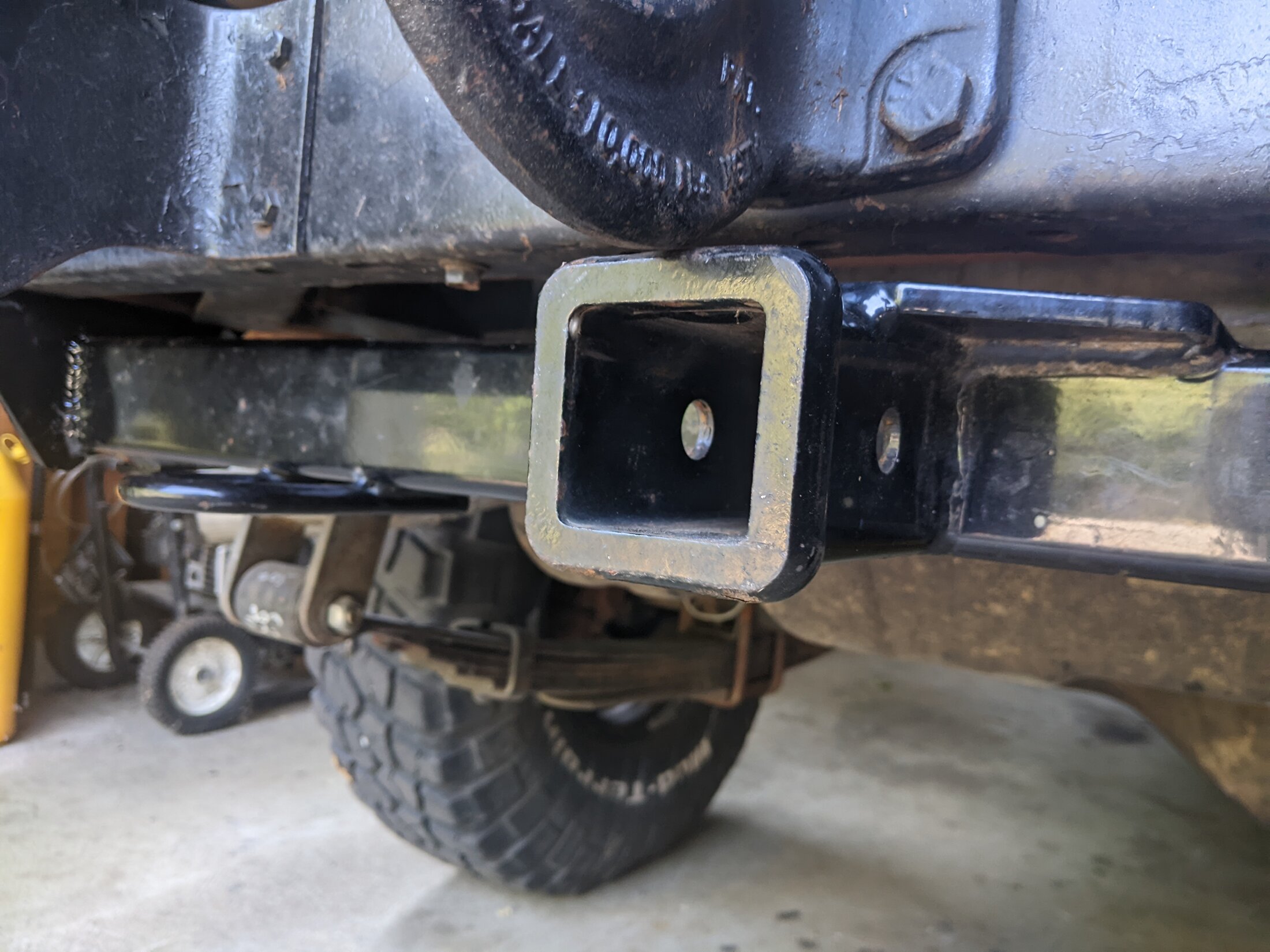

Happy to not be stubbing my toe on this damn thing anymore.
Friend gave it to me a couple years ago. Was for the front of his Taco, but not anymore...some adjustments were needed 😂
And done.
As tucked up as I could make it. :meh:
Not actually touching the pintle hitch, but it's definitely close.
Been annoying not having a receiver. Now to dig for that 5-4 wiring whizjammer. Reasonably sure I have one.
