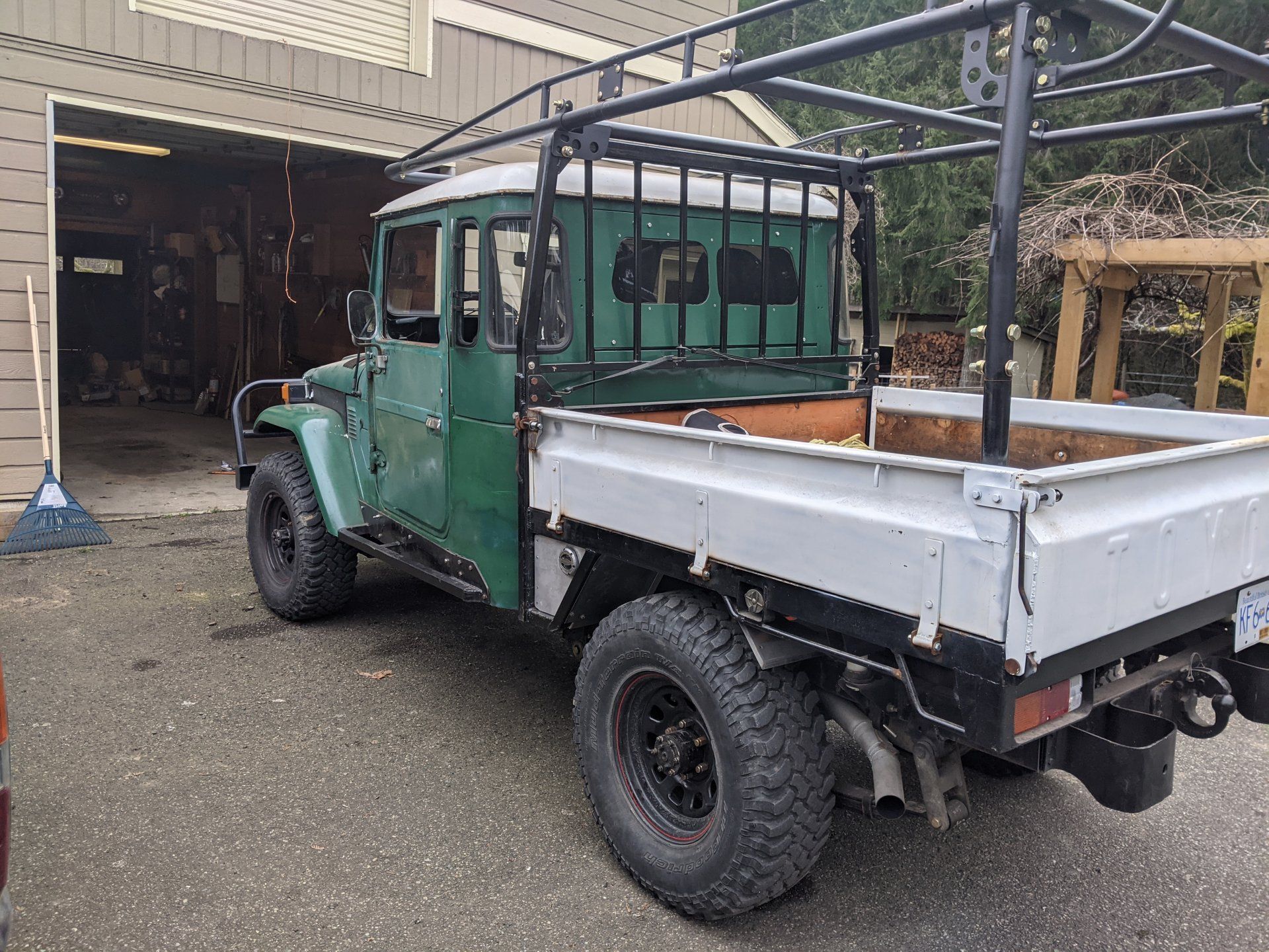

Backroad hot lap complete. :grinpimp:
Definitely perkier in high. Had 33x10.5's on last I drove it and now has 285's which are a decent amount bigger, and it still feels better. Real test is 5th, but the back road is a bit short for that :hillbilly:
Low is pretty damn slow, I need to get a hand throttle sorted, it's a bit surgy if left to idle in low, but that's no biggie.
Also a proper skid plate is on the sooner than later list.
We have a driveway gate now, and no ebrake makes that a pain in the ass, but we'll see whether I power the gate or install ebrake first. :lol:

Had no patience to deal with the tranny hump yesterday, I was kinda done.
After the test drive I shovelled all the tools into a pile, parked the cruiser, shut the garage door, and opted for couch and a movie. 😴
Insured this AM and went for a pretty long rip.
To say it drives better with the 10% underdrive is a wee bit of an understatement. Can actually use 5th on the highway now.
As for gear noise, it's quieter. I had a fairly loud gear/bearing howl before that I was worried was the transmission (only heard it in 4th) but I guess it was just a noisy tcase.
Output bearing was pretty toast when I pulled it apart.
Smooth as a gravy sammich now. Actually smoother and quieter than the 61 :oops:
Add to that , grand total to plate the old bitch for a year was $909 , so I'm having a good morning. ( was over 600 for 6 months last year)
I opted to go for the under 5000km discount. Figger I'll probably make it as I'm at 1001kms right now after a total of 9 months of being insured :lol:
