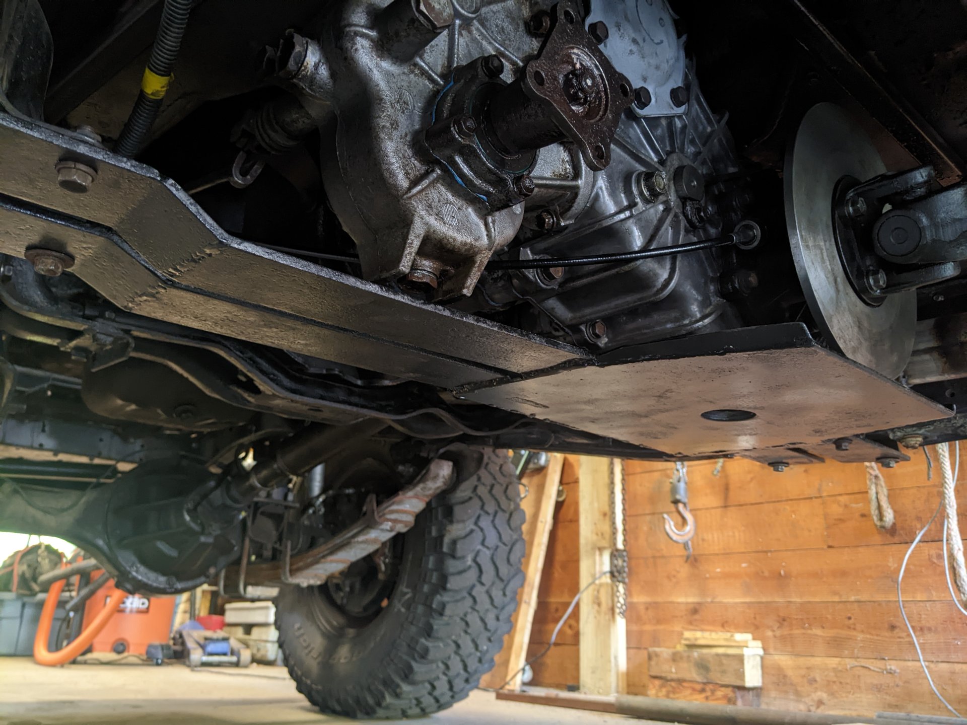

Finally did something to the truck...
Apparently when I said "next week" back in October I was a tad optimistic.
Took more like 7 months for me to build the skid plate than 7 days :lol:
Made this way because of the steel I had laying around. Lots of 3" x 1/4" flatbar.
Attached to the old 70 series crossmember brackets, which I left on the frame , because I thought they might be useful and more importantly, I was ****in sick of grinding.
Will probably add another smaller shoe on the PTO side. It'll make it a bit stronger but it's already pretty stout compared to the original.
I have a 40 series plate but it was a pain in the ass to fit with the wider frame.
Next will be the parking brake.

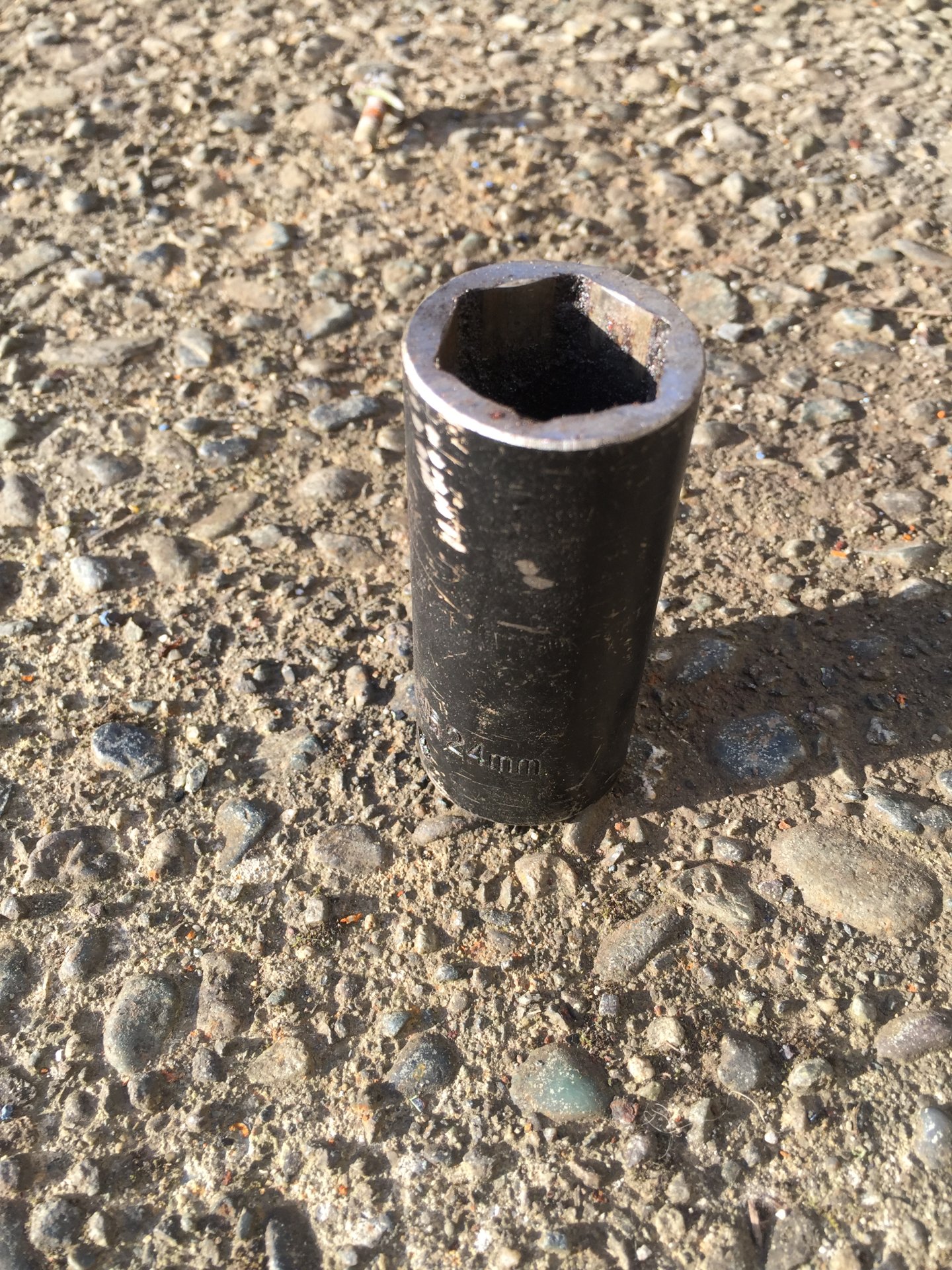

Ya know, just checking. Next time you are getting stuff from CruiserOutfitters get the new allen head
replacement drain plugs. So much nicer and easier to deal with.

How to tell if a guy is qualified to work on your antique Toyota:
Check his 24mm and see if the nose has been ground flat.
Ha, I had one of those. Lost it.
I should really do another one. Turn it down really short so the impact fits under the diff....:hmm:
I've been resisting the allen key ones, because, I hate allen keys. **** ikea man. ****em.
The Allen head drain plugs don’t clear the gears. I took about 1/8” off the end of mine so they fit.
But a 3/8” Allen head socket is a lot smaller than a 1/2” drive 24mm socket to pack. Easy fix
thought I read that the allen drain plugs might not clear the low gear sets like you're running.
Got plans for that rear facing PTO output?
Well that's a good enough reason for me not to bother with the allen plug.
