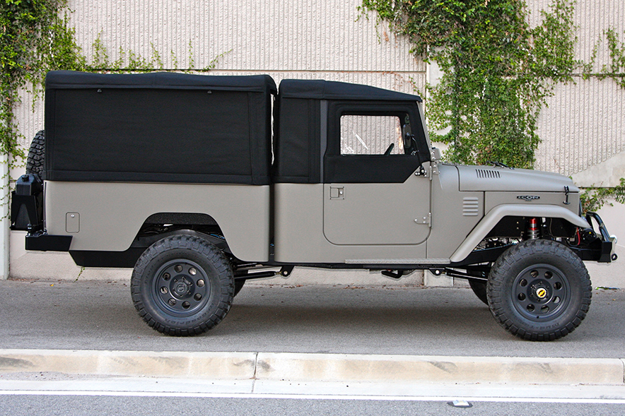

Ih8 roof on day.
At least I could use the hoist this time, still a pain in the ass.
If I had a few extra thousand kicking around I'd buy one of these tops and throw this s***ty tin lid in a dumpster.
Only the front bit. Dimensions look fairly close.
Being "icon" they probably pad the bill with a few thousand just to make it the most expensive. :rolleyes:
Still might have to look into soft tops and modify something.
That thing looks like a prop in "EXPENDABLES 4" with another big name bald wrestler driving it.
