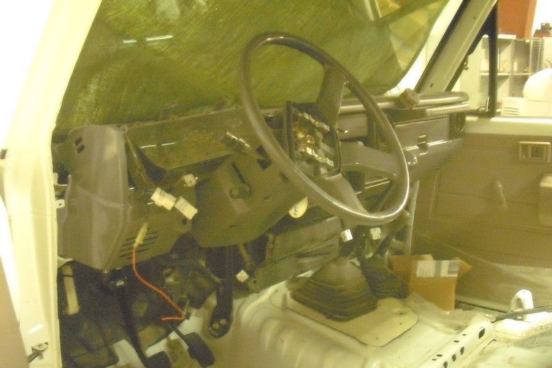

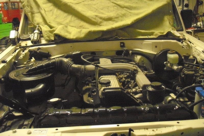

Well it has been awhile since I have posted the progress on the PC6279 That's what we have officially been calling it: Proffitt's Cruiser FJ62 HZJ79 = PC6279
Anyways, frame is back from the powder coater and body is assembled on the chassis. ARB rear locker is in. Dash is mostly in. 1HZ/H55F is in and RUNNING!!! It's heading to the exhaust shop soon.

-finish dash
-mount seats & finish interior

Nice mate are you going to run a 75 series dash cluster or a elec powered 79 series cluster
I have a 75 series cluster that is original to the 75 I parted out. The cool thing is that the speedo/odo are MPH......it's the only one I have come across.

no turbo?
No turbo as of yet. I want to see how it performs without the turbo and go from there. I drove the 75 for 8 months with no turbo and it was not that bad. I can always add a turbo later if I feel that I need it.
I actually have an AXT turbo kit but I was hoping to save it for the wife's HZJ80.
