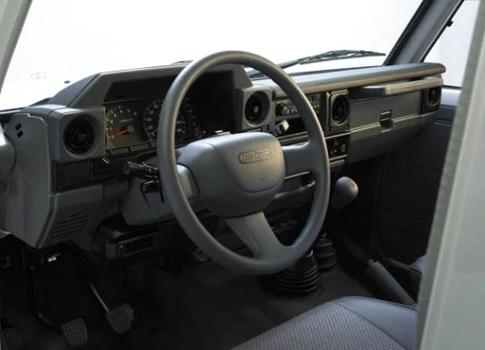

What are or have you done in regards to the steering column? Did you have to source a used one from overseas? The factory dash is available through Toyota? What about all the under dash electronics?

factory dash is available from Toyota.
factory wiring is available but not cheap at all.
steering column is available from Toyota but once again not cheap. it will be interesting to see if an adapter will be needed from the 7* series column to the 6* series box due to the length.

So, will you be using a 7* series column? Can used ones can be sourced? I would think mating the 79 series column to the 60/62 series streering box wouldn't be that big of an issue other than maybe needing one or two steering joints and a longer/shorter piece of steering shaft.

I just saw some interior pictures of the 79 Series the 80 Series steering column looks similar. I wonder how close a steering column out of an 80 Series would fit?
Interior pictures of dash and seat design.
