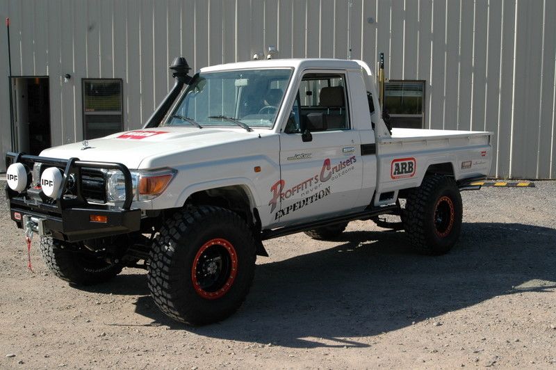

We have been working on this project for the past few weekends and quite a few late nights. It has all come together nicely and actually rather quickly. It's nice working with new sheet metal.
Here are some poser shots taken outside the shop. I think it came out pretty sweet. I have a few more accessories to add and it will be completely done.
Let me know what you all think.
Awesome! Will you be lining the bed, or are there no plans to haul much that could scratch up the metal? Approve of the white and red paint scheme, though I'd prefer other wheels.
Thanks!!! I will be lining the bed soon. I just have not had a chance to do it yet.
MRW gave me a pretty good deal on the bead locks so I decided to go with them. It gives it that "industrial look"

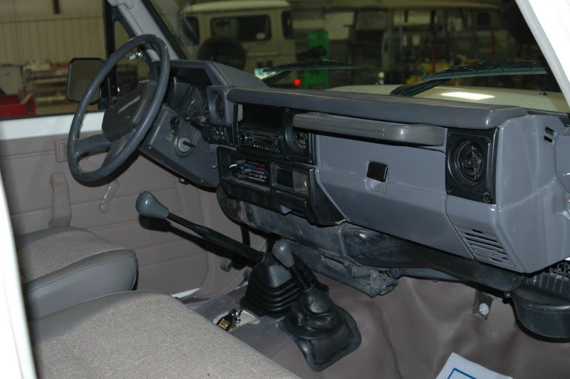

3. Can you give us some pictures of the 75 series dash installed? How well did the 75 series dash fit?
75 series dash fits like OEM......perfect.

AND......DONE!
Now with roof top tent and fridge!
Now to go home and load up for a rather large adventure.
Very nice looking truck...
Nice to see that the 75 series dash fits. You have any more... You wouldn't throw one in as a complimentary gift with my body by any chance??? With my build I think I'll try to paint/dye the door panels to match the gray dash or paint the dash and panels black so they all match.

Nice work this truck worked out looking great,
did you end up using 79 series rear springs ? I've read 75 rears but there same as 60 ay?
These are in fact, 79 series springs. 75 springs are a little shorter than a 79 spring and a bit different than a 60 spring. The 79 springs and 75 springs share the same bushings but are not the same.

observations:
i am surprised at how nice this looks, from the pics it looks like a factory truck.
bead locks, what ever turns your crank.
tent and mount, meh.
bumper, meh.
but as a whole package? WOW! nice.
<i always said the new 79 body style was a 60 looking truck, this is proof>
nice job, would love to see it in person. i think you are on to a attractive package that will sell well in NA.
congrats.
I followed the thread closely and wanted to give props for a clean truck that looks original!
bump to ya!
how u gonna see out the back window(rear view) can the rack slide down more? if slide up then stuck in wind, but as of now u cant see?
everything else looks sick!, rims r just the icing on the cake.
