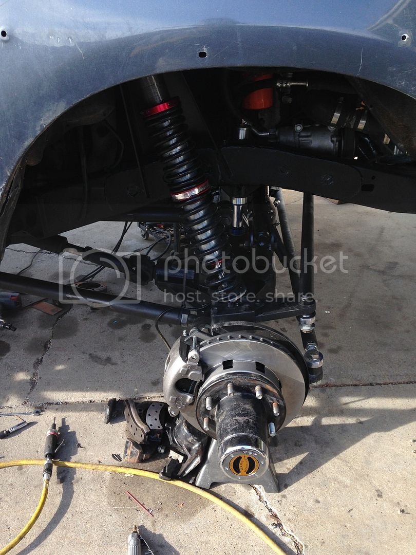

Added 35 spline warn hubs, 35 spline 4340 chromo stubs from ECGS, and 3/4 ton rotors and calipers using a conversion kit. Banjo bolt size is different so now I'm waiting on brake lines from Absolute hose and fittings in Reno. They're super nice and helpful!

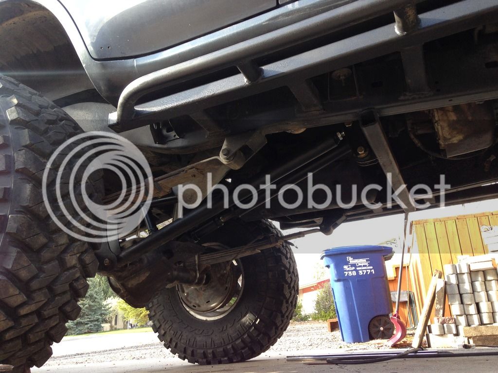

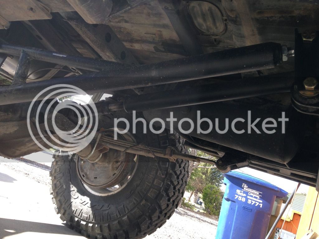

Added my anti wrap bar, mostly made from barnes bracketry, and using schedule 40 pipe and some hrew and some DOM and yeah...

Oh I also swapped my top springs to 300# springs.
What is your bottom spring. I'm only running 10" travel with about 2 inches of preload to soften up my ride with a 450 over 250. 450 on top getting locked out with 1" of up travel. I'm only with the 4bt weight though.
I always like to see other peoples thoughts on spring choices. I let a shop influence my first set years ago in a different vehicle. It was way off and needed a new set right away.
I have 14" c/os, running a 16" 350 bottom and 14" 300 on top. Still kind of playing with it but my ride height was getting low. I have barely any preload on it and I think I'm going to put about 1.5" on em. I don't have as much up travel as I was aiming for so I'm about 3/8" from sitting on my 3" stroke air bumps.
