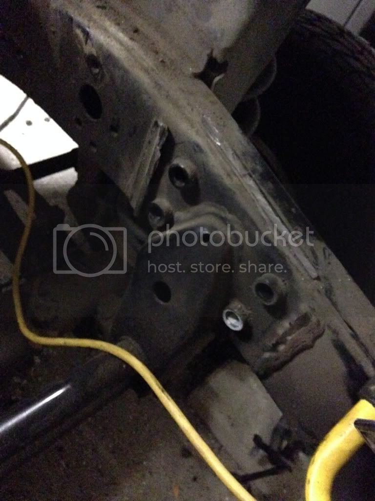

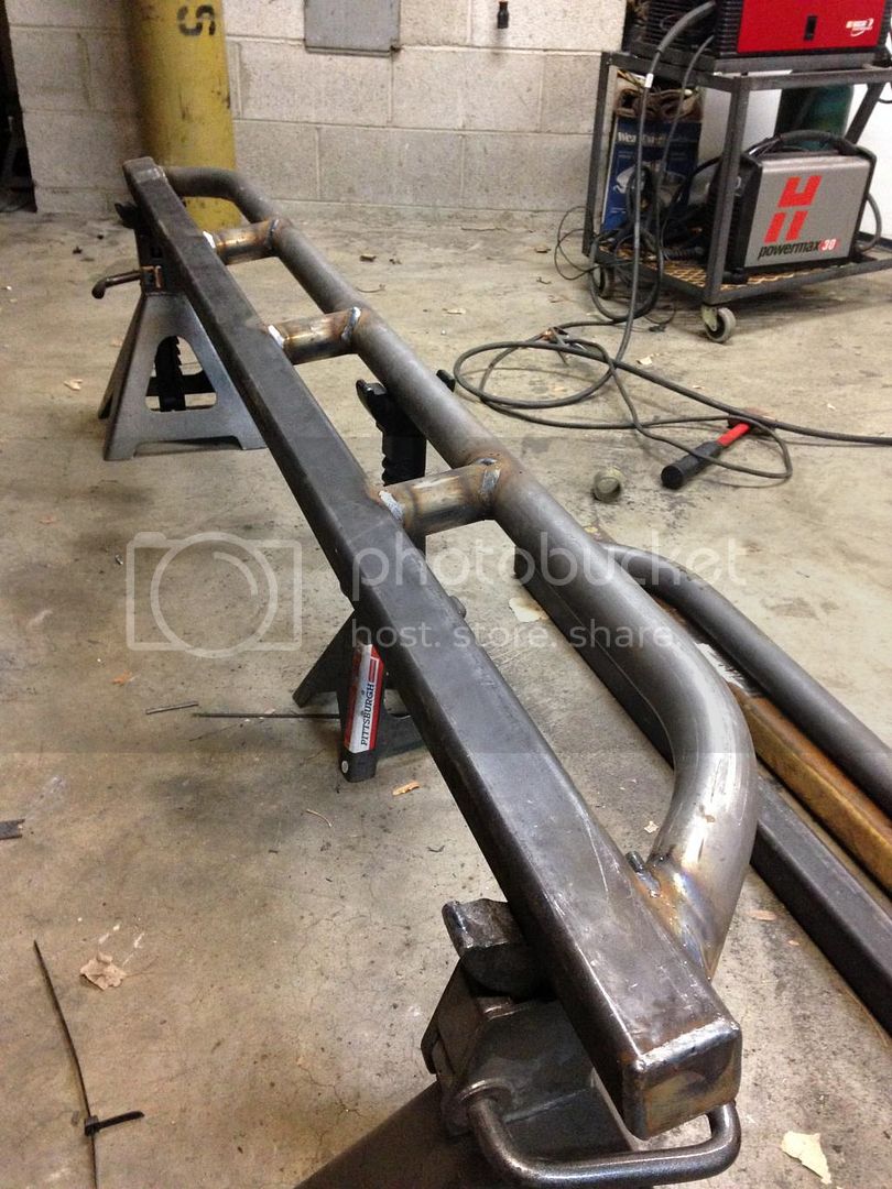

.25 scab plates, 2x2 .188 wall legs, ran out and wanted one more leg per side (for a total of 5) so I used some 1.5 .120 wall round tube for 1 leg on each side. They're on there good now.

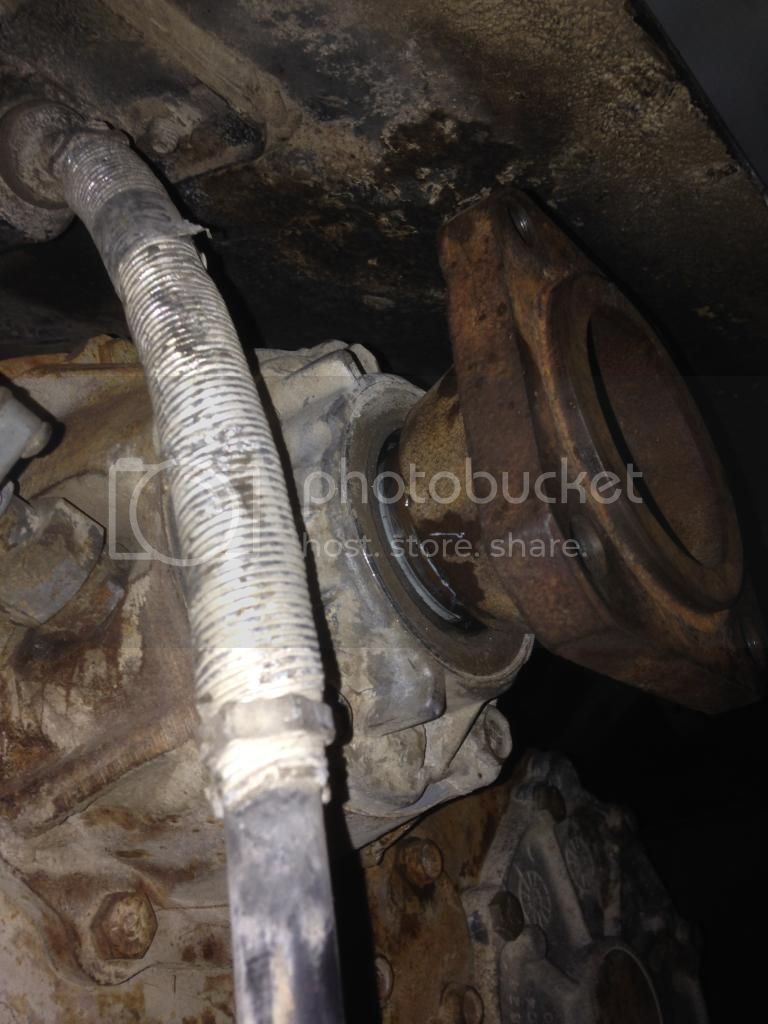

Had to swap the flange/yoke around, decided to run a Neapco 1350 CV in the rear to 1350 single joint at the 14 bolt and a 1410 to 1350 single joint single joint shaft in the front. Need to order a dana 60 1350 yoke as right now it's 1310 pussy s***. Driveline services of Carson City is building them and bringing up to me. Woo.

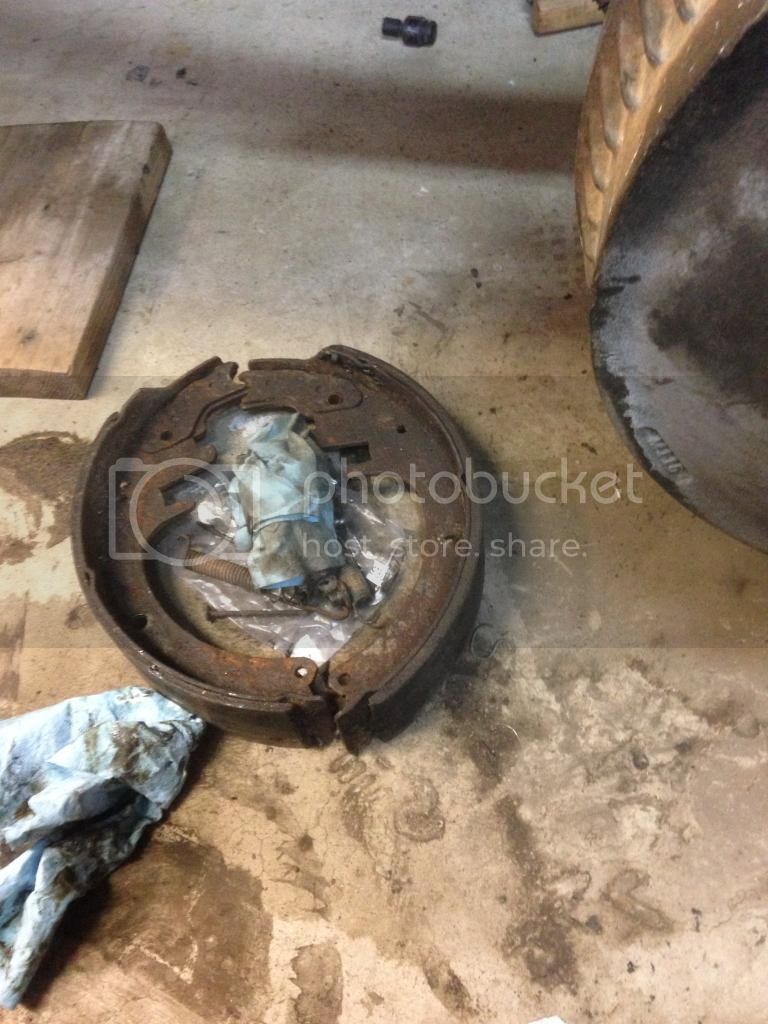

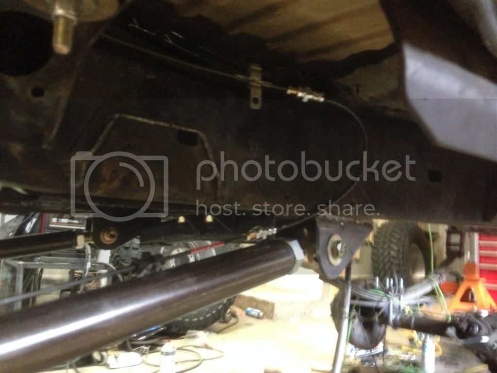

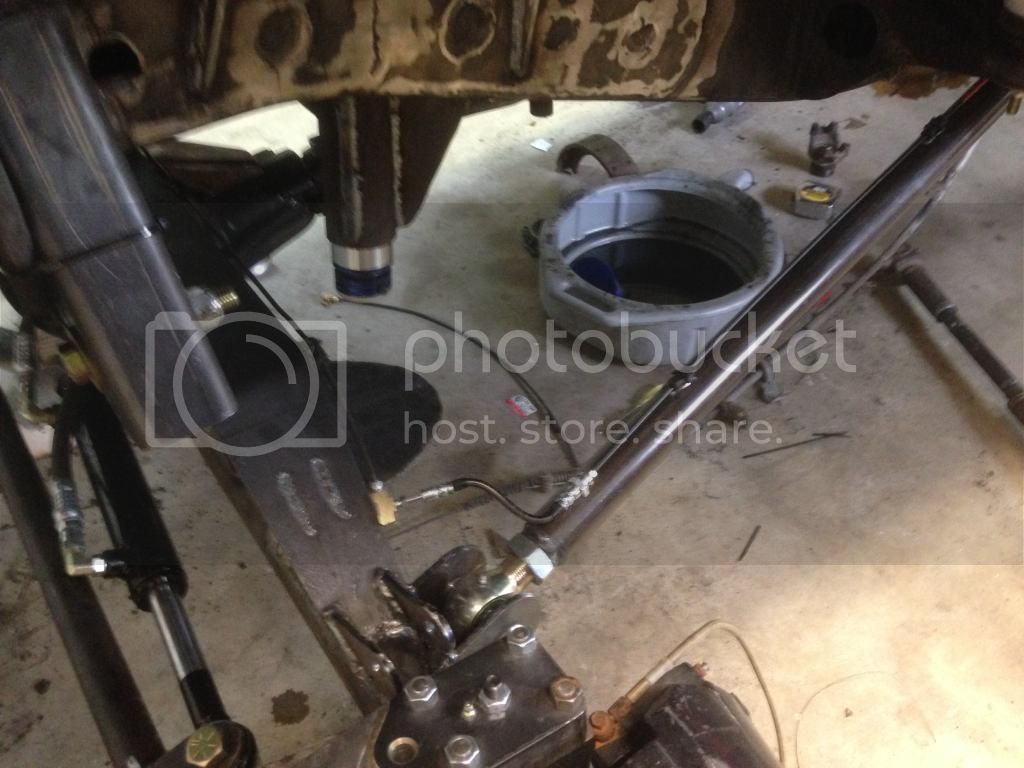

Did some brakes on the 14 bolt, still need to find a way to hook up ebrake cables.
Everythings welded now, I think.

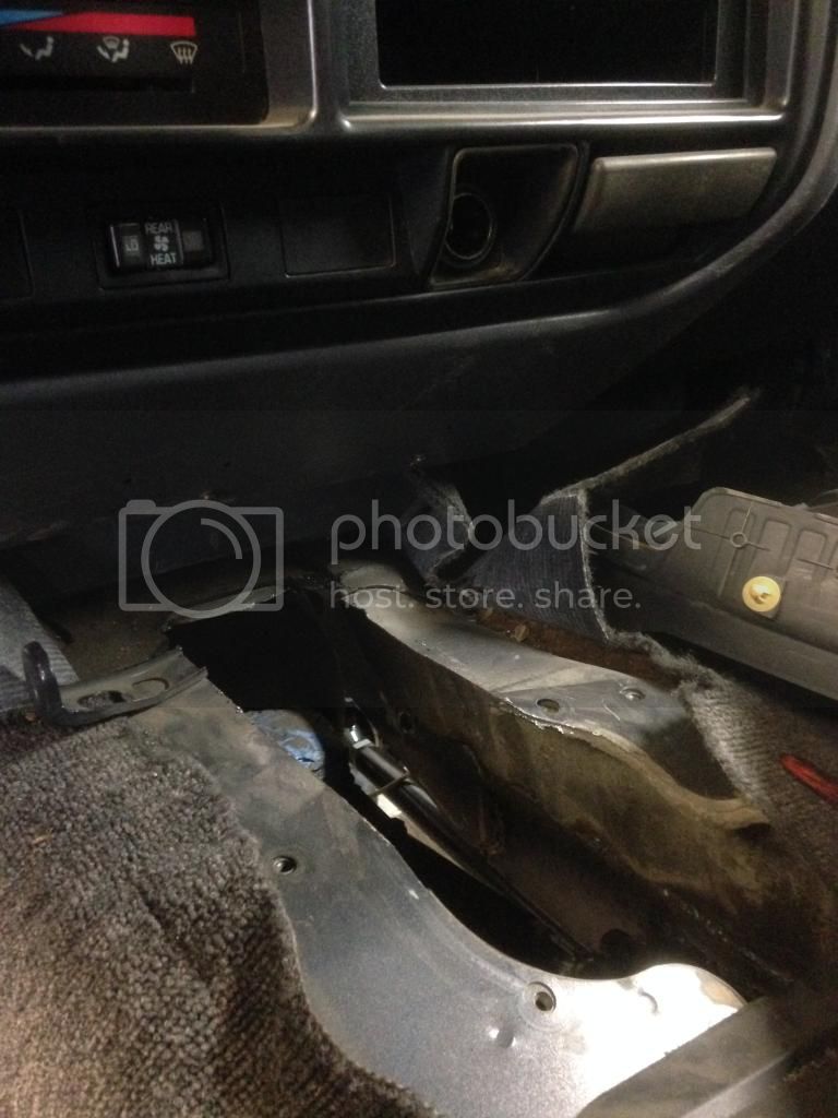

Cut a hole in the floor for the shifter.
My buddy turned this down for me and tapped it for a m14x2.0 which is what the shifter stub is, since I can't find a shifter anywhere for this Getrag. Make my own with pipe...

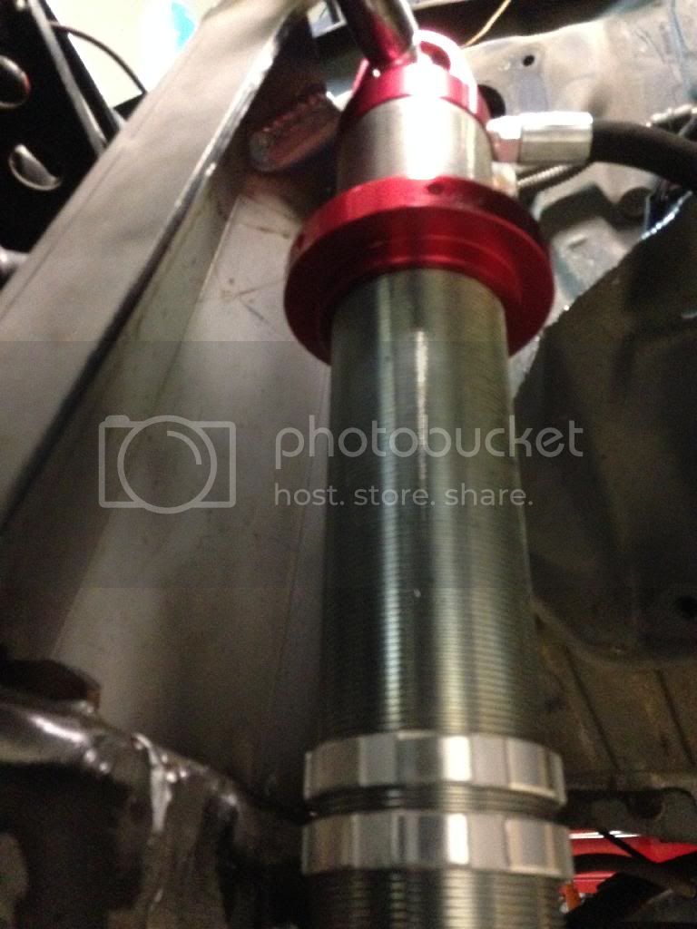

Having trouble packaging my air bumps.
Only place I can put bump on passenger side.
I don't think I should have any problems with it hitting during articulation. Other side could still drop an 1" but... Obviously I won't have the bump down that far in the can.
No where to hang the driver one but here. Dunno what else to do.

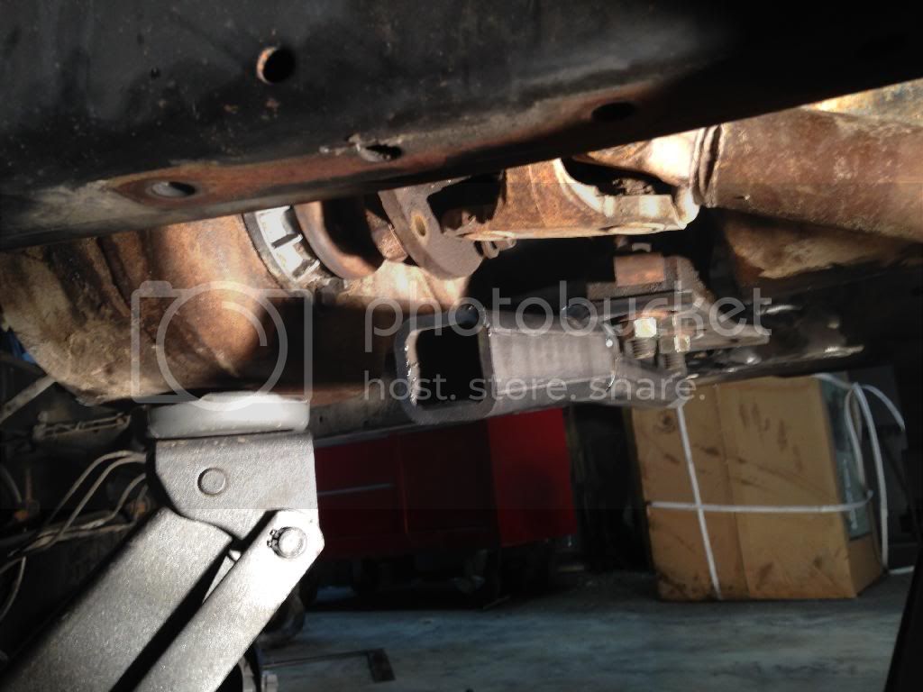

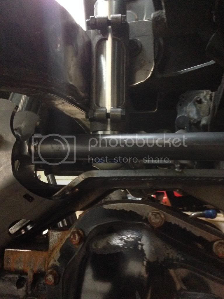

This is my other problem.
Almost at full droop.
2 3/8" clearance.
So I'm not sure if I notch the tower or if I run some borgeson joints or something crazy.
