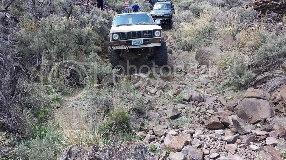

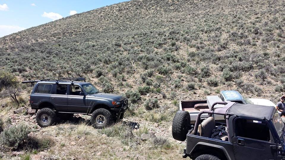

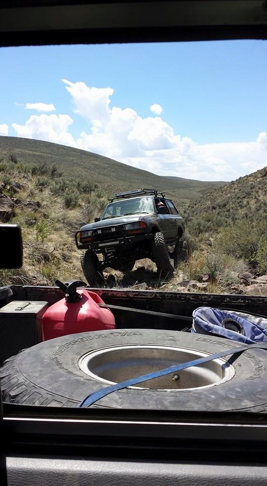

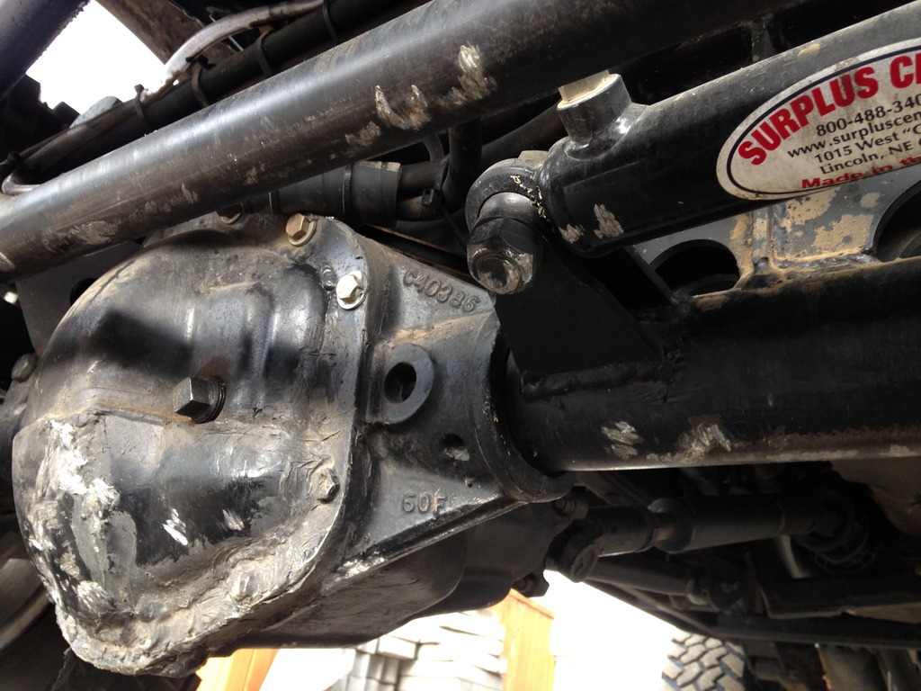

Did my first shakedown run. Everything worked pretty well, my fuel tank leaks pretty bad though, and my hydro assist isn't that awesome at low RPMs, and I got in a few spots leaning on the front tires pretty heavy and it didn't want to turn for s***, gonna have to look into pumps or something I guess... IDK I already modded the pump a little. Links and 63s work fxxxing awesome. It was a really long boulder filled dry wash. It was kind of comical, 1st gear 4low and I let out the clutch and it idled through almost every 'obstacle'. I only had to re spot in a couple of places, I actually did diff one rock hard enough it stopped us flat out, diff cover held up! Drove by brail and pretty well walked everything, better than a CJ on tons and 40s! There wasn't anything too challenging but it was awesome to ease right through things that I would have struggled with in the Tacoma on 35s. There were a handful of pretty stock solid axled rigs and they had a fair bit of trouble, lots of tire spinning getting hung up and spotting, it was pretty slow going. 4 door JK rubi on 35s had quite the time.

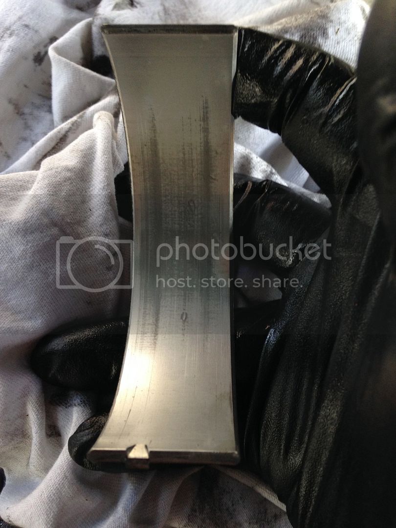

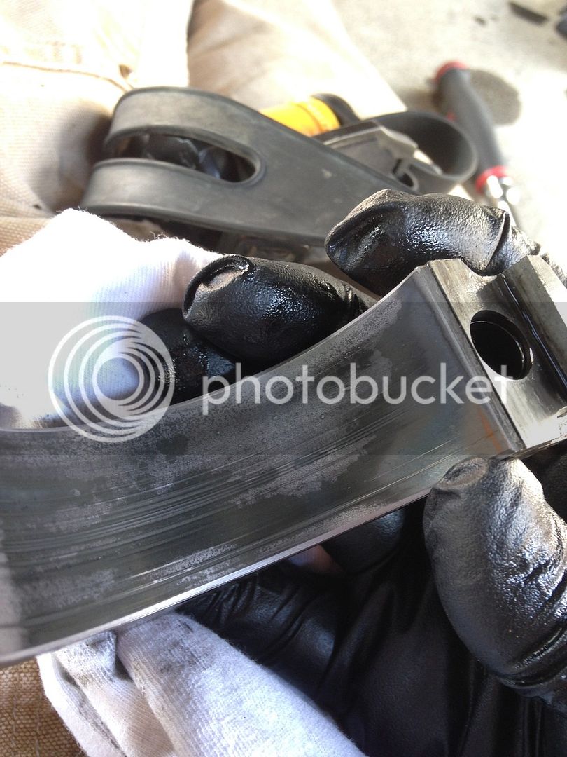

Pulled the pan to reseal and so I figured I'd pull a rod and main cap while I was in there and check out bearings. This was #6. Looks okay for somewhere north of 200k!
