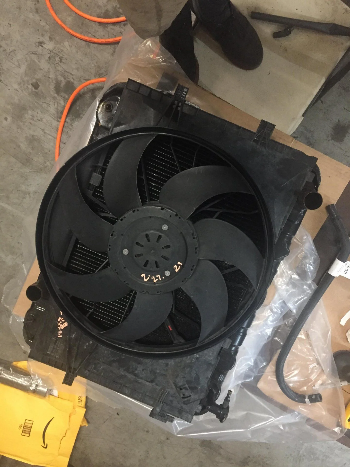

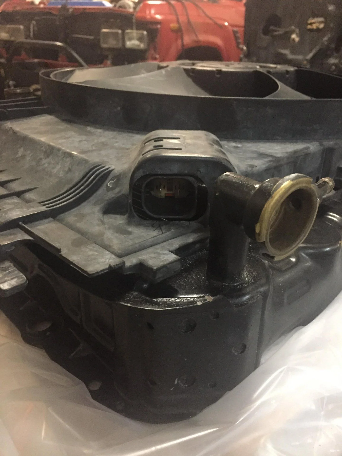

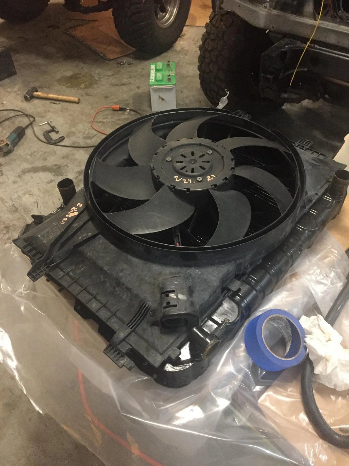

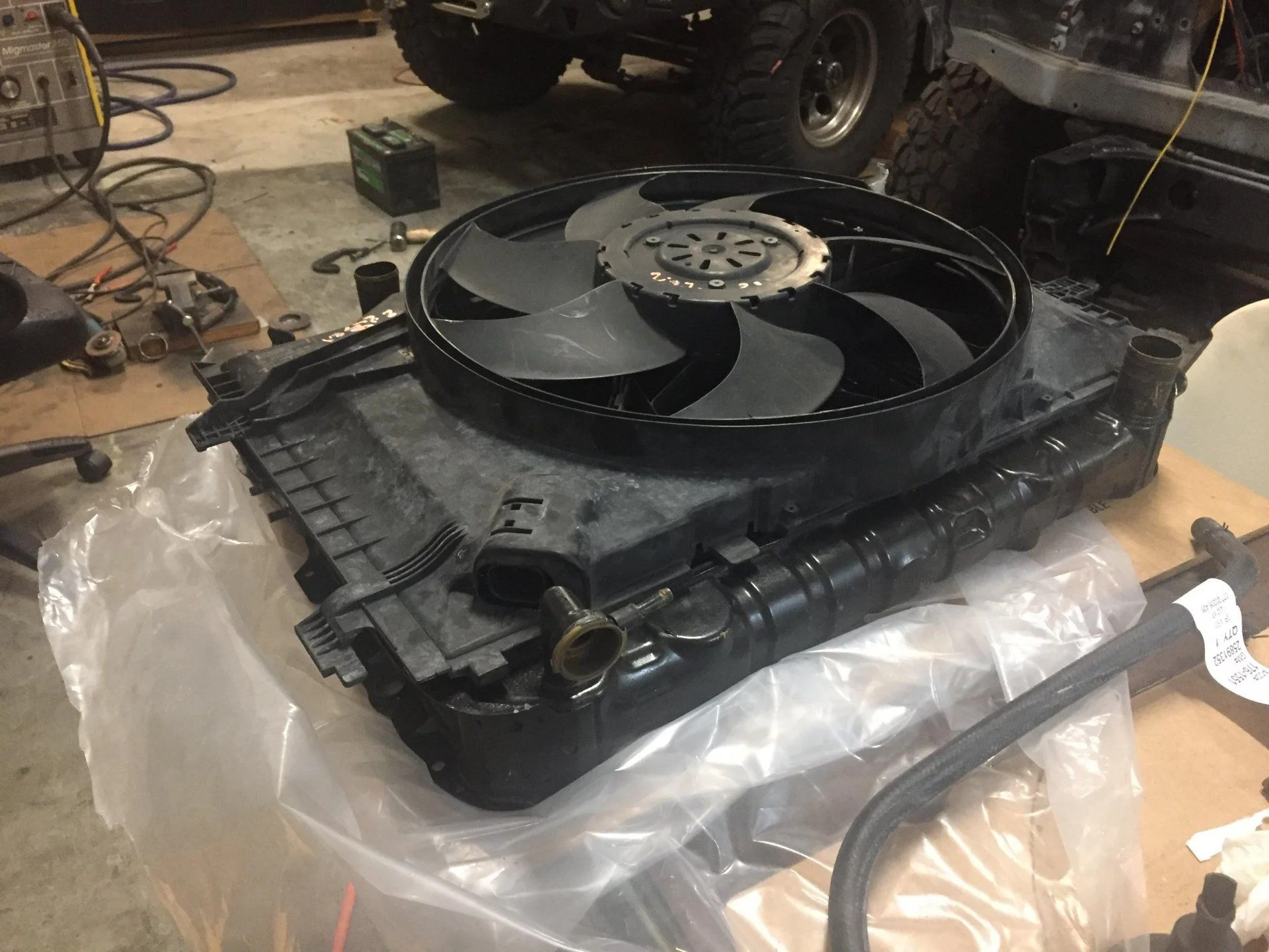

Had a junk 60 rad around so did a quick test fit of the CLK350 fan on it before closing up for the day. Perfect fit! The flat edges down the sides of the shroud overlay perfectly. Should be able to just drill some holes in these and use some bolts, couldn't be easier.

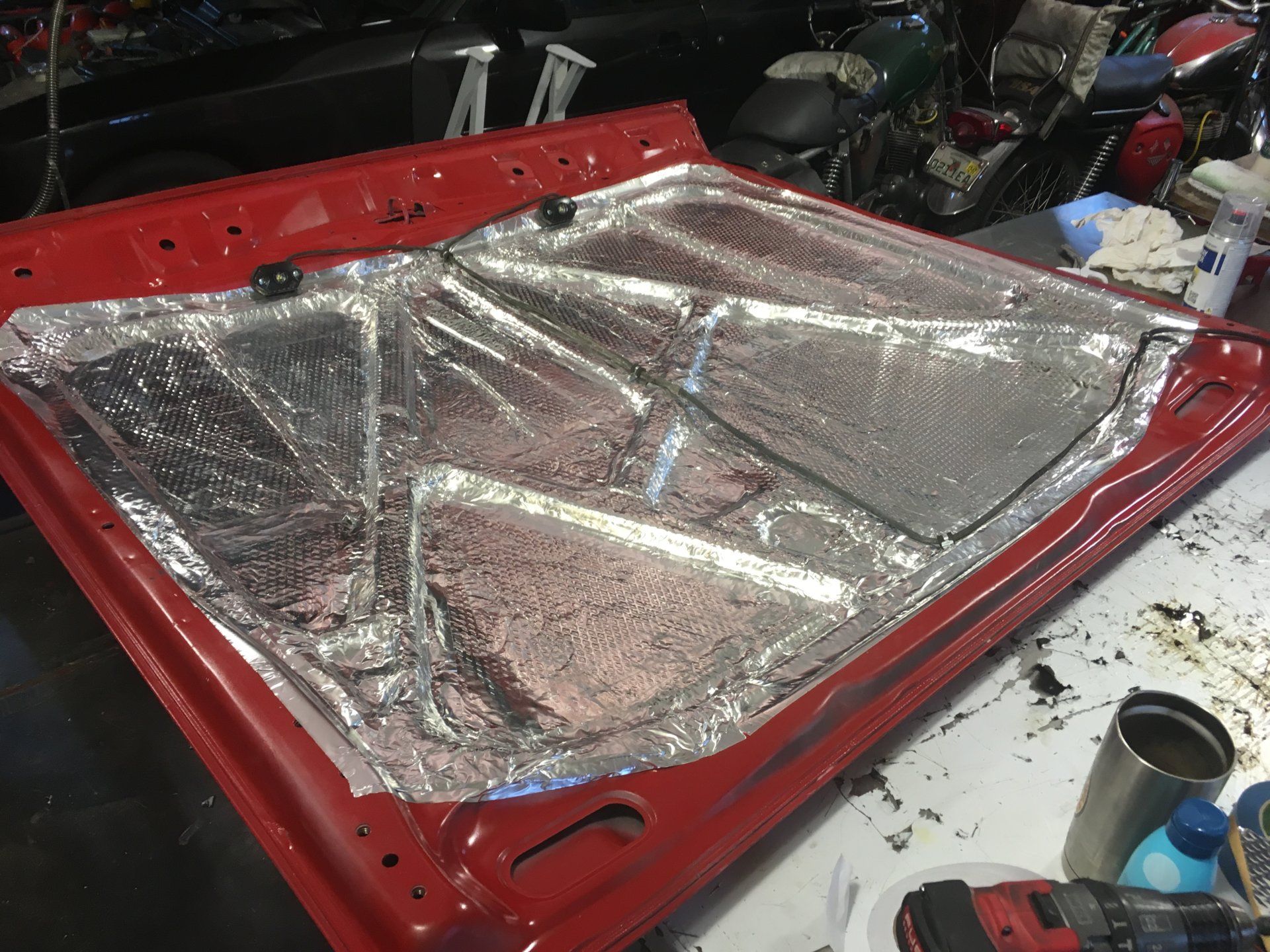

How's the butyl on your hood holding up? Did it have any effect on perceived noise or engine temps?
The first layer is still there, the second layer is peeling off and look terrible. I need to clean it up. As for as temp/noise i think it reduced noise with the windows down. No difference when the windows were up.

That Merc fan is some good info. 50A...she'll do some work. I've been planning on leaving the mechanical fan in mine, but if one of these turns up locally I'll have to give this a try.
I'll keep an eye out to see how those 37s fit up with your axle placement. Mine lightly hit the front fender when stuffed at lock...
Yeah dude. These Euro fans are all crazy powerful.
I should be ready to get it swapped in the next few days or so. I am hoping my cheap PWM controller works out alright.
Our local LKQ is light on Mercs at the moment, but they're pretty flush on BMWs. Know of any of those off hand that do better than others?
Check your PWM driver. The FETs do all the heavy lifting. So long as they aren't some generic black box garbage you're probably going to be OK.
So pretty much everything German afternoon about 2004-5 has a crazy powerful PWM speed-controlled brushless fan. It’s just a matter of picking one that fits. The CLK350 fan was the first I found that fit the 60 rad nicely, I’m sure they are other options.
Gotcha. I'll poke around the yard and see what's up. Camo could benefit from full cooling power at low speed.

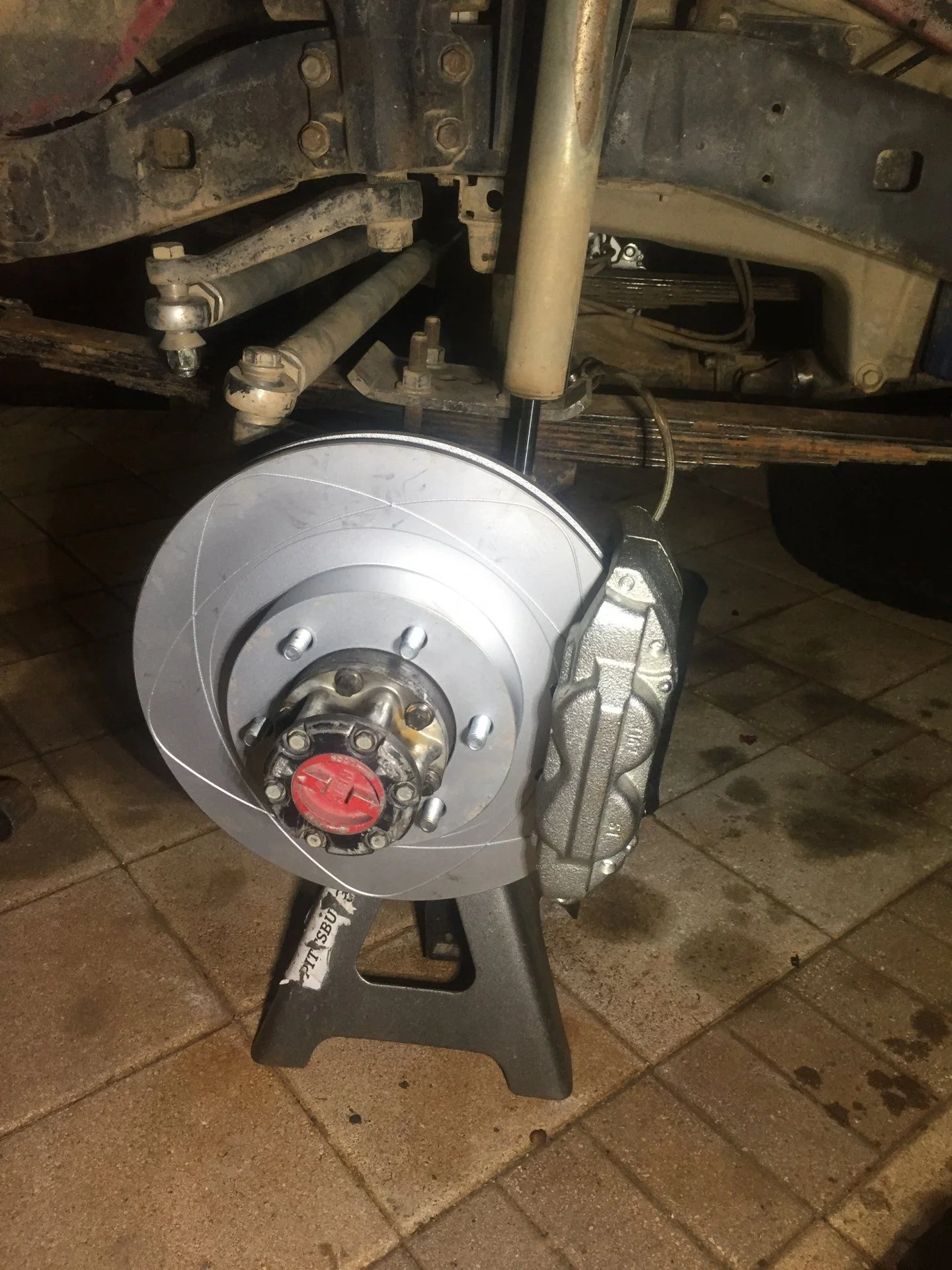

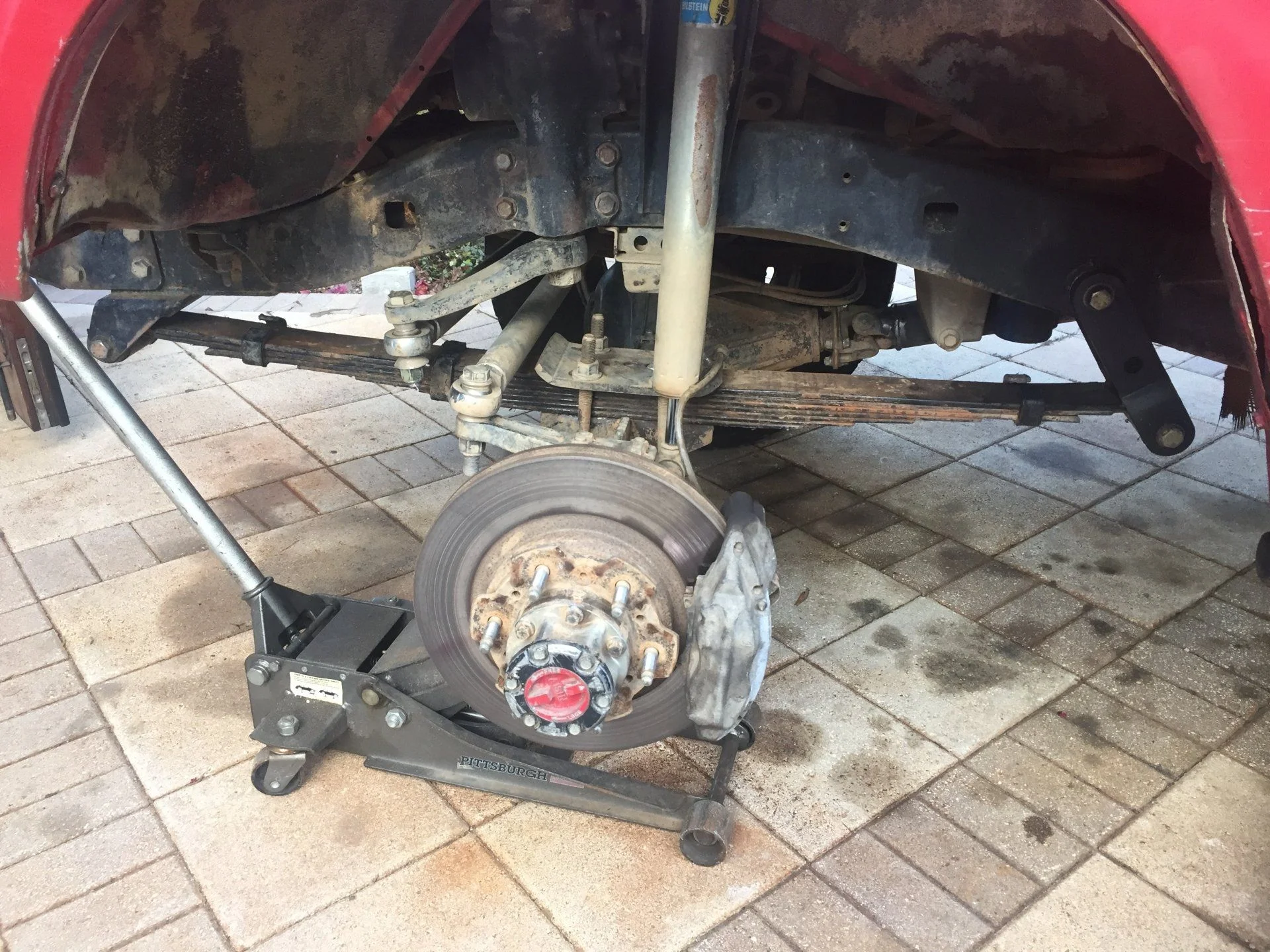

My FZJ80 front brake experiment had resulted in super excessive runout on both front rotors for months and I finally got tired of putting it off, additionally I finally decided to step up to 17” wheels so I went ahead and put the 5th Gen 4runner setup on last week when I had a few free hours. It’s working great and is nice to have smooth brakes again.
I liked the performance of the FZJ80 brakes up front with the hydroboost, something was either up with my machining to make it work or it may have just been the cheap rotors I used. The big downside to that setup was the way I pressed the lugs into the rotor instead of the hub was a terrible mistake which is why I’ve abandoned it.
The nice thing is that my master cylinder (1-3/16” bore) was a bit on the large size for the 80 brakes, so I had a very firm pedal with very little feel, with the 5th Gen brakes being larger it feels much more “correct” now. I like it a lot.
Do the 80’s lugs press through the rotor and hub like the stock 60? Or do they only go through the hub? I ask because I’ve never been able to find replacement lugs long enough from the box stores for the 60 and I’m wondering if the 80 lugs are shorter and they have them listed as compatible with the 60 for some reason...

No. On an 80 the rotor bolts to the back of the hub like a 86-up IFS Truck, 4Runner T100. They use a short lug.
When I put 80 brakes on my 60 I drilled those threaded holes outs and pressed 3” long ARP extended lugs for a Mitsubishi Evo into the rotor. The difference between this and a original 60 setup is that on a 60 the actual knurl grip surface grabs the hub, not the rotor.
The cast iron rotors are too soft to keep a tight knurl grip. In my opinion

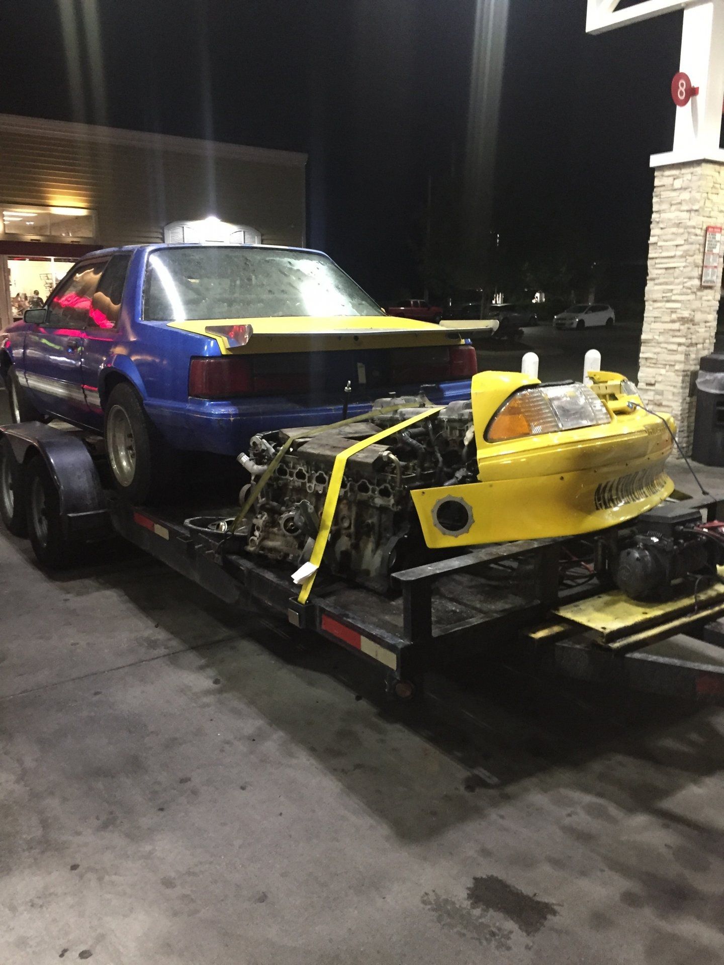

Off topic post more about the 2jz foxbody on your Instagram what you posted was a big tease
Well we need to build it first lol

I assume it'll be boosted? I mean...it HAS to get boosted.
